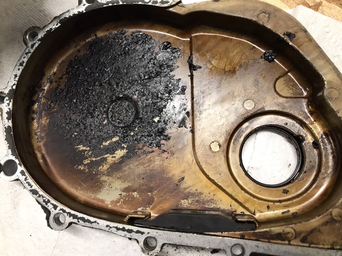

Here’s a pic of the inside of the timing chain cover. Honestly, it doesn’t look too bad and that black guide is still in there...

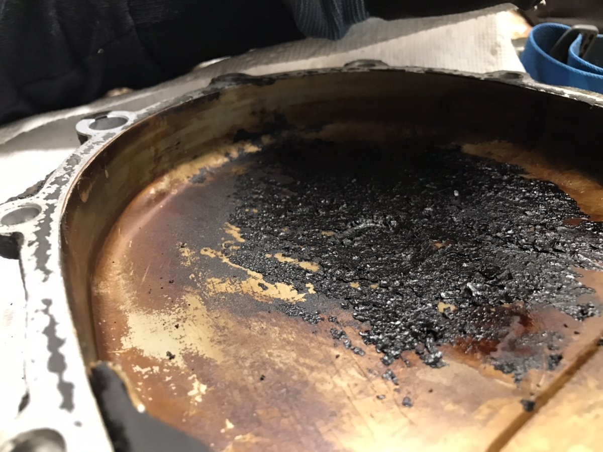

it looks like the chain was scratching a little bit, but not like I expected to see.
It does look like the chain may have been hitting the outside edge of the cover though:
So, not sure what to think there. I am really curious what this cover looked like before the seafoam treatment however. I’ve seen some really nasty ones in some videos so I can’t help but wonder what this one looked like.
I’m going to clean the cover up on Monday and get everything back installed. I spent a few hours scraping the old gasket off the block (no fun...) but it’s super clean now! And then I will tackle the stuff underneath. Still need to check the crank and see if the thrust bearing is bad. If it’s good, then I think I’m going to close things up and move on to the next possible item on the list.
Oh, and no oil slinger installed, is that odd? The FSM mentions one, but it also mentions this really weird chain tensioner with springs and locks instead of the basic black piece of plastic we have. 🤷🏽‍♂️
should I put one in? Or just leave it the way it was?
