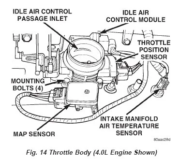

It's hard to say if the makeshift gasket is air tight or not but it certainly could be. I ran for at least a month with a cooling system thermostat gasket cut out of a cardboard box some military rations (MREs) came in without a leak.
I'd be looking to insure the IAC orifice channel is spotlessly clean like using some TB cleaner with something like a baby bottle nipple brush to get inside to scrub it with.
Also know that the IAC plunger moves in & out as required so that you saw a different length is normal. The PCM will figure where it needs to position it. I'd double-check the o-ring which can cause a heap o' problems if it isn't sealing properly.
You can also clean an IAC (that isn't leaking anywhere) without removing it by simply spraying TB cleaner into the TB while the engine is at idle. The IAC will suck the cleaner in through itself when the engine is idling, but not at higher rpms... it only does anything at idle rpms. The engine will flood and die when you spray TB cleaner at its input slot at idle rpms but that's ok, just restart the engine. That also gives the cleaner more time to work, when the engine dies.
Spray the TB cleaner at the 'idle air control passage inlet' slot when the engine is at idle rpms as shown below. I usually use about 1/3 of the can to clean the IAC and then use the rest of the can of TB cleaner to clean the rest of the TB's interior at higher engine rpms.
Jerry, thank you for your response.
My only indication that the gasket is airtight - at least on the outside edges - is the fact that with the old IAC it seemed to work fine and idle at the proper RPMs. I would also assume that the center divider is airtight too, because if it wasn't, it'd probably run higher RPMs. Please note that I haven't disassembled this piece since I put it together (I'm not going there unless I can obtain a real IAC body gasket, or something else seems wrong with it). I also want to note that I put this gasket on dry (no silicone sealant or anything used between the surfaces) - and I did the same on the throttle body gasket as well.
Regarding the cleanliness of the IAC orifice channel - while I can't say I used a baby bottle brush (don't own one - probably should pick one up), I did hose it down with cleaner, and scrub it out with my finger with a cotton shop rag, and made sure there wasn't any lint or anything left behind. That said, my fingers weren't tiny enough to get all the nooks and crannies of the IAC body, but visually the mating surfaces of the orifice and plunger on the old IAC were made spotless and shiny.
Now I want to re-iterate so that you and I are clear here:
1. With the old IAC valve, which I cleaned as spotlessly as I could, my idle was ok - but I had the whistle again for a brief period (a few minutes) this morning. This is what led me to purchasing a new IAC valve, as I had cleaned everything I could yesterday on the throttle body and IAC valve, so I thought maybe the IAC valve was somehow at fault for the whistle.
2. With the new IAC valve, I noticed that before I installed it, the pintle plunger was much shorter than the original - one could say when it was installed, the system was "wide open" - whereas on the old IAC valve, the pintle plunger was so long as to have the system completely shut off, minus a hair or two (maybe a millimeter or so).
3. I currently have the new IAC valve installed, and after my long drive (50+ miles), my idle under load was around 1100 rpm. I have not re-installed the old IAC valve yet; but in the process of deciding whether to re-install it or not, when I had the system back apart, I noticed the new IAC valve plunger had moved out more compared to before I installed it, but it still wasn't as long as the old valve plunger length - and could still be considered "wide open" (the difference was about 1/4 to 1/3 of an inch).
So when you say to spray the cleaner in the oriface at idle (and I am not trying to be contrary or argue with you here - I am just needing some clarification), are you saying with the IAC valve I have currently installed (the new one, with an idle of 1100 rpm), or should I re-install the old one and run the cleaner thru with that?
Again, please note that neither one of these valves looks dirty, nor does the seat in the orifice look dirty, as I had cleaned both yesterday quite thoroughly, with the exception I have already noted about the IAC orifice body. However, I'll concede that maybe running the cleaner thru the orifice might help matters. But again, my question about which IAC I should use is necessary.
Would it be better if I returned back to using the original IAC (and return the new one for a refund)? Or should I try a new o-ring on the new IAC? Or should I return the new IAC and try to exchange it out (until I get lucky)?
I should also note that it isn't likely that this cleaning (or anything else on this matter) will be able to happen tonight, or potentially any time this coming week, due to other matters that take priority for now, which I won't get into. But I do value your suggestions. If you believe that further discussion needs to wait until I can return to the matter, please let me know. Also let me know if you believe running with the new IAC and the higher rpms is a bad thing; if so, then I will take the time to return back to the original IAC.
Thank you again.
