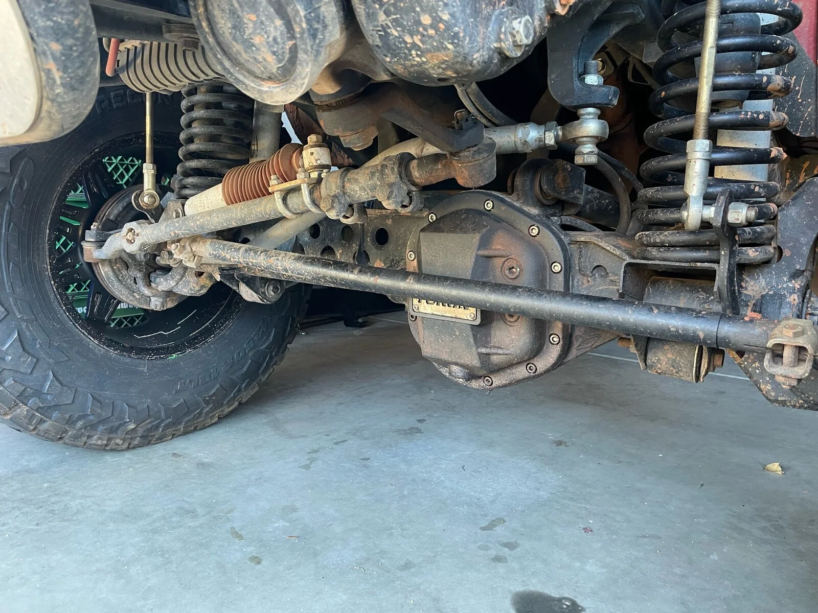

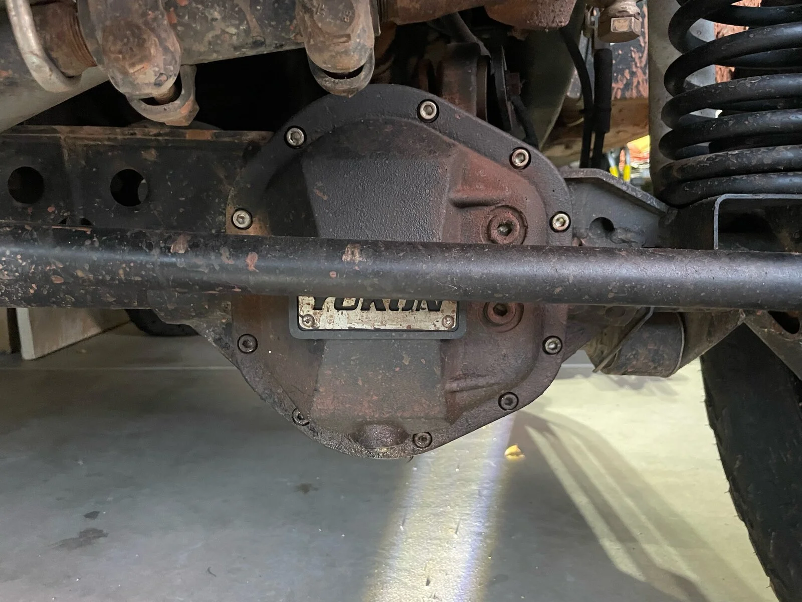

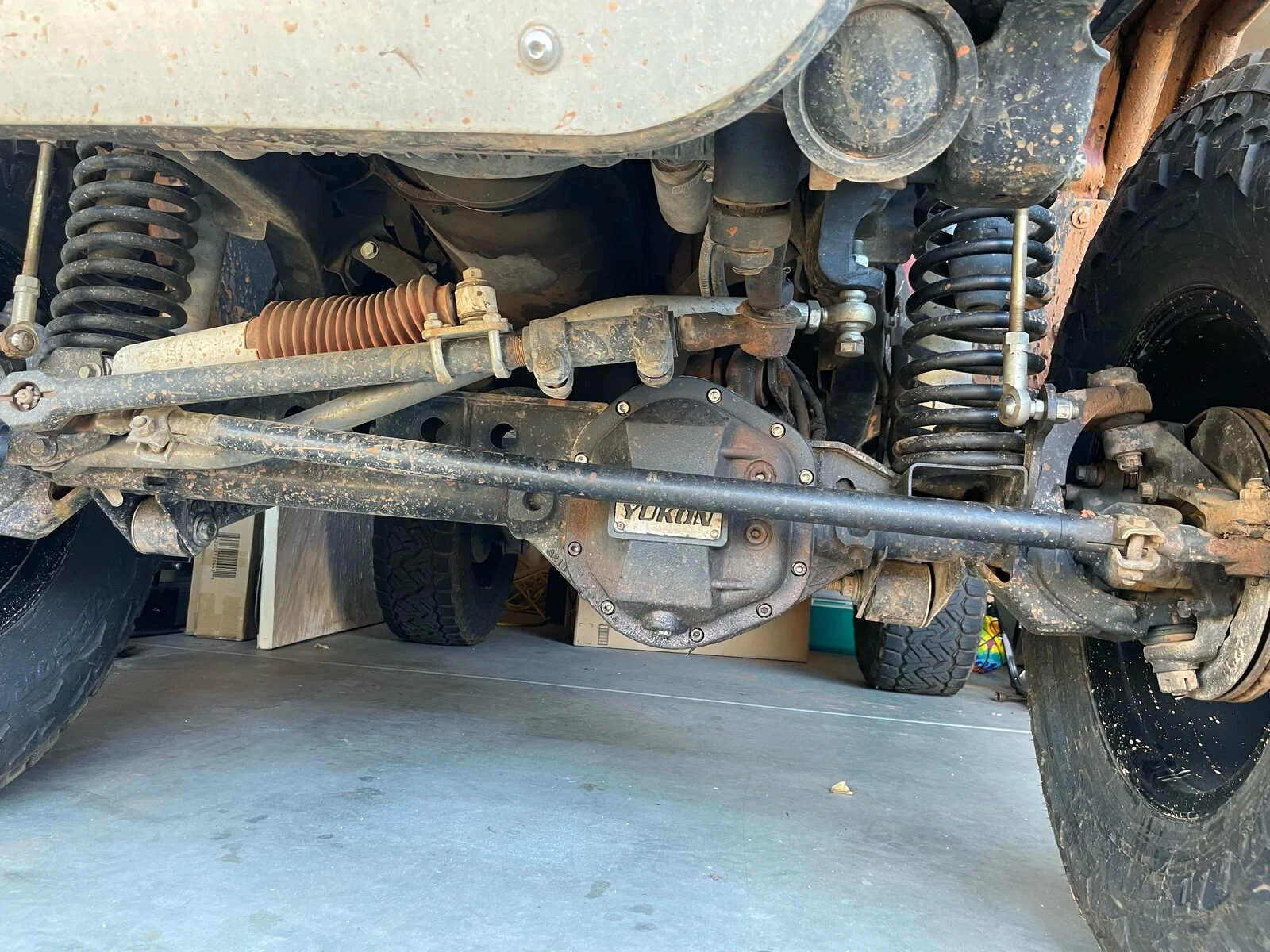

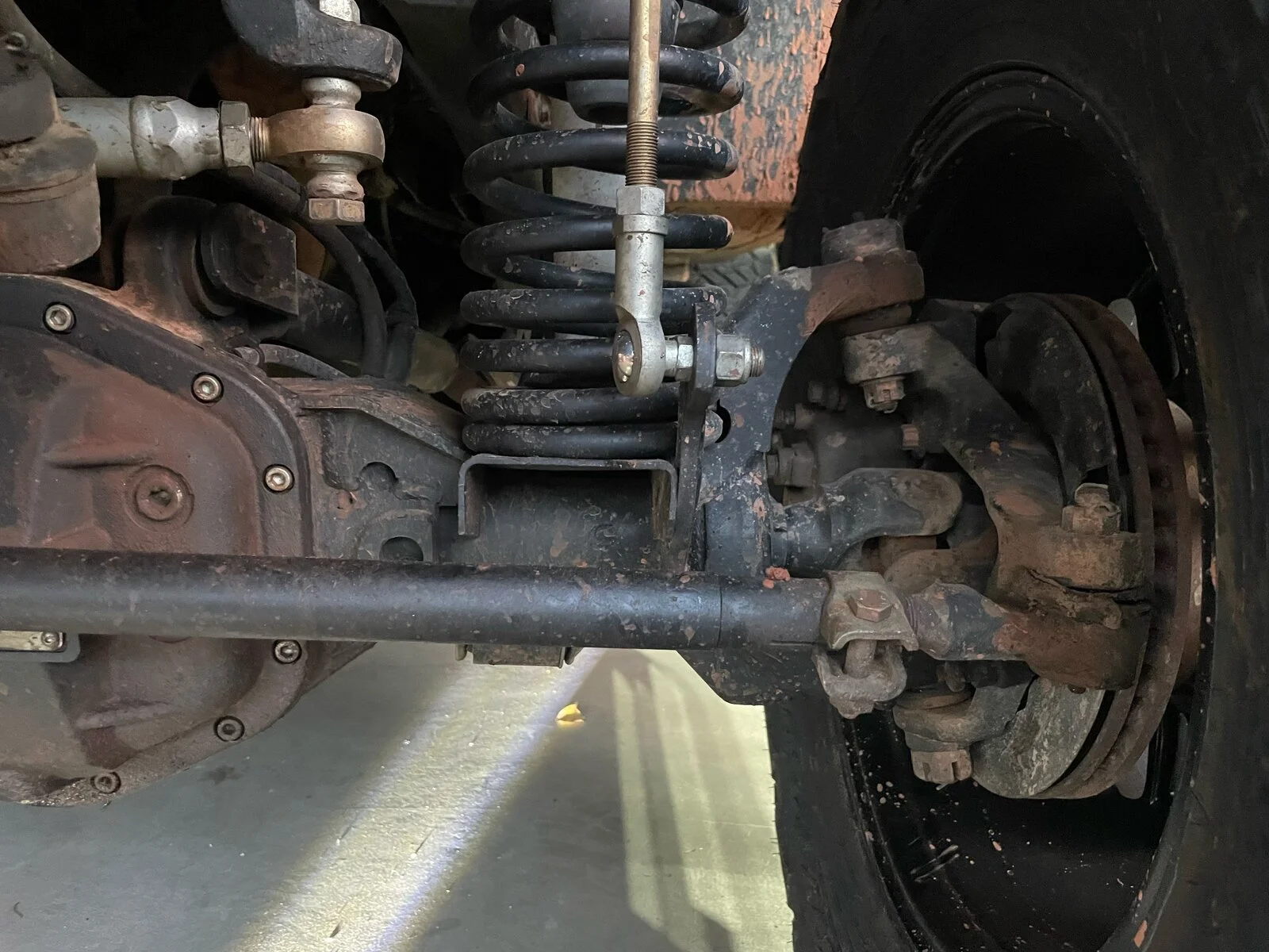

I purchased a1999 TJ with swapped axles. The rear I was told is a ford 8.8 from an 01 explorer. The front is a dana 44 from "a TJ Rubicon" however my research seems to indicate that TJ rubicons only came with dana 44s in the rear. the local O'reillys said they don't have anything in their system for a dana 44 front prior to some year way after the TJs. My real issue is this, my dirver side wheel bearing needs to be replaced but I don't know what part I need. O'reilly's said it can't be a dana 44. However the diff cover looks like the examples on line of dana 44s... ofcourse other axles could look similar.
Further, Google tells me that Dana 44 should be stamped on a support fin, but it isn't. Google also says the long side axle tube should have a number stamped in it that will tell me where it originally came from, but it doesn't (unless it is on top under the welded on truss). The only number I see is 54213. I found an old thread about a diff that looks a lot like mine, https://www.jeepforum.com/threads/can-you-id-this-front-axle.1447014/ and they say it is from a ruibcon but it isn't clear if it is a TJ rubicon or a later Rubicon? Given there is nothing stamped on my axle tubes, would that indicate it is from an aftermarket manufactHourer?
Does any of this even matter? Can I just ask for a bearing, and everything else I need for a later model rubicon with a dana 44? O'reilly's just wasn't any help.

Like others posted
1. The 2003-2006 Runicons came when Dana 44 front and rear axles with disc front and rear brakes and air lockers 4.10 gears.
2. LJ’s came with a 44 rear, I have heard 44 front, but I don’t know that personally.
EITHER way, the Dana 30 and Dana 44 front TJ both use the same outside the pumpkin.
The Dana 30 calipers, same as TJ 44. The knuckle, all the same.

The Jeep also has Currie/RockJock steering, maybe links from an Antirock, a front truss for some reason, and what might be a Rubicon Express track bar.

Is there an electrical connector hanging out of the drivers side of the diff or plug? If so it definitely came out of a rubicon there will also be a fitting for a small air line up high on that side or a plug.it looks visible in one of your pics

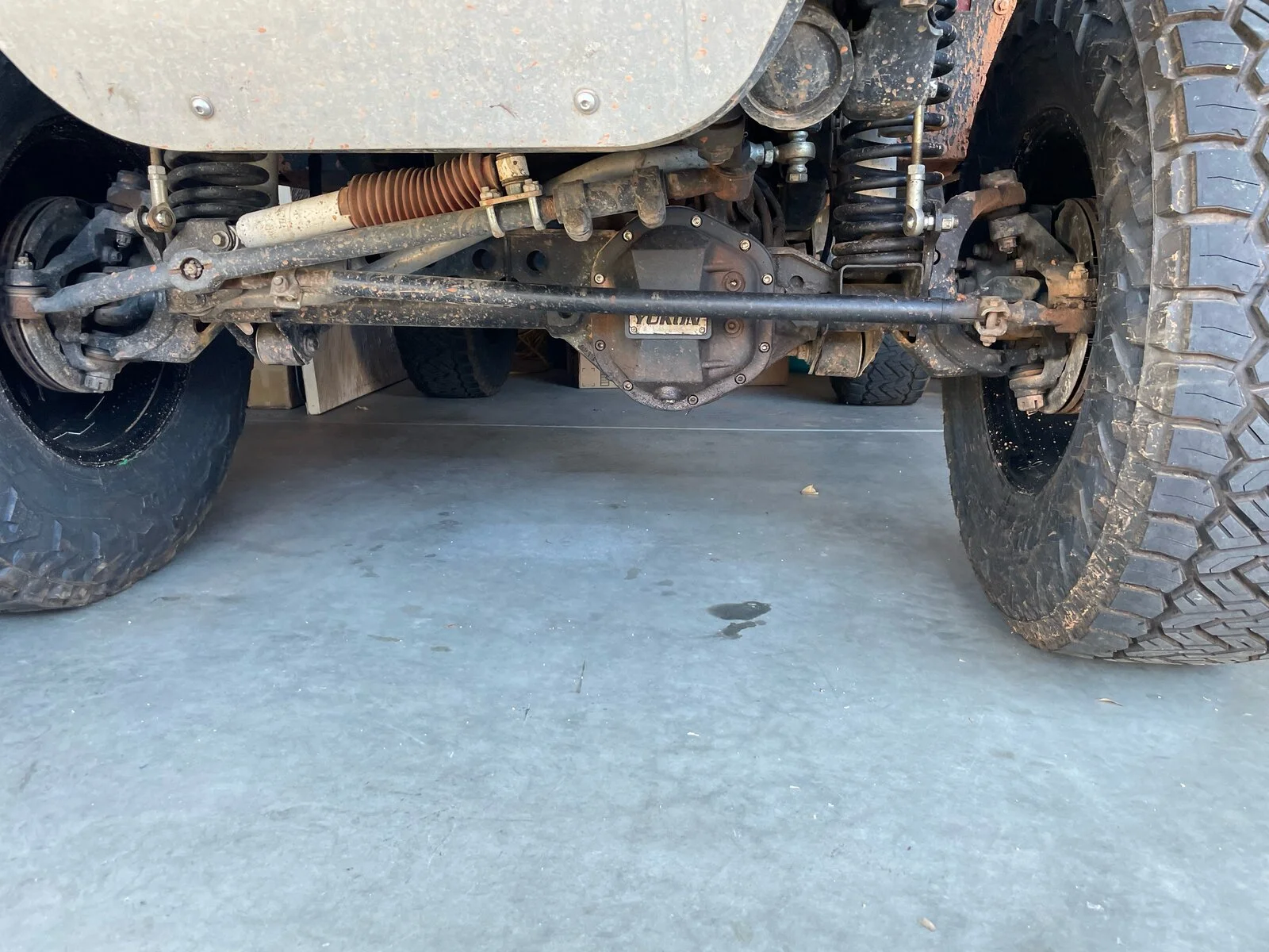

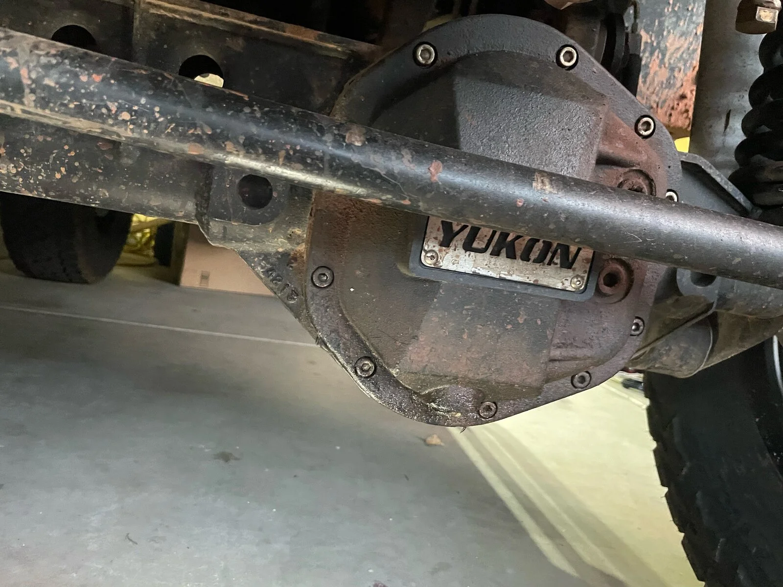

Thank you all for the info! @jjvw, it does indeed have an antirock but I was unaware that the steering had been modified. How would I determine if it is a rubicon express track bar? I am attaching some additional pictures. For years I modified Mustangs. I just gotten into off road about 2 years ago. I am still learning about what I actually have.
Doesn't matter too much if it is Rubicon Express, Metalcloak or similar. It uses a sideways heim joint at the frame which will wear out quickly at the bearing surfaces with use. Some of these similar track bars have a long history of breaking along the tube.

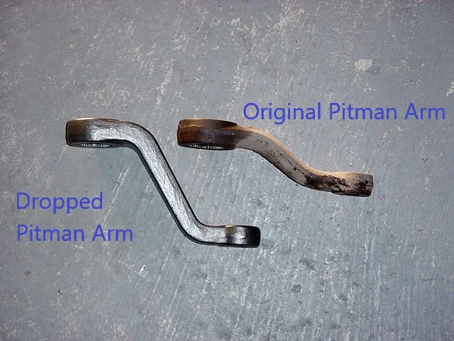

Not knowing any better, someone installed a dropped Pitman onto your TJ which is commonly but usually erroneously done. Yours should not have one due to your steering not having been modified in such a way as to require one. Installing a dropped Pitman arm screws up the steering geometry which causes bump steer. Bump steer is when the steering is forced (bumped) left/right when driving over bumps/dips on the road.
I'd replace it with the original non-dropped Pitman arm and enjoy the new bump-steer free steering. And yes it definitely appears you have a Rubicon Express track bar installed.
