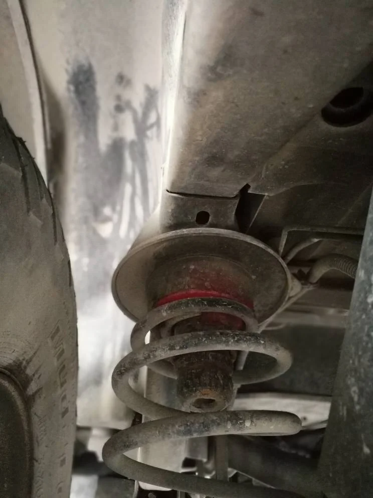

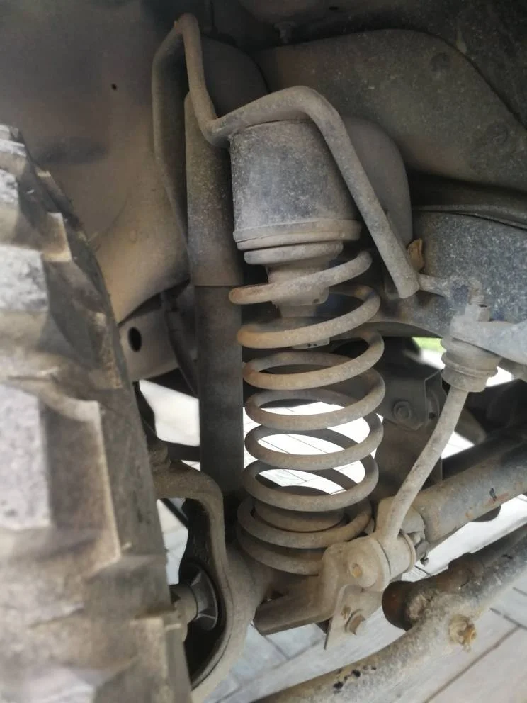

2002 TJ 4.0 sport
It was the previous owner who installed the spacers.
But my question is can we use the same shoks (for example stock one) for 2 different coil lift sizes (in my car 3" in front and 1,5 " rear with the same stock shoks)...?
Can that dommage the shoks or the spring...?
