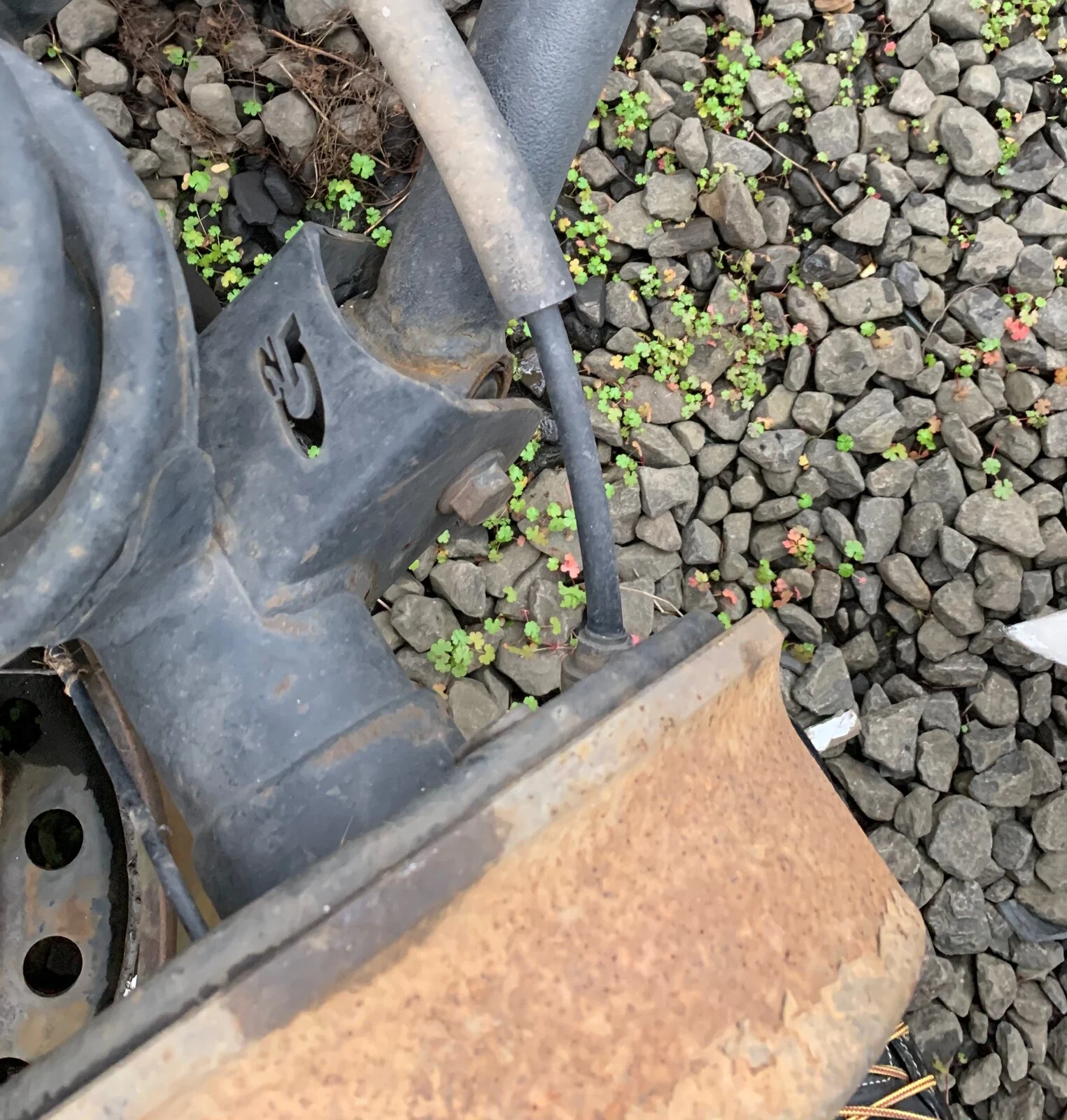

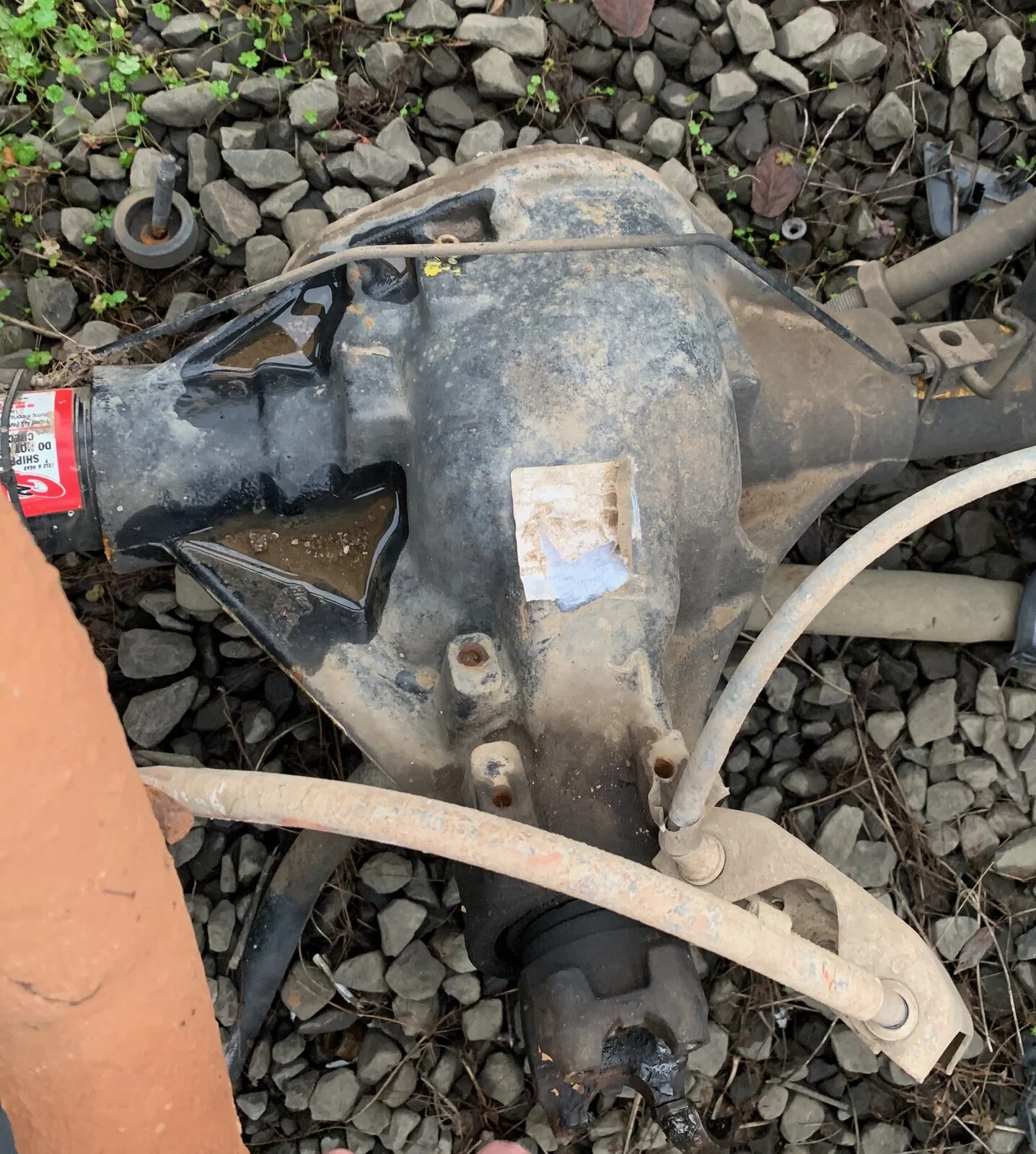

G2 manufactured axle housing from a TJ part out. The cover looks like a Dana 44 but to me it doesn't look like a Dana 44 from above, am I wrong? Can anyone help me identify this housing? Did G2 make a version of the Dana 35 at any point? Owner isn't sure what it is. Thanks in advance!

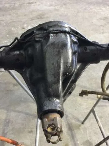

That's what I figured when I first looked but then I was a thrown off by the overall shape, which is different from what I would expect (see below). I'd be curious if anyone knows what's behind the difference.

They changed the casting a bit, adding more webbing which has a purpose, more strength.

There are variations in the Dana 44. The newer JK/JL Jeep 44’s are much better than the weaker TJ/LJ Dana 44’s with Dana 30 parts.

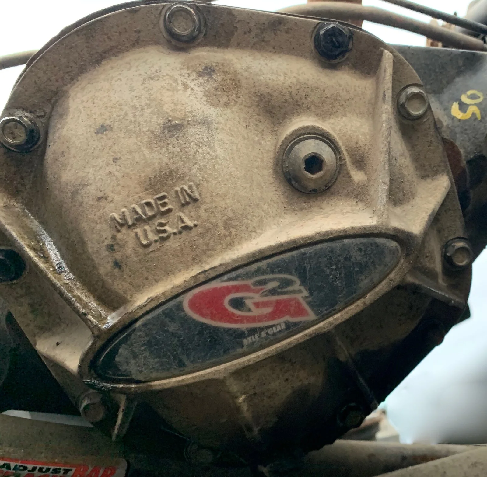

Any Dana diamonds cast into the casting anywhere or do you know for fact that it’s a G2 axle housing?
If the whole axle is built by G2simply cast their own version of what they thought was a stronger Dana 44. I’m not sure if they use the small Dana 44 gears or the 8.9” gear sets in the G2 center casting. Best to call G2 with those questions, if I had to speculate, I’d say the G2 stuff uses the bigger gear sets and lockers identical to what the JK and JL uses. Call G2 and find out.

The rear does appear to be a G2 housing while the front has the Dana diamonds. That clarifies things quite a bit with regard to what I'm looking at and where to focus my investigation. Thanks for your feedback and advice--I'll definitely give G2 a call and see if I can get some specs/documentation.
