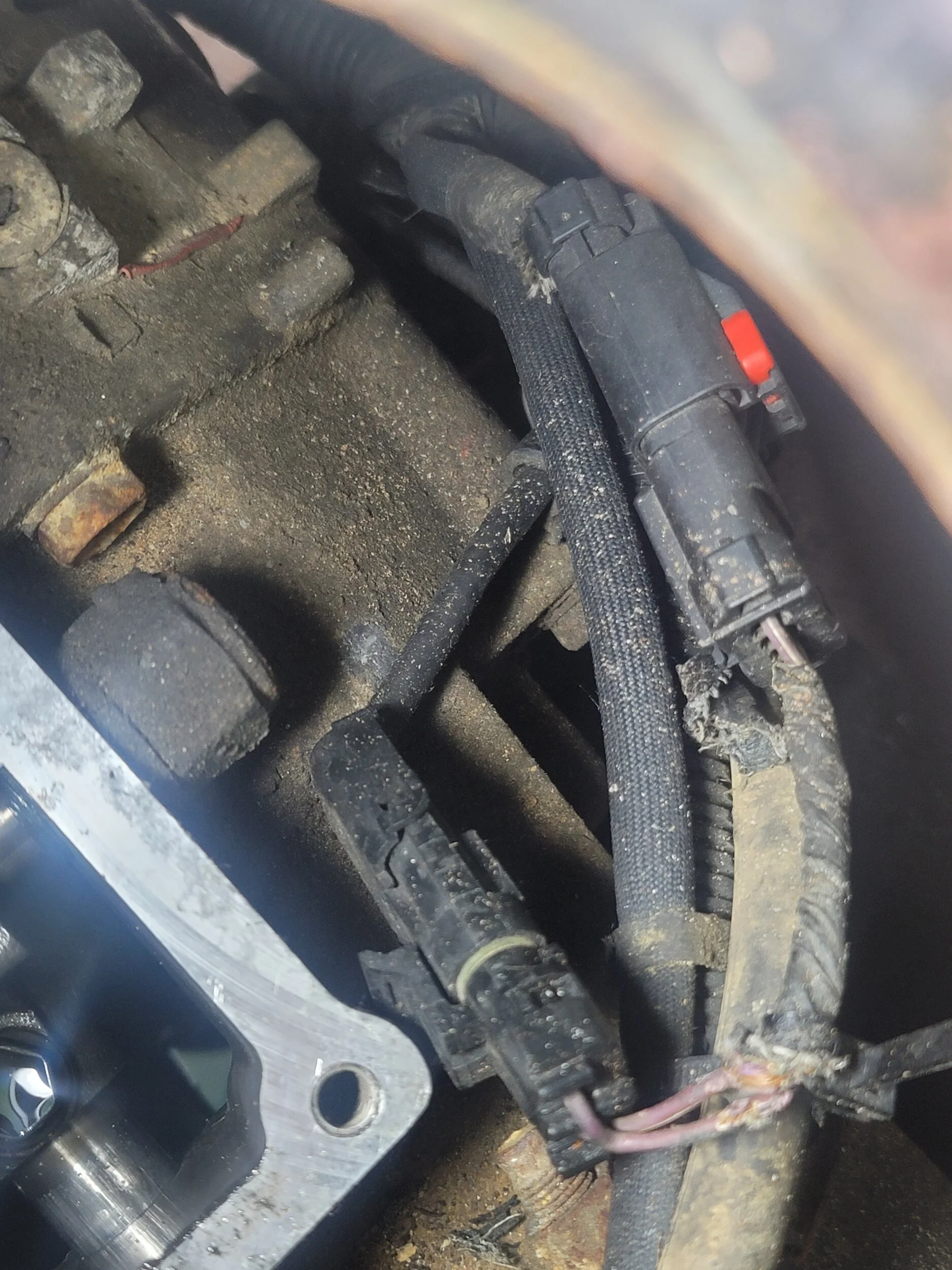

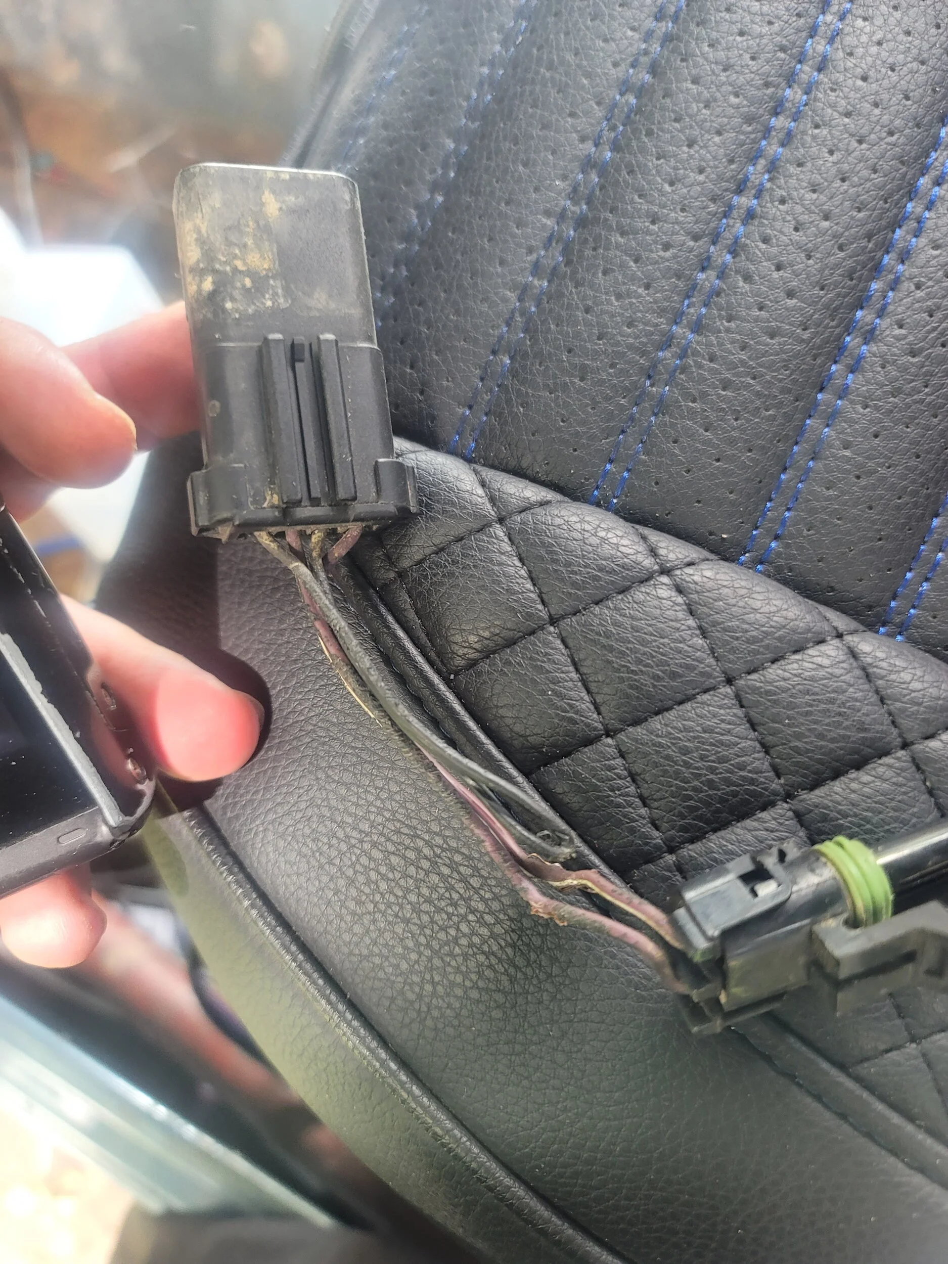

Just removed my shifter starting a clutch replacement and I noticed there's this wiring harness and the wires on it looked chewed through. Can someone tell me what these wires are these harnesses go to?
99 TJ 4.0 Manual
Manual transmission jumper harness, as stated above that is the backup light circuit and the starter relay ground circuit is looped because it isn't going to a NSS like it would with an automatic.
I'll defer to yall but I would've wagered a decent amount that this was the 4WD indicator plug.
