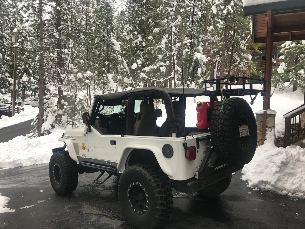

So I am considering getting rid of my HEAVY Rock Hard 4x4 rear bumper and tire carrier it has worked well and taken a lot of beatings on the rocks of The Rubicon Trail. I am looking at the Savvy rear bumper and getting the Genright swing out carrier My current set up is made up of the following.
Rock Hard 4x4 Bumper 110 lbs
Rock Hard Basket 40 lbs
Rigid Back-up lights guess 3 lbs
2 Rotopax gas containers 12 lbs
Rotopax Mounts and locks guess 4 lbs.
5 gallons gas 30 lbs
Total 200 lbs. with the rack empty.

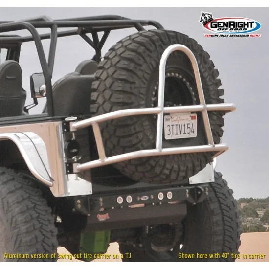

Genright Swing Out Tire Carrier 25 lbs $1,200.00
plus requires new tail lights Genright lights $199.00

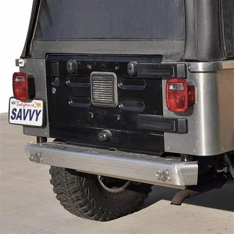

Savvy Bumper 30 lbs. $479.00

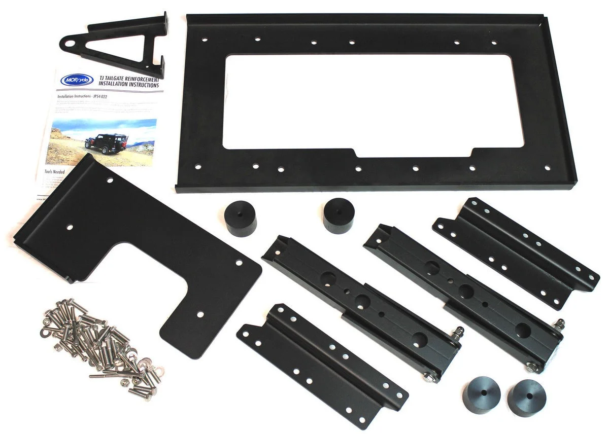

The Morryde HD Tailgate hinge and tire carrier kit ?? $312.00

I would like to keep the Rigid lights and the Rotopax and find some way of mounting them. By keeping them I would still be removing about 100 lbs. Is it worth the work and the expense to remove the 100 lbs of weight. And do you have any experience with any of these products if so I would like to get your reviews.. I do want to keep a full width rear bumper.

The issue I see with the GenRight and similar cage designs is they they are always as large as the cage. With the ExoGate and some work, you can pull the spare tight into the body and the resulting overhang is only as bulky as the tire itself.
If I remember right the Exogate does not have the tie in to the roll bar mount that the Morryde has and that looks like it may add some extra support

It wouldn't be to me. I like my Genright stuff but there is no way I'd pay $1200 for a tire carrier.
As far as I know, both have the same tie in. They are the same product except for some difference in the amount of hinge swing.
Yup they both tie in

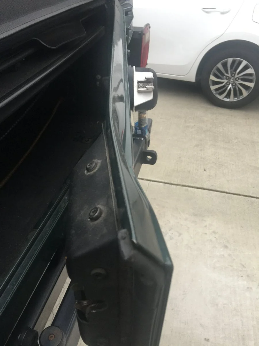

I love my exogate but after a year have a big crack in my tailgate. I'm sure it is 100% my fault. I bet I backed into a tree or rock at some point. But on a traditional carrier, I do wonder if I would have gotten away with less damage..
Just a warning but I still do like mine and think I'd recommend it.

Having had the MORryde tire carrier, I really, really love the way it's built and the way it functions.
Do you know if having Alum.Corners makes a difference or not installing the MORryde kit ?
Just eliminate the big backing plate around the taillight. Or add a tailgate skin. One or the other.
I just installed the MORryde last weekend and I made two 3/16" backing plates of aluminium to match up the thickness of my Poison Spyder corner gaurds. Two more shimes made out of 1/4" steel to go between the hinge and the tailgate bracket, worked out good.

Where did you see the MORryde for $312? I’m looking to go that route. I had a traditional swing away tire carrier that I ingeniously engineered to be rattle free by clamping to the tailgate snubber. No rattles but that single contact point transferred the full force of an impact to the tailgate!
Carrier was bent as well and had some welds crack. Thinking the MORryde would distribute the force better.
As was said, it's a plus to have aluminum corners. Here's one I did with Savvy corner armor. It also has armor on the tailgate, as well as the panel below the tailgate.
