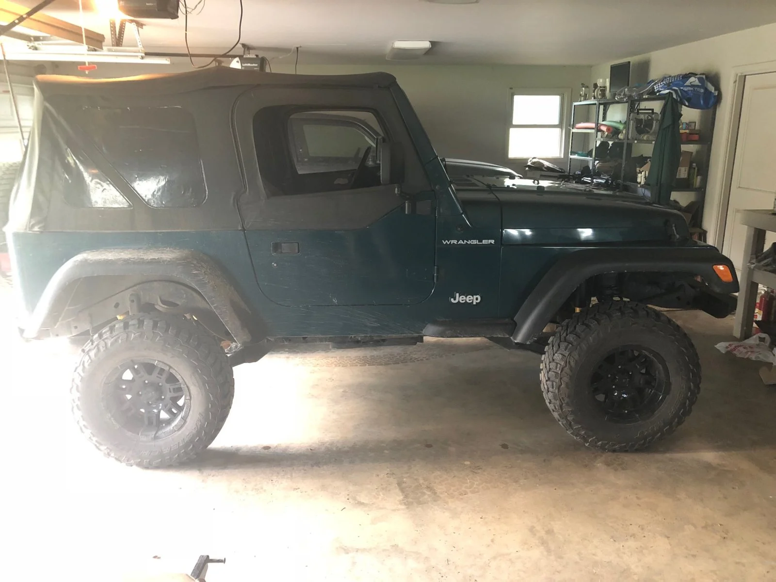

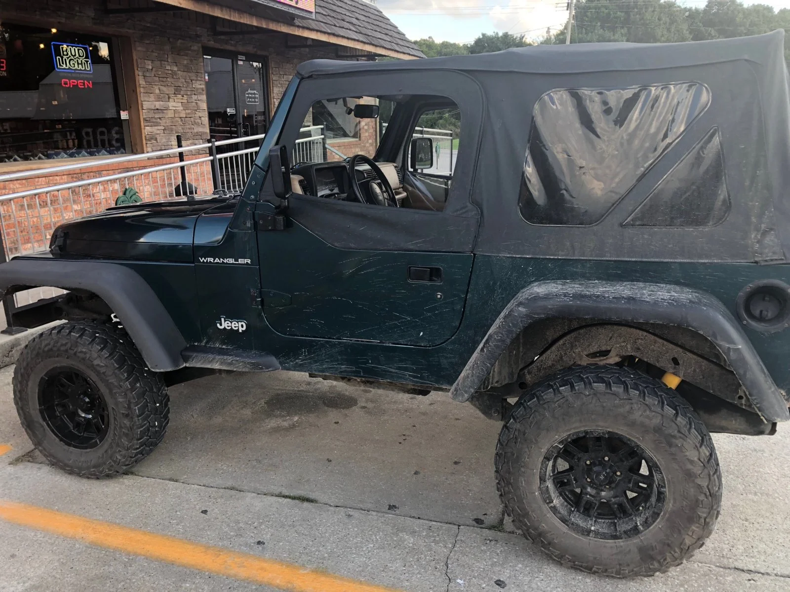

Need help figuring out what size tire to go with. I want to stick to AT since this is a daily driver and also don't want to go too big since I only have the 2.5 and don't want to completely murder my MPG.
Just installed 2" OME lift and I feel like my jeep is an adult wearing little kids shoes right now. They just look small when I look at them from the side.
My current size is 31x10.5R15.

With the 2.5 4 cylinder I wouldn't go above 33, but probably not even above 32 to be honest. You'll want to re-gear either way.
Are you sure that's a 2" OME lift? That looks like a lot more than 2" of lift. With the way it looks now, you'd need 33s to fill it out.
That's what I thought too! I just did it on Saturday so it hasn't settled any, but even my wife said "it looks like a foot higher". haha
