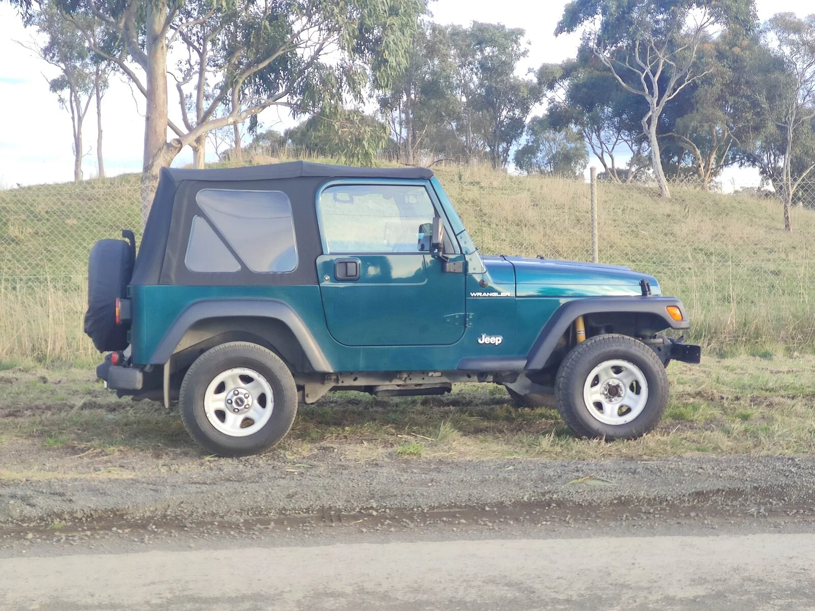

Here's how it looks with the 2inch lift and with the current 225/75/r15 tyres. My only concern is would 31s still look small?
Go with 31s. It should be close to 2” larger than your current setup and they will look just fine. Especially running factory steelies
Whatever you do get those God-awful things off of there asap, every time I see a TJ with those horrid factory sized tires I cringe & wonder what the hell Chrysler was thinking back then. Save a penny, I know, but Christ they mighta coulda sold a bunch more TJs over the course of their run had they made them more visually attractive right out of the gate & we’d all be slightly better off in 2021 with more available rigs in the market.
