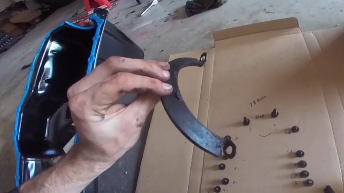

Hello guys I have 2002 tj with 4.0 so I’ve looked all over forum and. Online and can’t find this seal or part number it looks like it bolts on the rear outside of the engine oil pan anyone know part number it’s the seal guy is holding

That's the oil pan support. IIRC, it does not act as a seal. That looks to be in decent shape so just reuse it.
