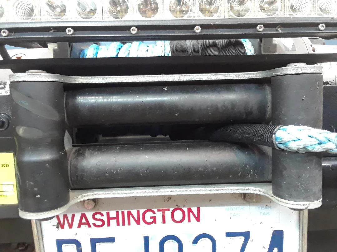

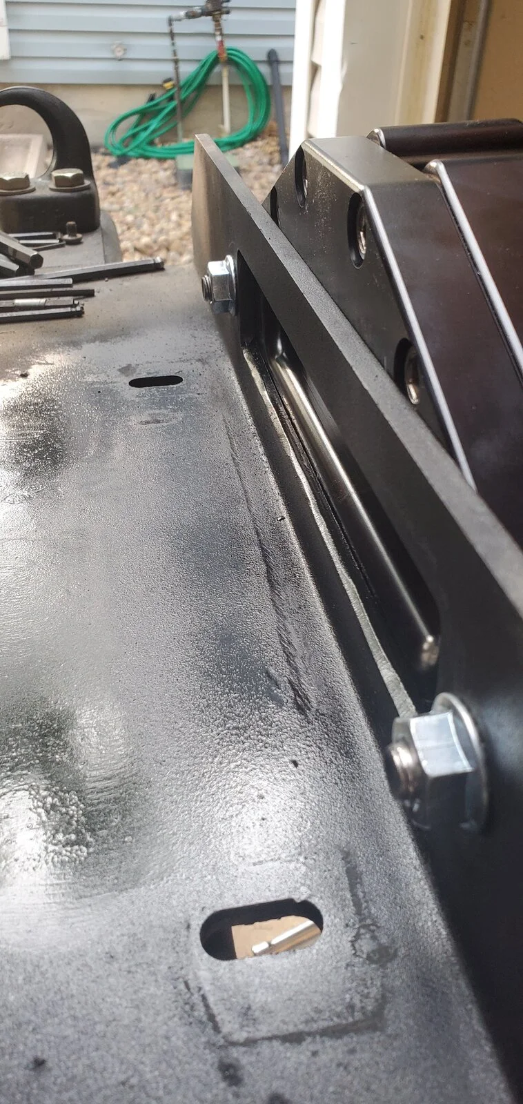

I've got a Warn M-8000 winch on my Jeep. I switched out the steel cable when it kinked for a synthetic line. I changed out the metal rollers on the fairlead for some Daystar non-metal replacement rollers. I'm not trusting them. I've since read poor reviews, and you can see in the picture where the line rubbed and caused an indent on one of the side rollers. Time for them to go.

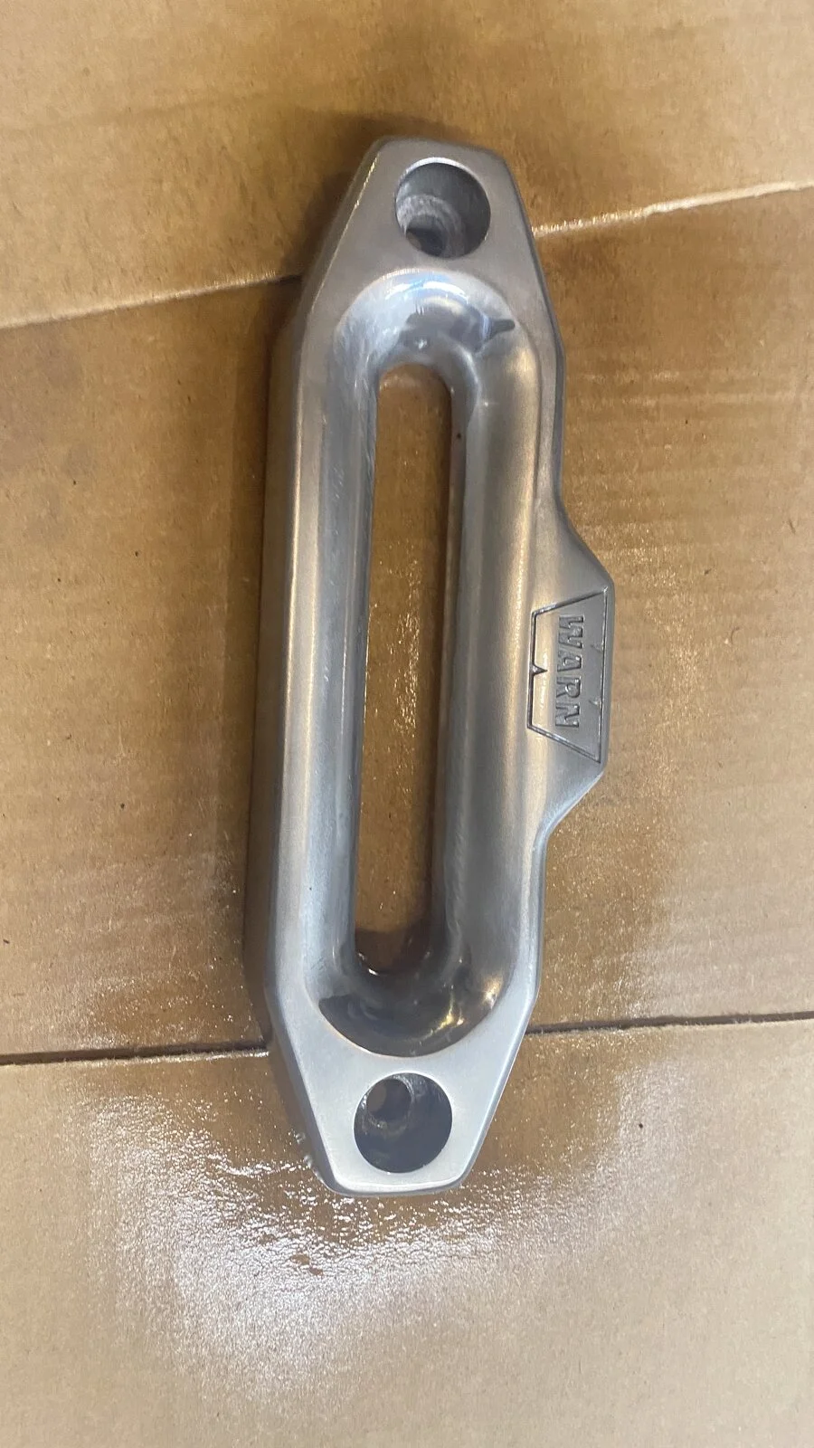

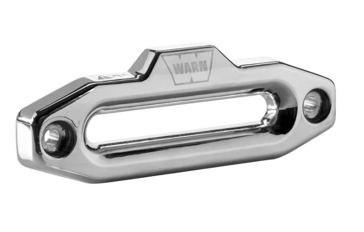

1. Warn 1" Premium Series Polished Hawse Fairlead ($70.00)

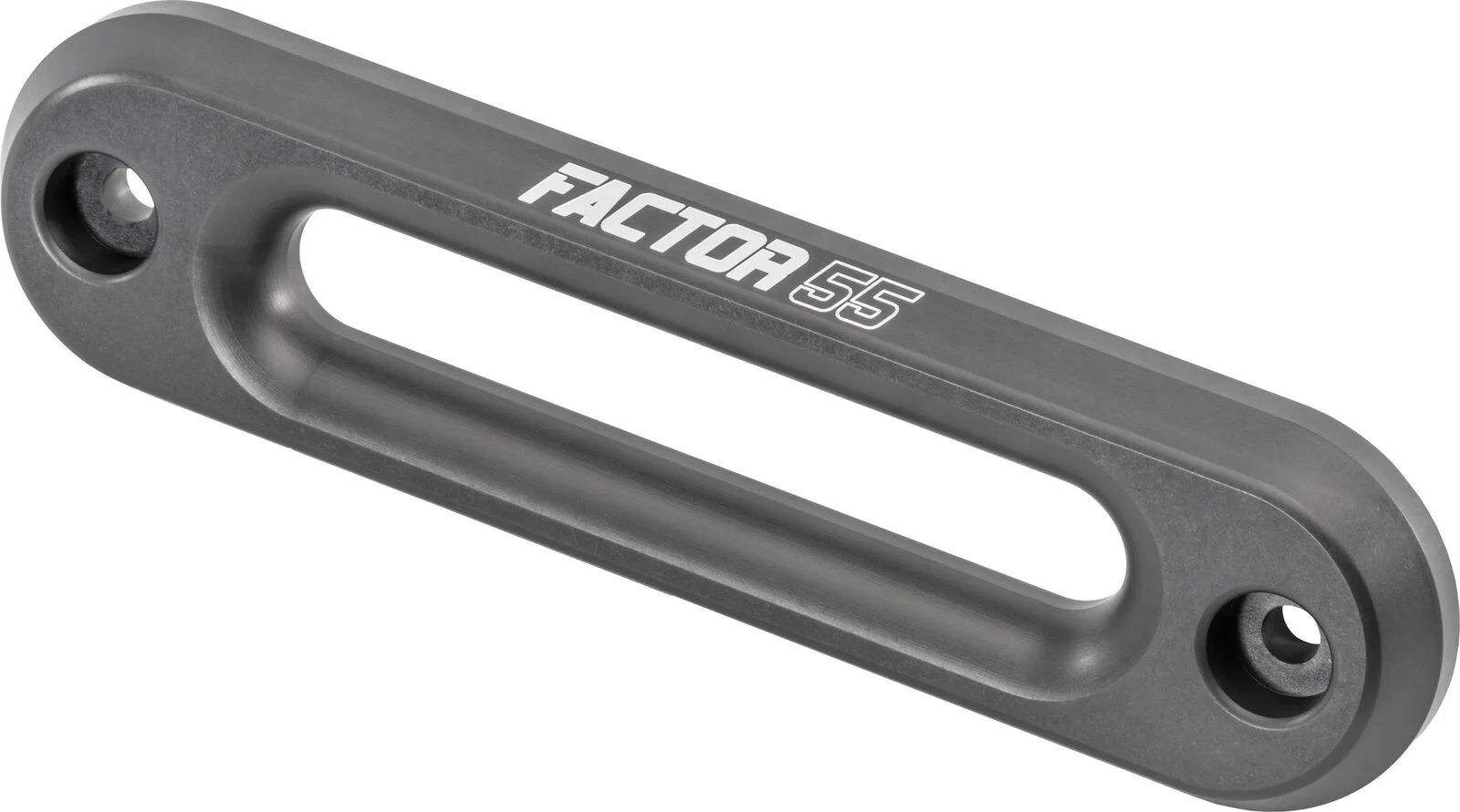

2. Factor 55 Hawse Fairlead in Gunmetal ($72.00)
So the price difference is negligible between the two. Has anyone had issue with the anodized surface on the Factor 55 coming off with use? Anyone having issues with the Warn Premium one? I'm looking for real-world experience here, not brand fanboys.

NashvilleTJ
I miss the snow...
Sep 3, 2020
3,569
Nashville

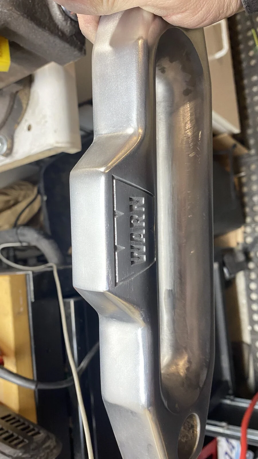

I run the stock Warn hawse fairlead that came with my Zeon 10-S. I don’t know if that is the “premium” version, but I don’t know why it would be different as the Zeon was their premium winch at the time. It is 1.25” thick.
Never an issues with it, and the finish is still good after many years. But most importantly, no nicks or blemishes to catch the synthetic line.

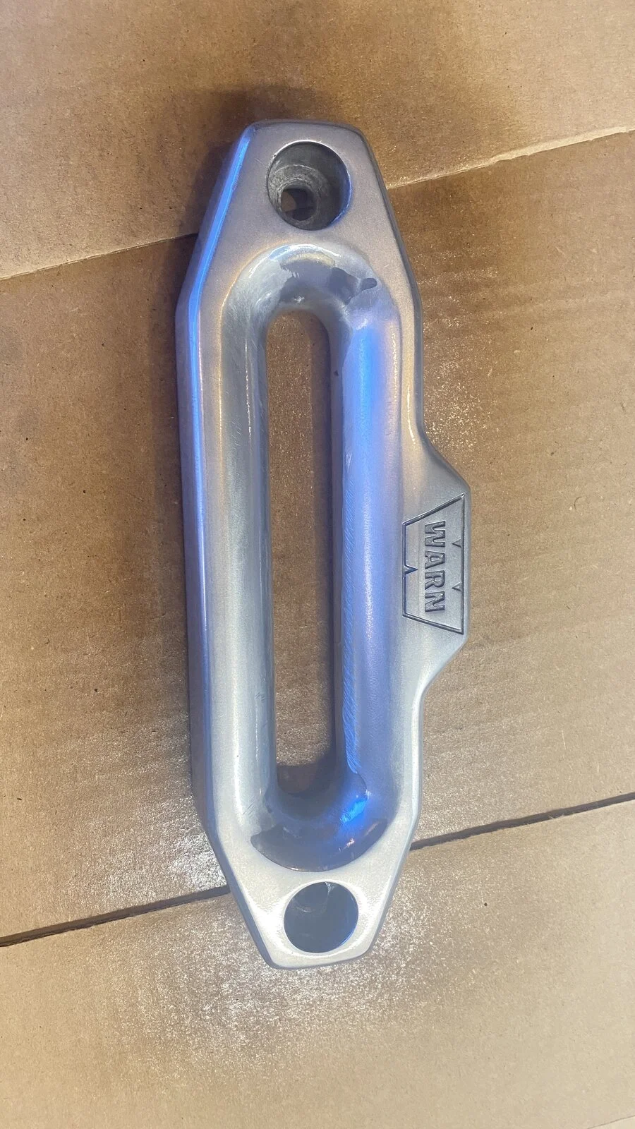

JMT
The Jeep Guy
Feb 27, 2017
17,708
I believe there is a clearcoat on the Warn unless there are two different versions.
I sanded one down due to corrosion and it was thick. Had to use a flap disk. Then smoothed it by going down to 0000 steel wool. The painted 1K gloss clear
Reactions: NashvilleTJ

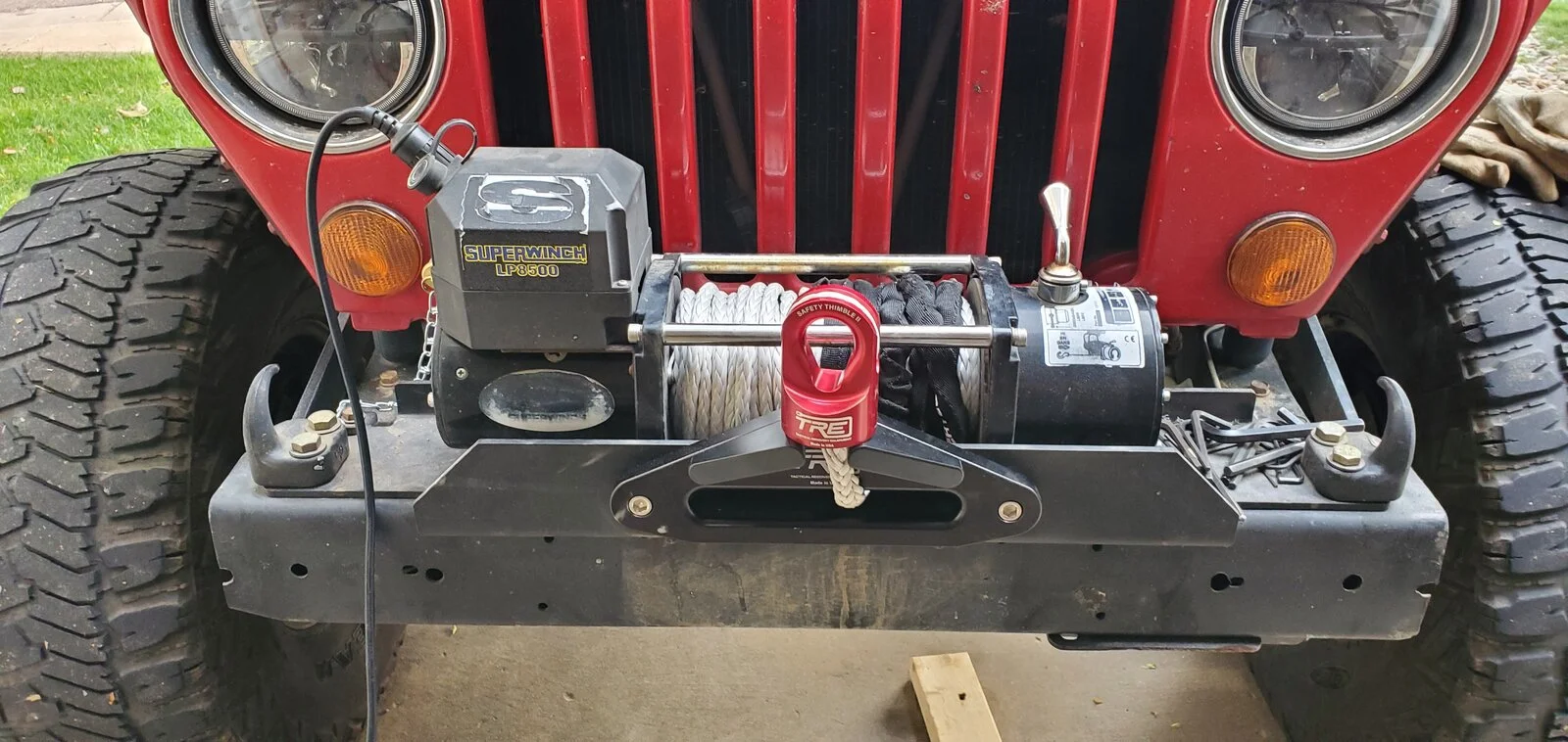

tworley
4340 Currie Club
May 23, 2018
6,726
Arvada, CO
I ran a SuperWinch fairlead that looked generic to me. Never had a problem.
My SuperWinch fairlead was steel. It was heavy and didnt take long to rust (Not sure why superwinch thought it was smart to sell a hawse fairlead with a steel cable).
X whatever to TRE. Very lightweight and keeps the thimble out of the rocks.
