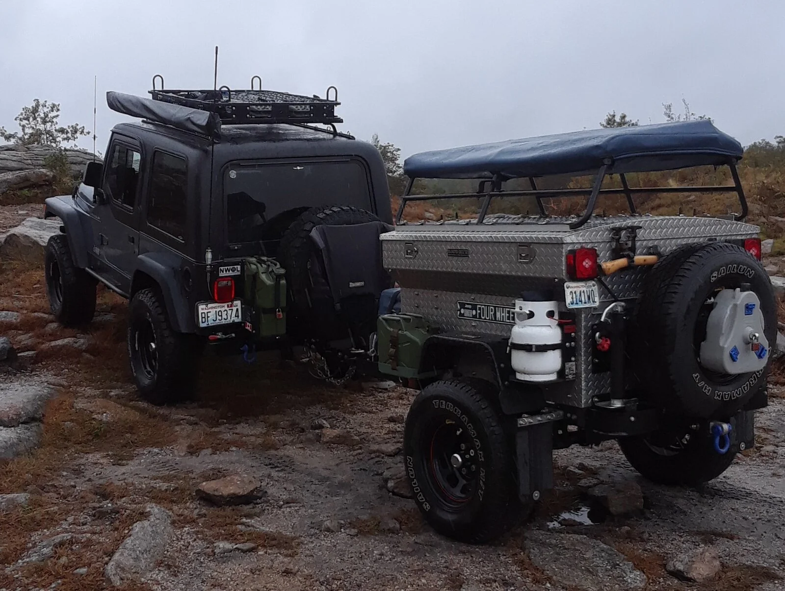

This next picture is of my overlanding buddy on one of our first trips we took with the Jeep and trailer. Gotta start somewhere. Picture two full-sized guys trying to pack everything needed for a couple day camping trip (we've been overlanding long before we heard of the term "overlanding"). Thank-goodness for the lil' trailer. If you look closely you can see stuff piled up in the back of the Jeep too. I learned a lot about my new lil' trailer on that trip (on this trip we did the highway 101 loop around the Olympic Peninsula after I came back from Iraq the second time), and we started making changes/upgrades. But this is where it first began. Good times - good memories. That's what the trailer does for me.

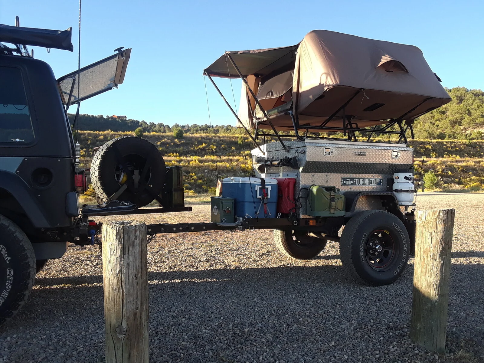

Here's a picture with the tent fully deployed. It is great to sleep in and comfortable, but that's about it. Can't really sit up in it. Very watertight (we've been in some storms). Notice I've done a drop-down tailgate conversion on the Jeep. Makes a nice cooking surface when overlanding, a place to rebuild a driveshaft (that's another story) or for just a place to sit. Dirtworx rear bumper.

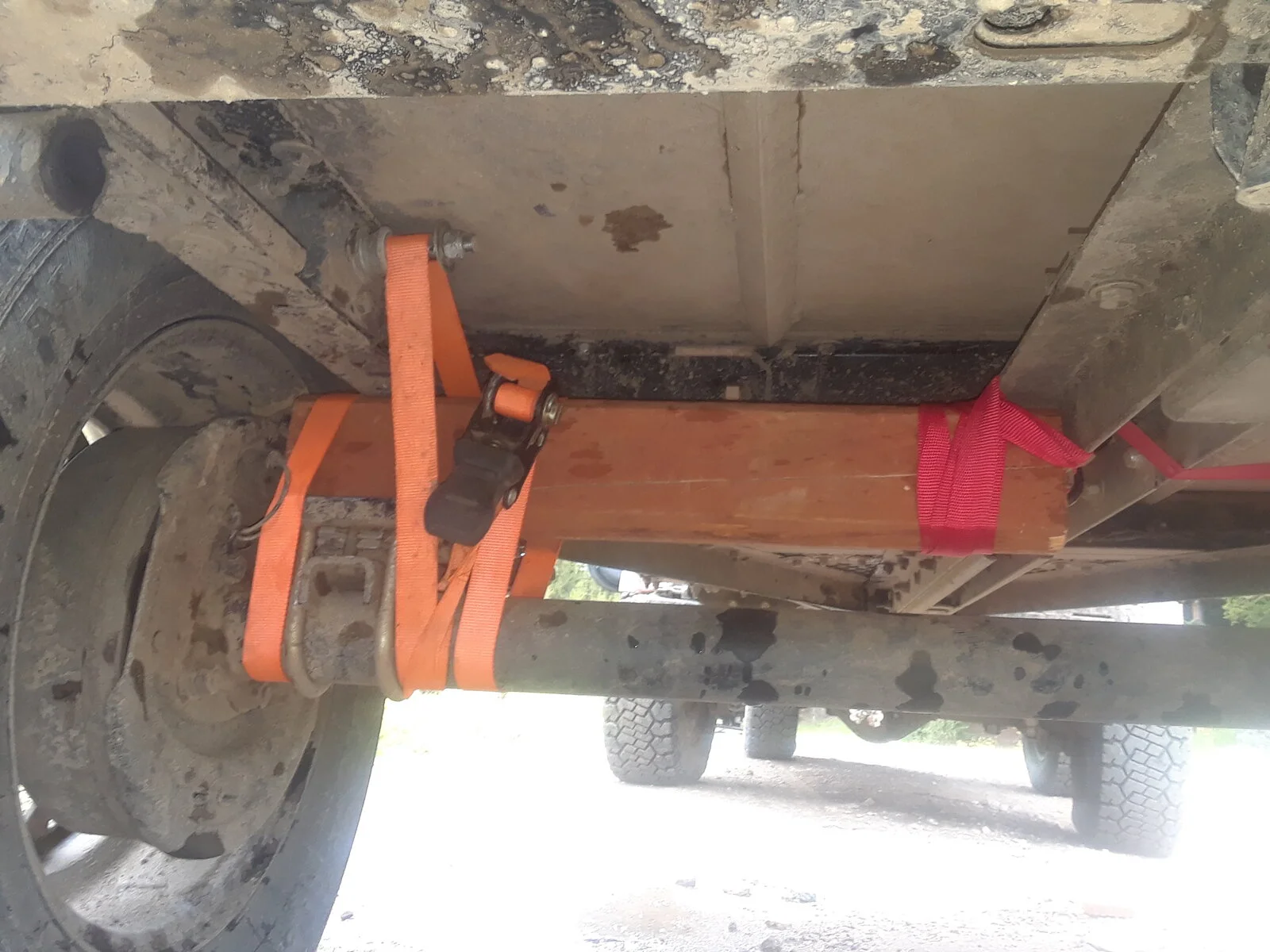

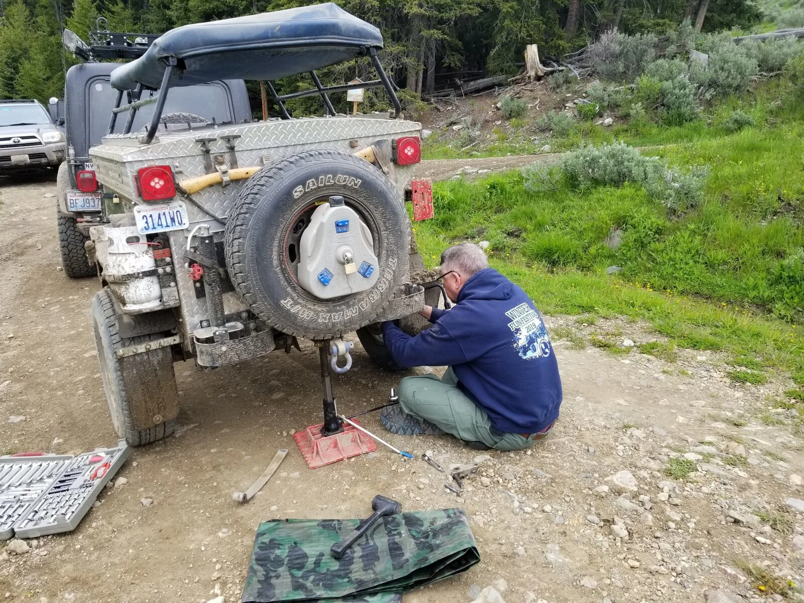

I've been pretty lucky hammering the trailer like I do offroad and not breaking anything (usually). The suspension gets a workout. Only time I broke something that required fixing then-and-there was the one time I snapped a leaf spring. We ratchet strapped a piece of wood between the axle and frame (fortunately the break was behind the axle), dropped the trailer's tire pressures real low (that was all the suspension that one side got), drove it the rest off the trail (it was the last day of a week running the WABDR), and then dragged it literally a couple hundred miles home on pavement. Then another set of springs and upgrades (like spring bump stops).
