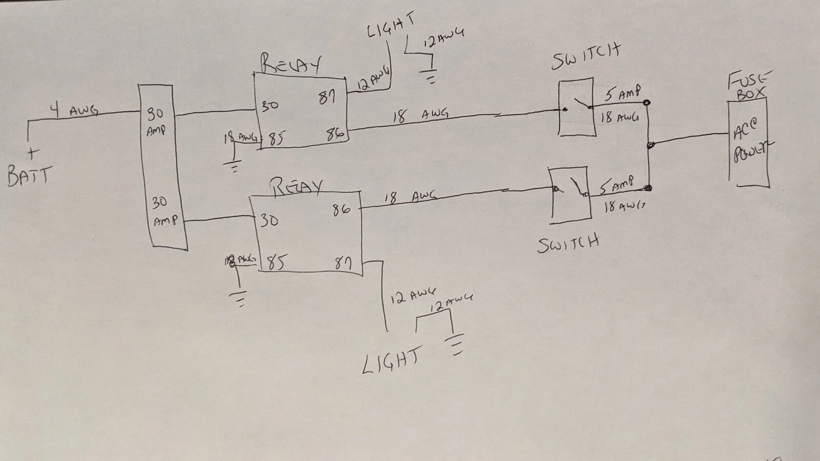

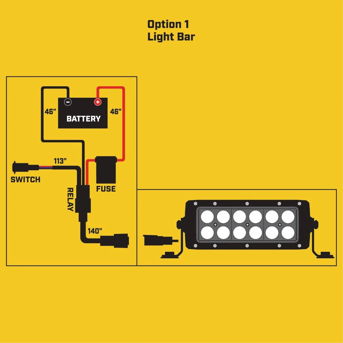

This may help and more lights equals more relays.
Yes, very helpful thanks. A few questions:
1) On the right side (Fuse box), is that where I'd tap some accessory line so the switches come on with the ignition? If so, what's the best way to go about this? Would I use a tap splice or something else, and which item and where is best to do this for switches mounted near the factory rockers for fogs?
2) Why is there only one wire coming into the switch form the relay/battery side? All diagrams and pictures I'm seeing show a power and a ground (often daisy-chained), in addition to the switch wire coming into the switch panel. It's that daisy-chained red and black wire that I don't get — where does it come from? See below pics as examples:

#1 You can use a fuse tap and tap it off any fuse behind the glove box tht only has power when the key is on.
#2 The relay needs power and ground (pins 85 and 86) to energize the coil to close the contacts and supply battery power (pins 30 and 87) to the lights. The lights will have a ground wire that the battery power will use. You can use the same ground for all the lights if you want by daisy chaining the ground wires together and connecting them to the battery or some other ground location.
As far as the switches, if it has an indicator light it will have 3 wires . One wire to the fuse tap for power, one to the relay (pin 86) and one to ground. The best ground for this is in the passenger foot well just below the dash. If is doesn't have an indicator light it will only have 2 wires, one to the fuse tap and one to the relay.

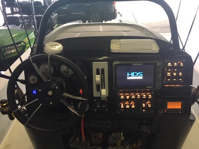

For Rocker Switches check out New Wire Marine they excellent wiring info for every rocker Sw made and rocker switch covers, panels and switches. The ones pictured are on my boat

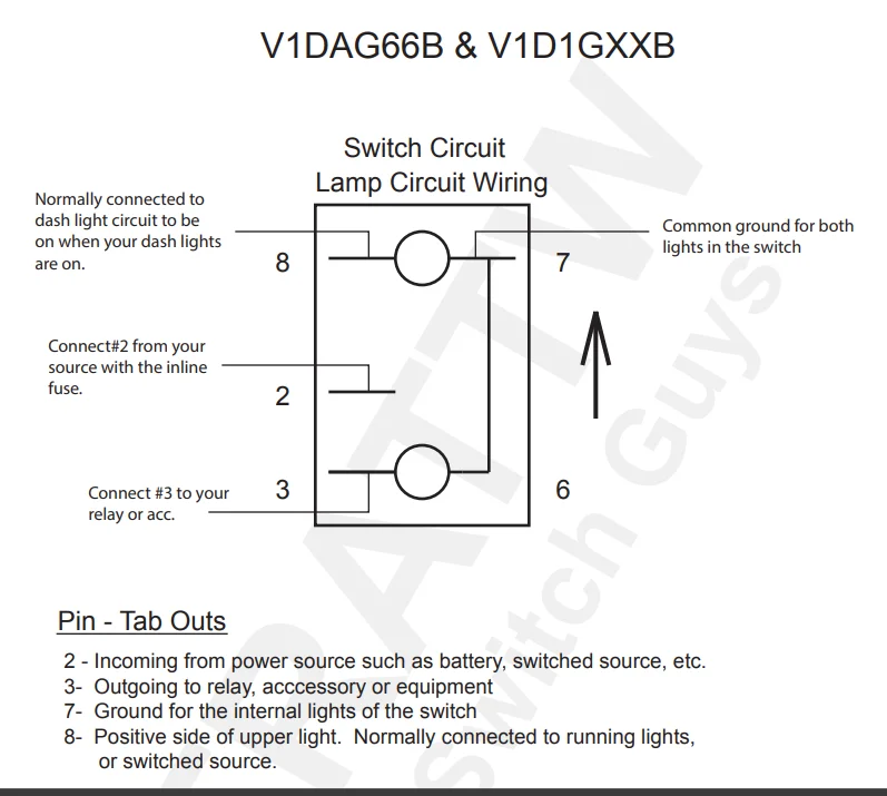

Hey, finally revisiting this as I got a bunch of parts and some time to focus on things. In follow-up to our previous discussion, I'm still unclear where the #2 pinout on the switch would get it's power from. I'm planning on using the OTRATTW switches with independent indicator lights. 5 pins on the switch.
Regarding the ground on the switches: Seems like I can daisy chain the two ground pins on the switch together, and then chain each switch ground together, leaving a single wire off the switches to ground to the body somewhere. Is 18awg ok for these daisy-chained ground connections to the body in the cabin somewhere?
Regarding the 12v+ pins on the switches: I get that the indicator light (pin #8) can be daisy-chained from switch to switch and then tapped off a fuse in the glove box that goes on with the ignition. This will illuminate the switches when the car is on. I don't understand where the other 12v+ wire should come from, going to pin #2 on the switch. Can that also be wired in-line with pin #8? If so, is 18awg again ok to use here? What about fuse size coming off the tap? My understanding is that these load will be small, just for the switch LED and to send a signal to my relay to turn on the accessory.
The above setup would leave me with two wires going into my switch panel, one daisy-chain for the two ground pins per switch-to-body, and another daisy-chain for the two 12v+ pins per switch-to-fused tap in glove box.
Remaining would be one separate wire per switch from pin #3, back to my relay for each accessory. So, if I had 4 accessory devices, I'd have 4 wires + 1 ground + 1 12v+ coming off the switch panel. Does this sound correct?
