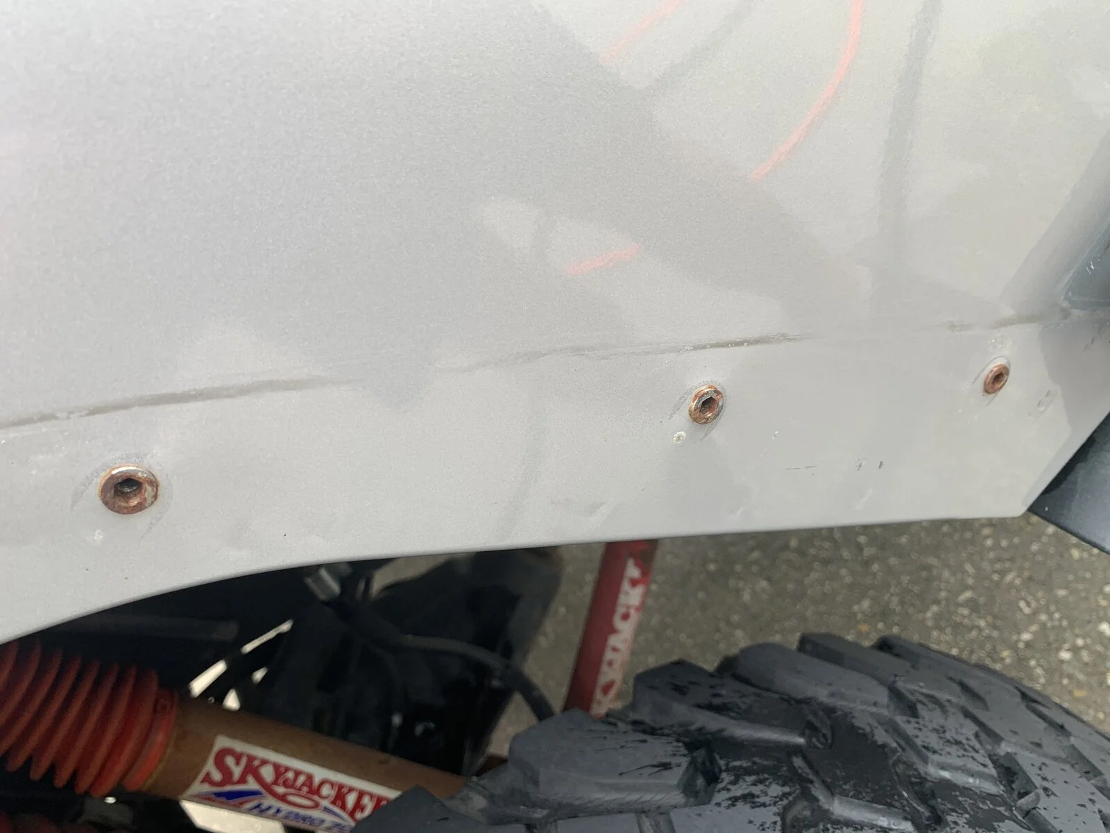

I used rivets, actually worked quite well and looked clean. I had to drill the nutserts out anyways so the rivets would be easier to drill out than nutserts in the future. Note: I only did this to the nutserts on the rear that you have no access to. The front I replaced with nutserts, just use antiseize on the screw threads and you shouldn't ever have the issue again.

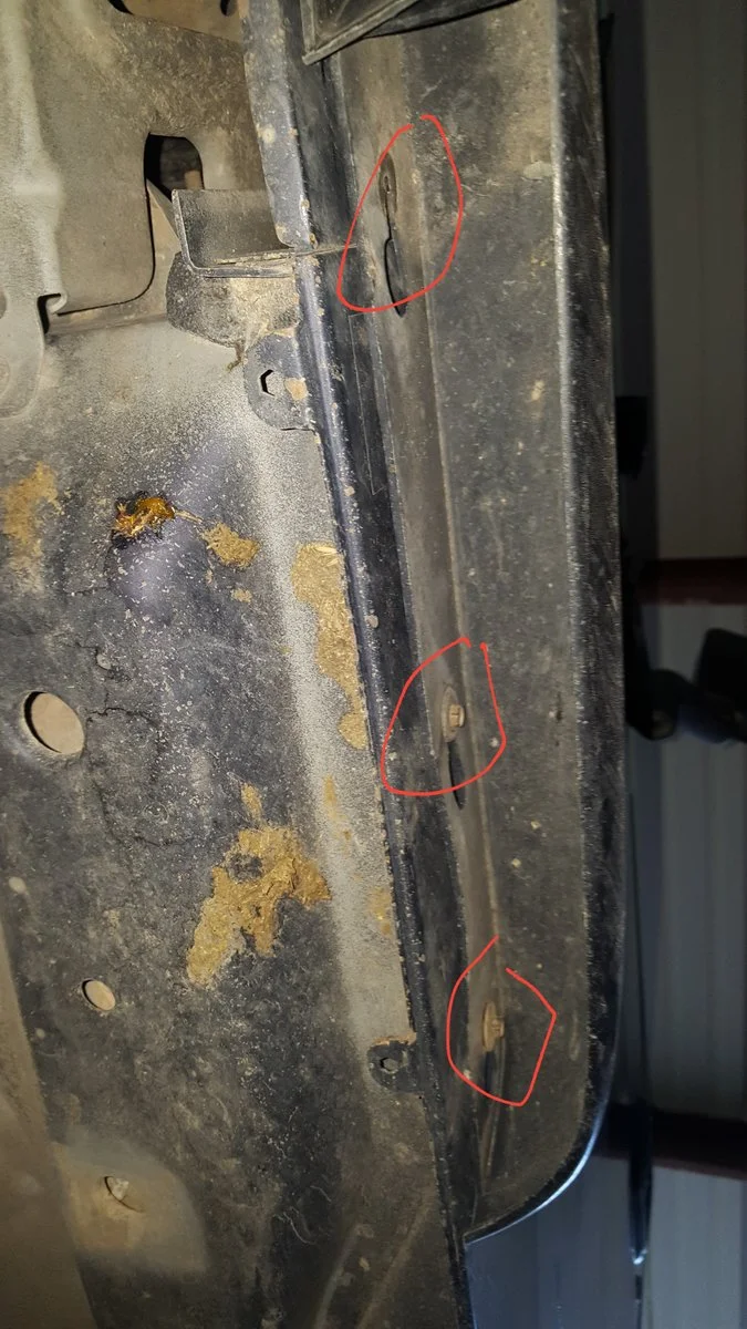

What about the three on the front fender extensions. The front most one came out easy and is accessible from the back. The other two that are just spinning don't seem to be accessible. Any suggestions besides drilling?
And excuse the cattle waste.
