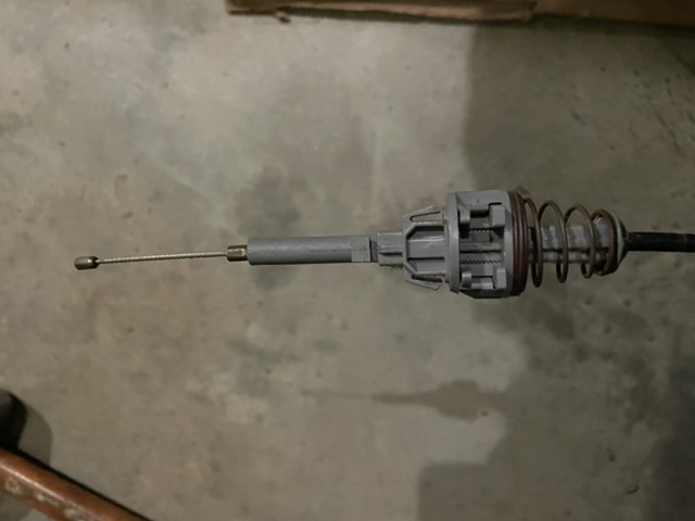

I'm in the process of reinstalling all of my TJ's interior and as I was about to install the forward center console I noticed this. Apparently a cable, that looks like it should be attached, is not attached to a plastic piece that's controlled by the automatic gear shifter. It's definitely not the shifter linkage. There is also a small spring towards the base that isn't attached either. I'm pretty sure that I didn't accidentally disconnect these when I removed the console.
So, what does this cable do? And does it need to be reattached?
That's the piece that prevents the shifter from being shifted out of Park without stepping first on the brake.

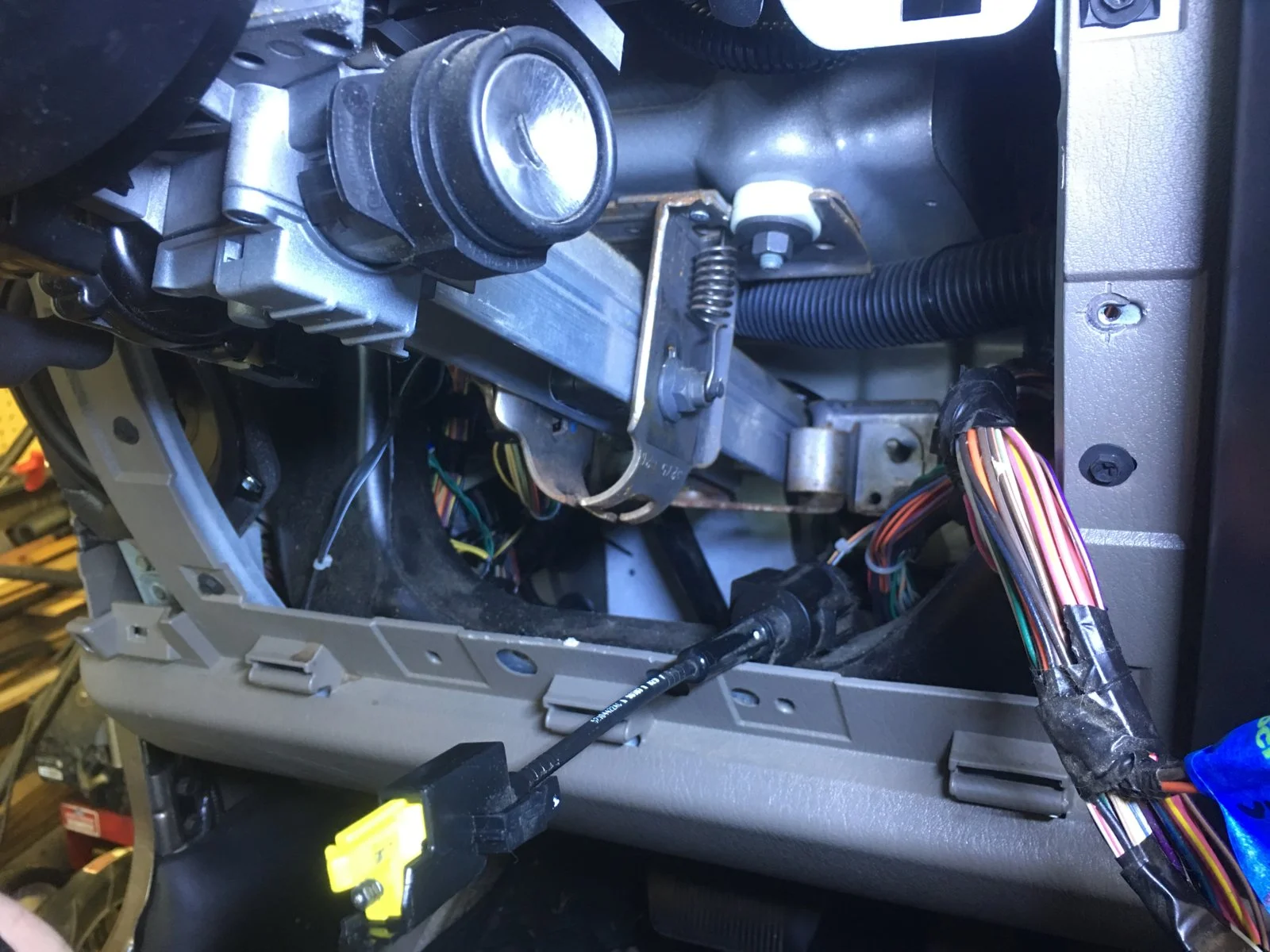

That's kind of what I thought it might be, but I just traced the cable and it leads up to the steering column. I also pushed on the brake pedal and the cable doesn't move.
It does look like it prevents the shifter from moving out of park though.
Brake Transmission Shift Interlock cable.

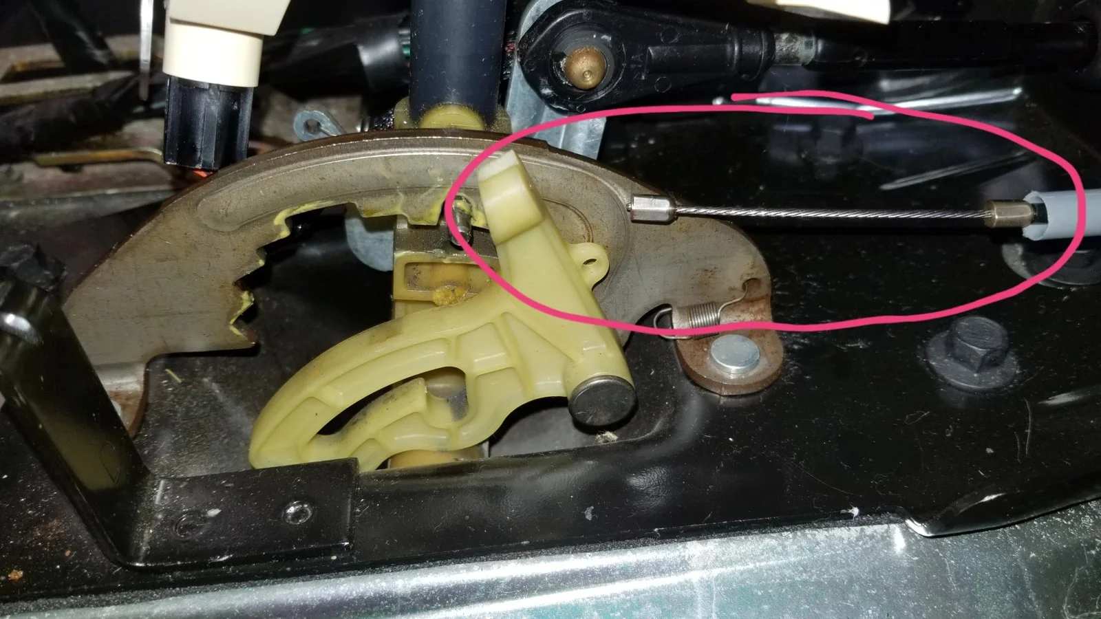

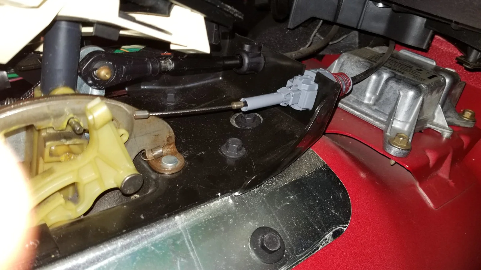

Did the other end look like this? The black cable thing in the bottom of the pic.
Maybe the same theme...

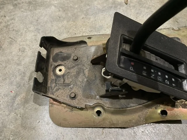

Did you figure out where the yellow end connects? I have the same view at the moment.
