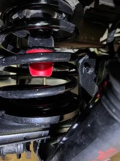

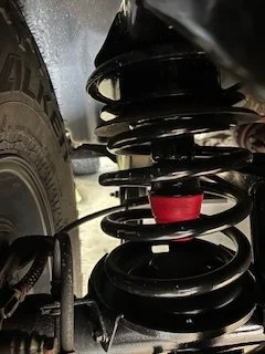

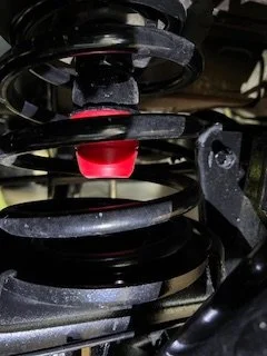

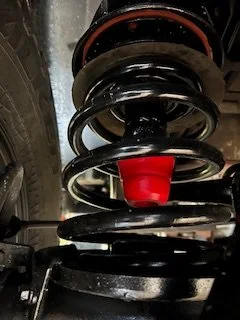

Now, when I hit a big dip in the road or travel bumpy gravel roads the rear bump stops bottom out. I can even jump on my rear bumper and get them to bottom out. I replaced the original dry rotted jounce stops with the red ones shown. The kit came with shocks for a 2" suspension lift and 2" coil spacers. I added longer sway bar links. I added an adjustable track bar BUT did not install a relocation bracket cuz it seemed to work ok in the original location. Here are some pics to show that I only have about 1.5" of space before they bottom out. Could my 20 year old coils be worn out? What do y'all recommend?
