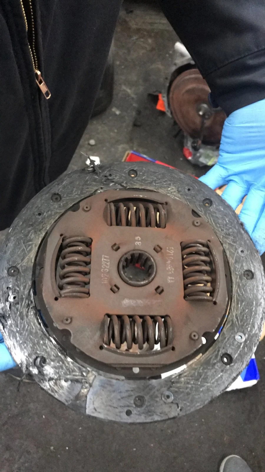

This is the old clutch, could I still use it?
The new clutch kit makes the Jeep fast, faster than it was i’m not kidding! It literally jumps forward now it’s awesome!
Reactions: Jerry Bransford
I got the Jeep with 144k and put about 2k on it, so 146k in total but I only drove it for 2k miles lol

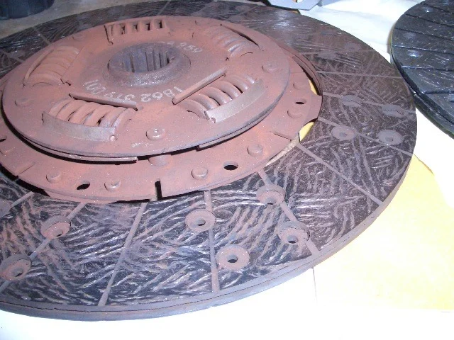

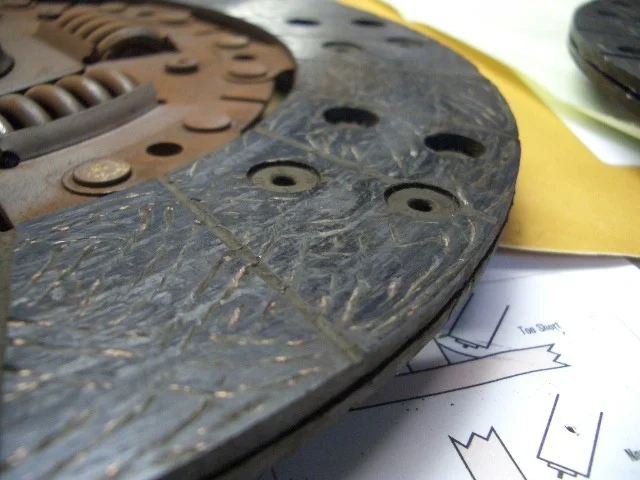

That amount of damage/wear at only 146k miles is very surprising and unusual. I abused the hell out of my clutch, regularly smoking it while rock crawling with it, and it still had plenty of life on it when out of caution I replaced it at about 161k miles. >200k miles on a TJ's clutch is not unusual.
This is my previous TJ's clutch with 161k miles on it the day I replaced it out of caution, not expecting it to still be in good condition.
