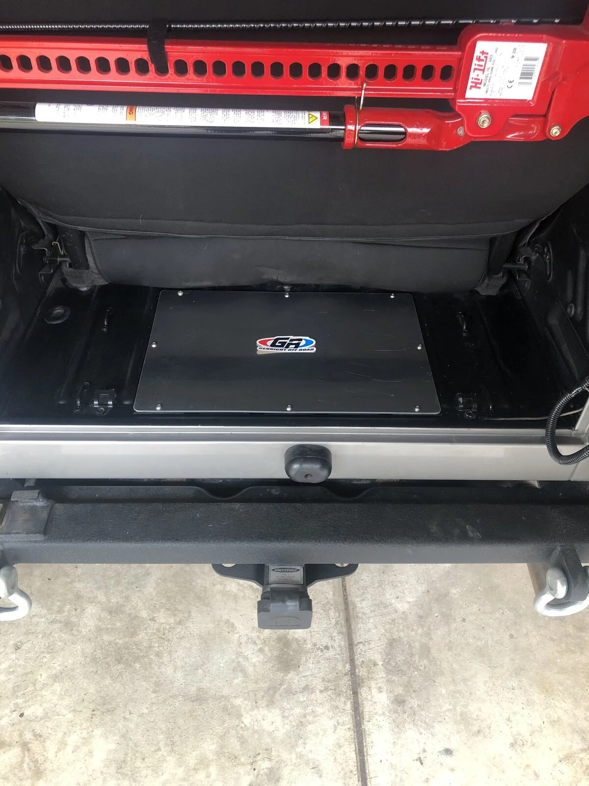

Moglocker
Mar 19, 2021
1,574
Missouri
Not that ive noticed, no. Ill keep that in mind when I fill up next.
Was fuel leaking out of it? How did you end up finding it. Ill take a peek today.
Thanks for this, where does one find the purge valve?
Have you had the fuel pump out lately?

Moglocker
Mar 19, 2021
1,574
Missouri
That was my evap leak, I didn't tighten that damn ring enough. What a pain in the ass that was. Hopefully @Moglocker didn't get that one right, dropping the tank sucks.
I had the hatch,it took 5 minutes,the smoke was puffing out 😂
