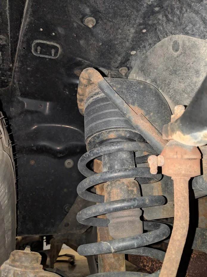

Recently bought a 2003 TJ with 33 inch BFGoodrich tires. The ride is terrible, and I've had a 3 "death wobbles" in the last 2 months. Although I was told the wrangler was not lifted, this is what I see when I look at the front suspension. I am sure I will need some suspension work, and have purchased a new oem track bar. But I am worried that I need to "fix" the entire suspension to fix this problem. Is this a 3 inch or 4inch lift, and can I improve the ride by just removing a "ring" from the suspension? New to this game, but am trying to learn! Thanks in advance!

Congratulations on your new TJ! There is no way anyone on the forum can tell you how much lift you have from the photo. However, if you measure the coil springs plus the spacers in your photo, then you’ll know. Stock is 12” up front and 8” in the rear. Anything over that is the amount of lift those spacers are giving.
Ride quality is related to your tire pressure and your shocks, not your springs. So, with 33’s drop your pressure down to 26psi. For your shocks, after you figure out how much lift you have and decide what you want to do with your suspension, get some Rancho 5000X shocks and you’ll be in heaven.
Unfortunately, a stock track bar with the lift you have will keep your front axle off center. The reason is when you add lift the trackbar really needs to be longer to keep the axle centered under the Jeep. It’s attached on the passenger side at the axle and the driver side at the frame. Since the frame won’t move, the axle is shifted toward the driver side. To correct this you need an adjustable trackbar.
However, for now just figure out how much lift you have and what you want to do with the suspension. Then you can decide on new shocks. And get that air pressure down to 26psi, that will make a world of difference and your tires will wear evenly.

As an update....I had the wheels balanced today and an inspection performed. Sure enough, one of the ball joints is bad, as are the tie rods. Bad news is the car is even worse after the inspection/balancing (technician said it likely had to do with putting the car on the lift ?), and I had 3 episodes of DW on way home! So, am having those things fixed tomorrow. I'm browsing adjustable track bars, too, but will probably put that on myself at a later date.
