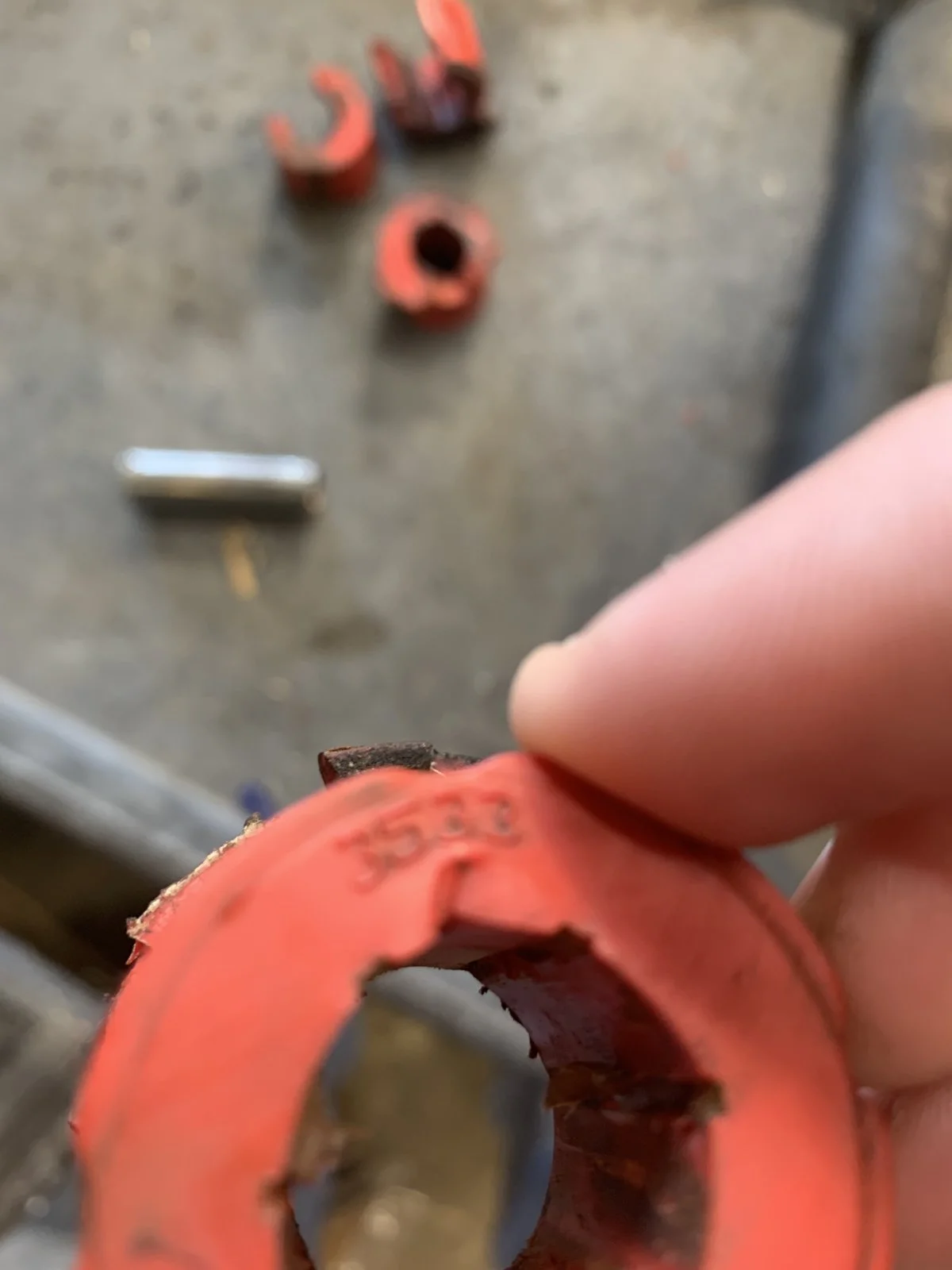

2000 Jeep TJ with (what the previous owner claims) a 6” Rough country lift. The red polyurethane lower control arm bushings are shot. RC has been zero help and I cannot find replacement bushings. ‘3533’ is stamped on the bushings I removed.
So several companies made arms like that. You will need to measure the eye and see if it is 1.5 or 1.75. This will help narrow it down. I would suggest replacing these arms as the poly bushings are prone to causing bracket failures.

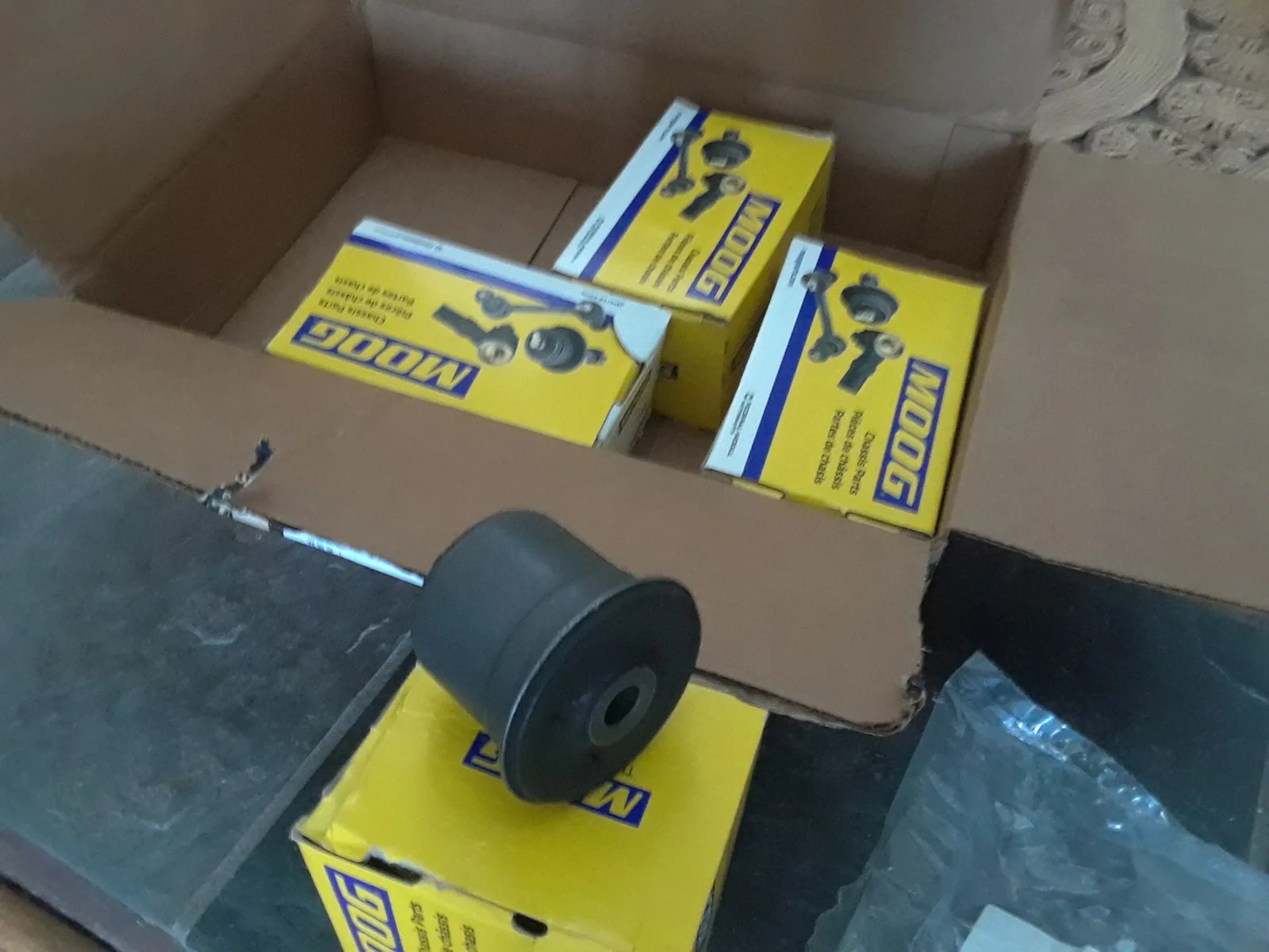

These 8 Moog replacement bushings will go on my jeep
I'll stay with my 2.5" lift for now, which means i wont be needing different CAs so these bushings will be used on an as needed or PRN basis.. :)
