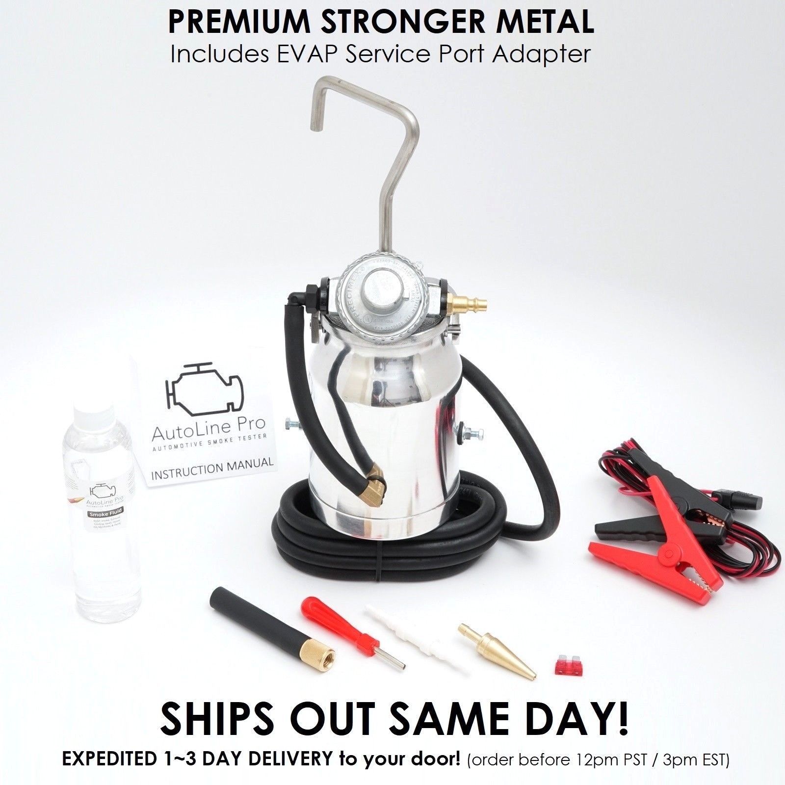

This is all Great info guys! I decided to purchase a smoke machine because I can see so many uses for checking vacuum system... specially when I'm working on a 1968 to 1972 Corvette with all the vacuum systems they have. Opted for one a little nicer than an old ammo can or a paint can, the one I got looks more like an old air paint pot with a nice hook for hanging. ($120 shipped) I should have bought one by now and you all helped me just get the fence post out of my butt and get one.
Thanks!!!

I received my smoke machine today and I am armed with the factory test procedures... I'll keep you all posted as soon as I have time to run through the trouble tree, Thanks again for all the advise!
I look forward to hearing your results. Those smoke machines are in my opinion a must have tool for the DIY mechanic.
BTW, do you have a link to that smoke machine you purchased?

Hello again fella's... I've been really busy at work lately but have I finally gotten a chance to hook up my new smoke machine to the Evap System on my TJ and found my leak very quickly. BTW (I love this smoke machine and will fine many uses for it working on old Corvettes and a few other Old Chevy's I usually work on). Thanks to those for getting me to buy one, I should have YEARS ago!!!

These smoke machines are $10 cheaper now then when I bought mine a month or so ago... Seems to be a good quality build and it makes a lot of smoke pretty fast.
