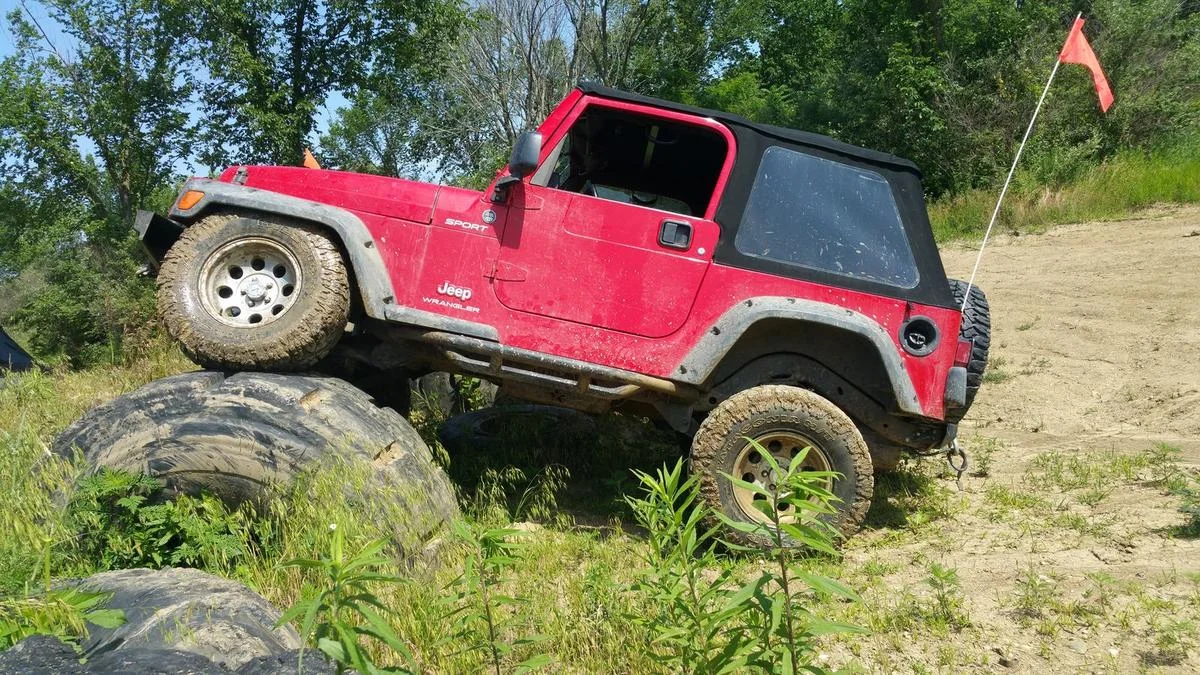

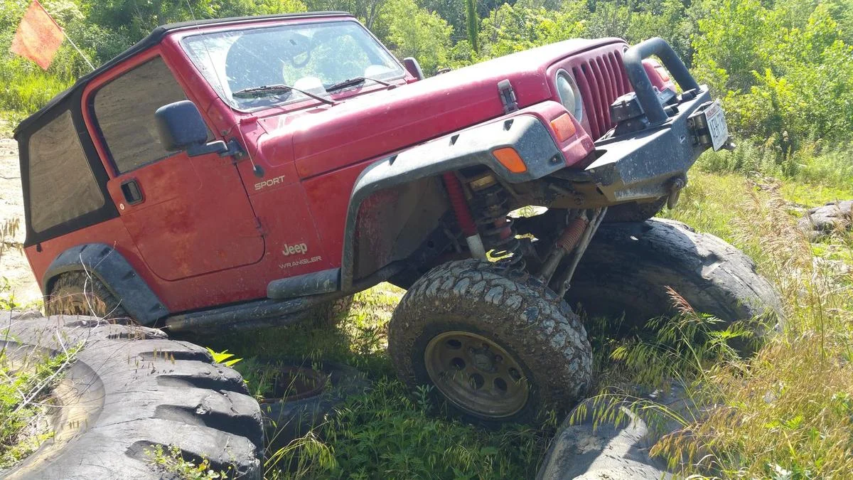

The correct length shock is the one that divides it's travel in half on your Jeep.
Use 24.5" extended length with 2" bumptop extension. The coils are 19.5/14.5 free length. Maximum collapsed length for the rear shock with a 2" bumpstop is 14".
The 2" lift ome shocks are 13.5 collapsed 22.5" extended. No bumpstop extension required for the front, 1" required for the rear. If you have 33" tires, 2" bumpstop extension is required under stock and flat fenders, including metal cloak. Running 2" bumpstop extension with a 13.5/22.5" 9" travel shock only allows you to actually use 7" of it. A 15/25" shock makes use of the entire free length of the spring with a 33" tire.
