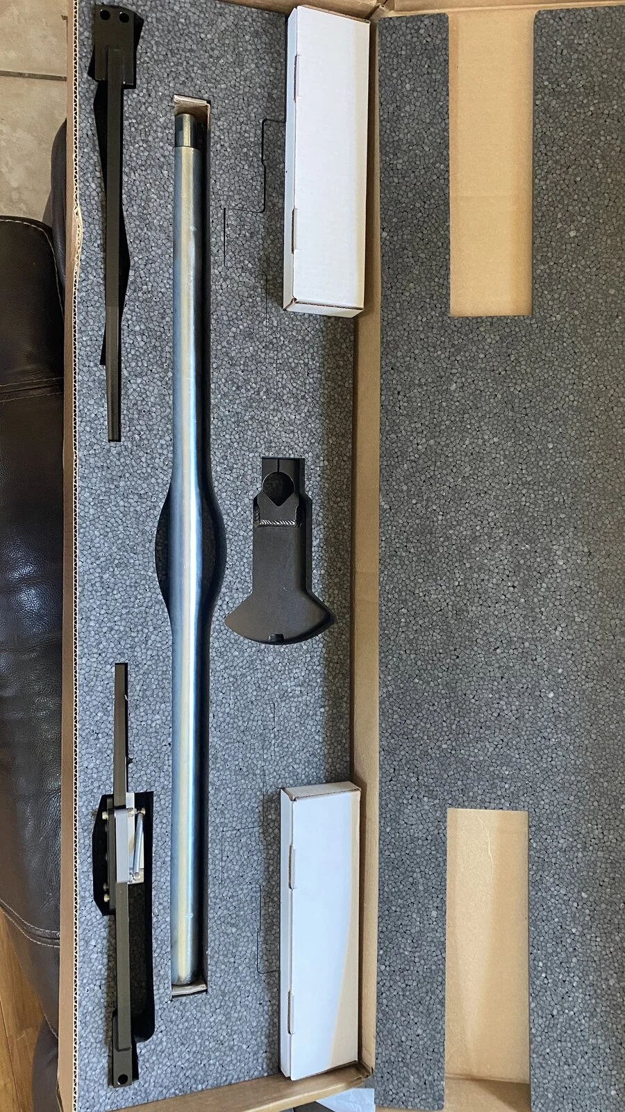

Well even though I was told by Quadratec I had the last one and it shipped on Tuesday and I received a shipping number it wasn’t actually handed over to fed ex until today. So it is supposed to deliver Monday. However the one from Poly Performance will be delivered tomorrow so I have a gift for my friend after all.

He was in shock I believe. He is one of those guys that constantly goes out of his way to help others. He would give the shirt off his back to a perfect stranger. I wish I could do more to show my appreciation for his friendship and all of his help over the last few years. I made sure I got him something he would never purchase for himself. So this was a great gift. And will be a great addition to his TJ as well.
