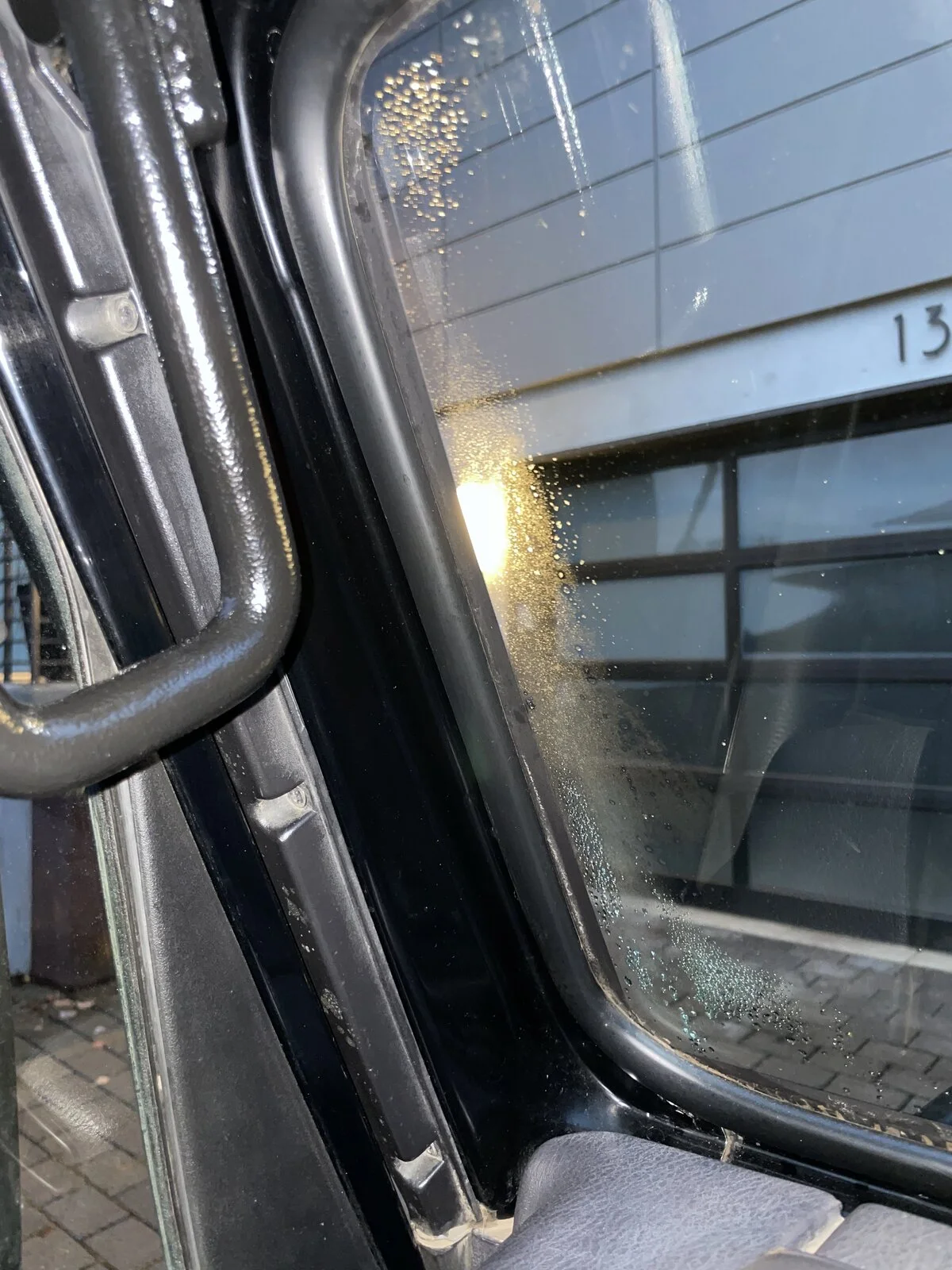

The windshield frame could be from condensation, it also gets wet on the inside of the hardtop from condensation

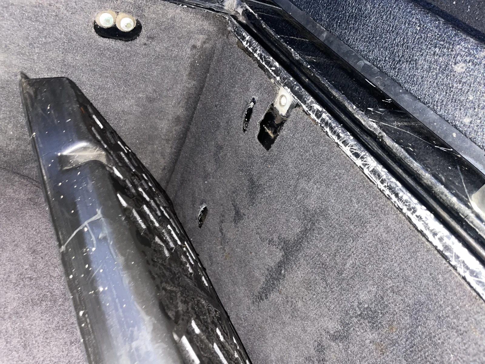

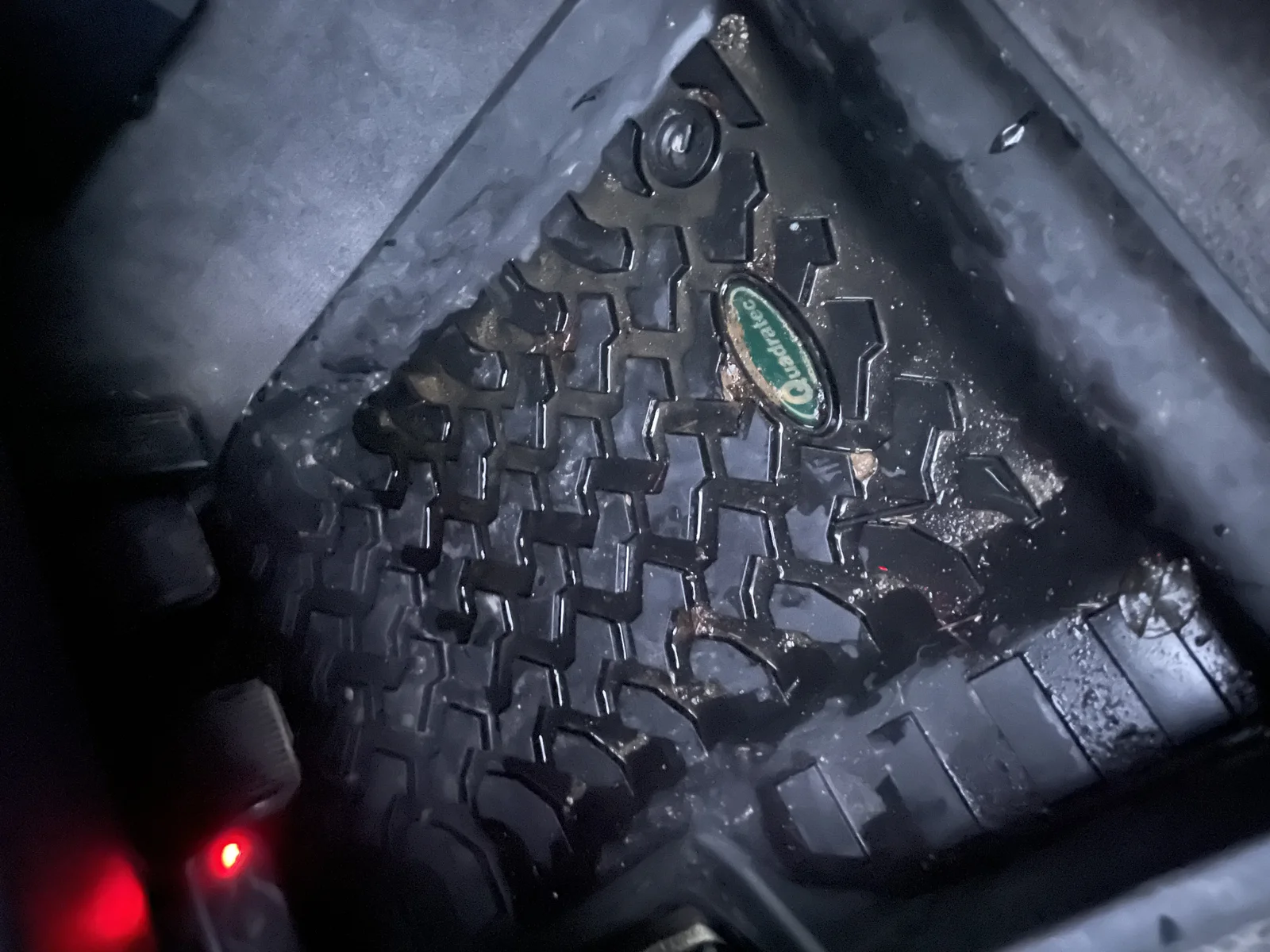

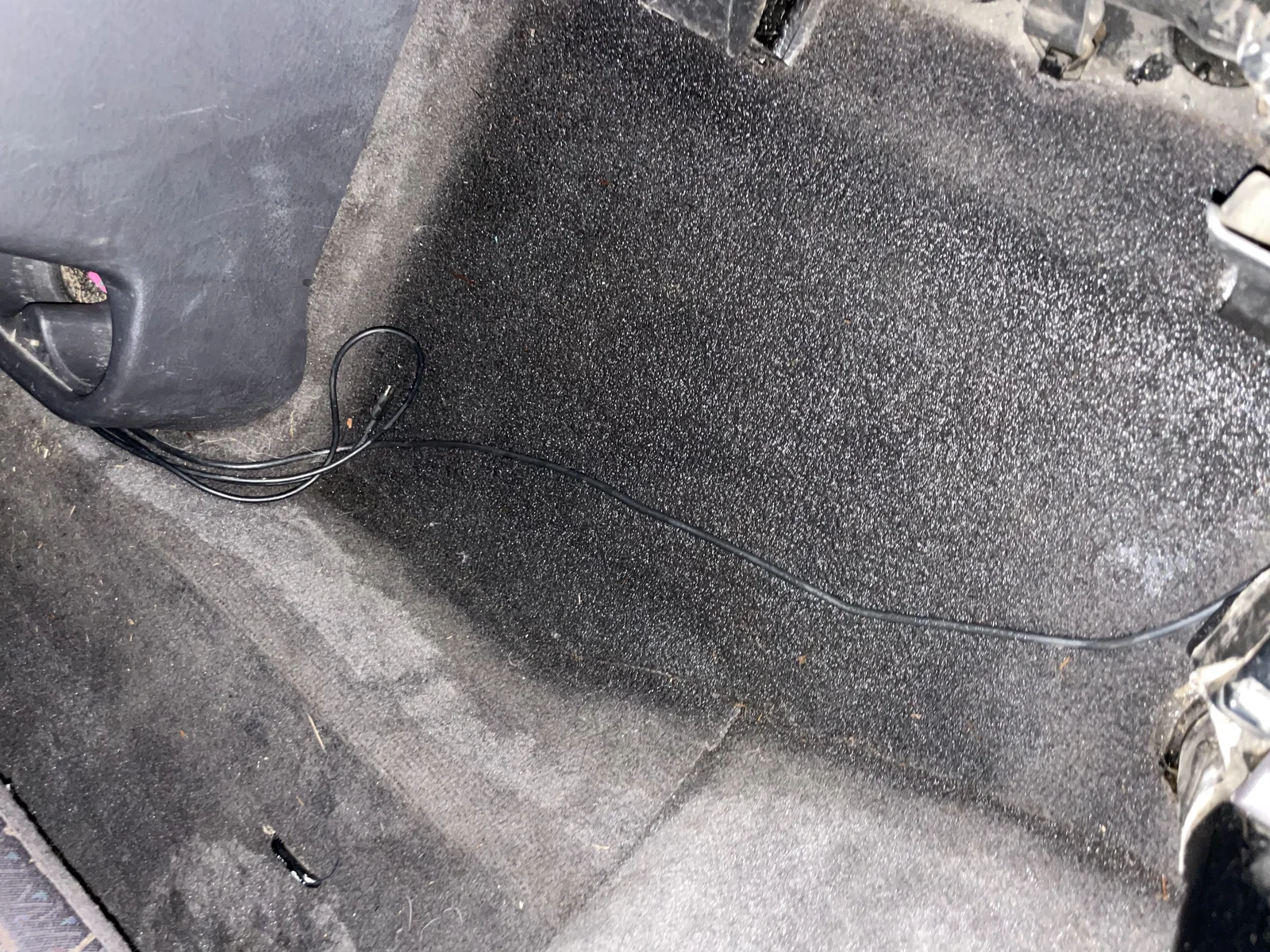

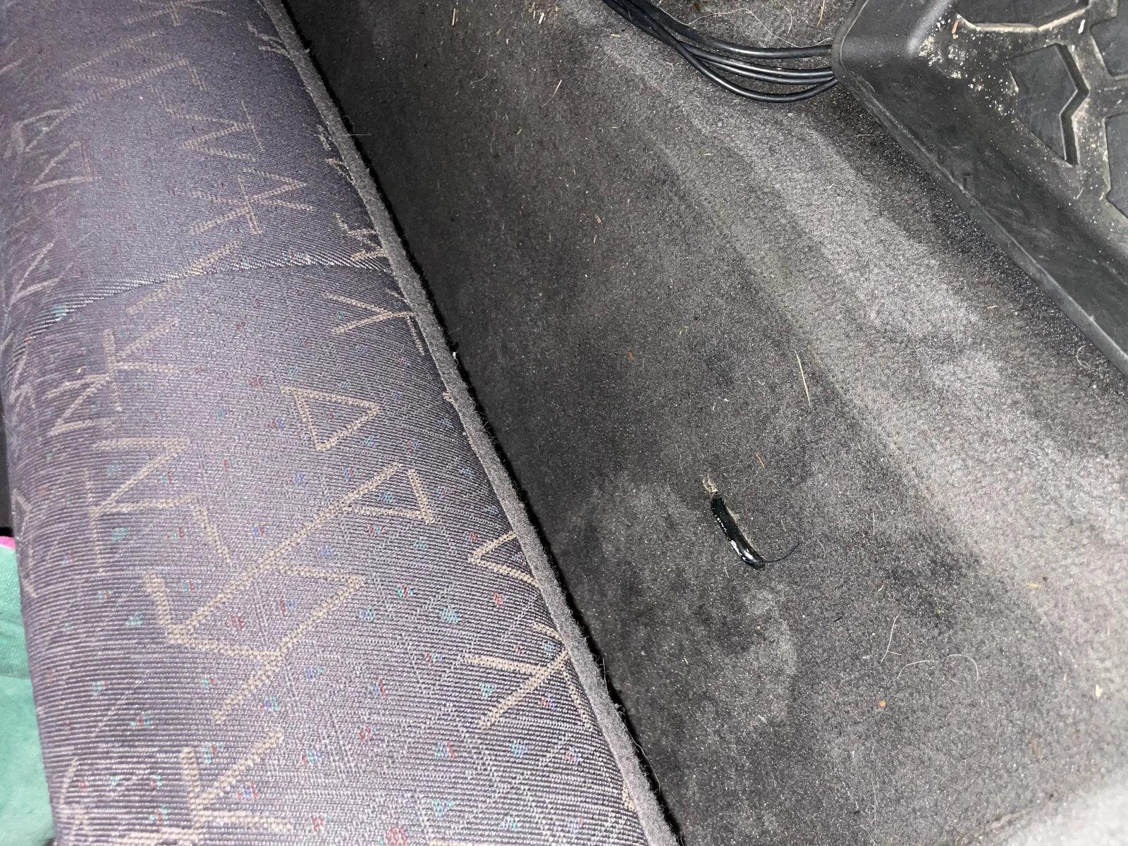

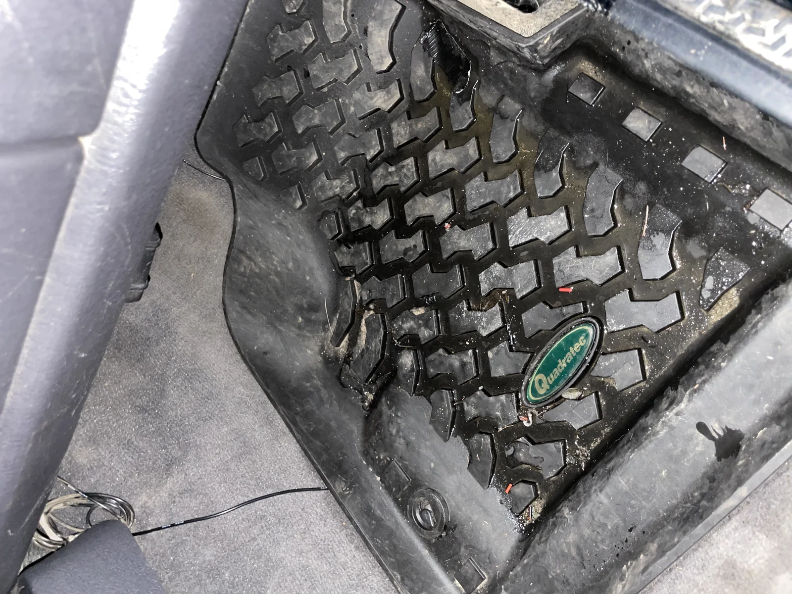

Both front footwells, carpet underneath is soaked
Under rear mat and seat, and probably the worst under rear seat foot wells
So practically every part of the carpet gets wet, except for the rear fender wells,
This is completely dry on both sides

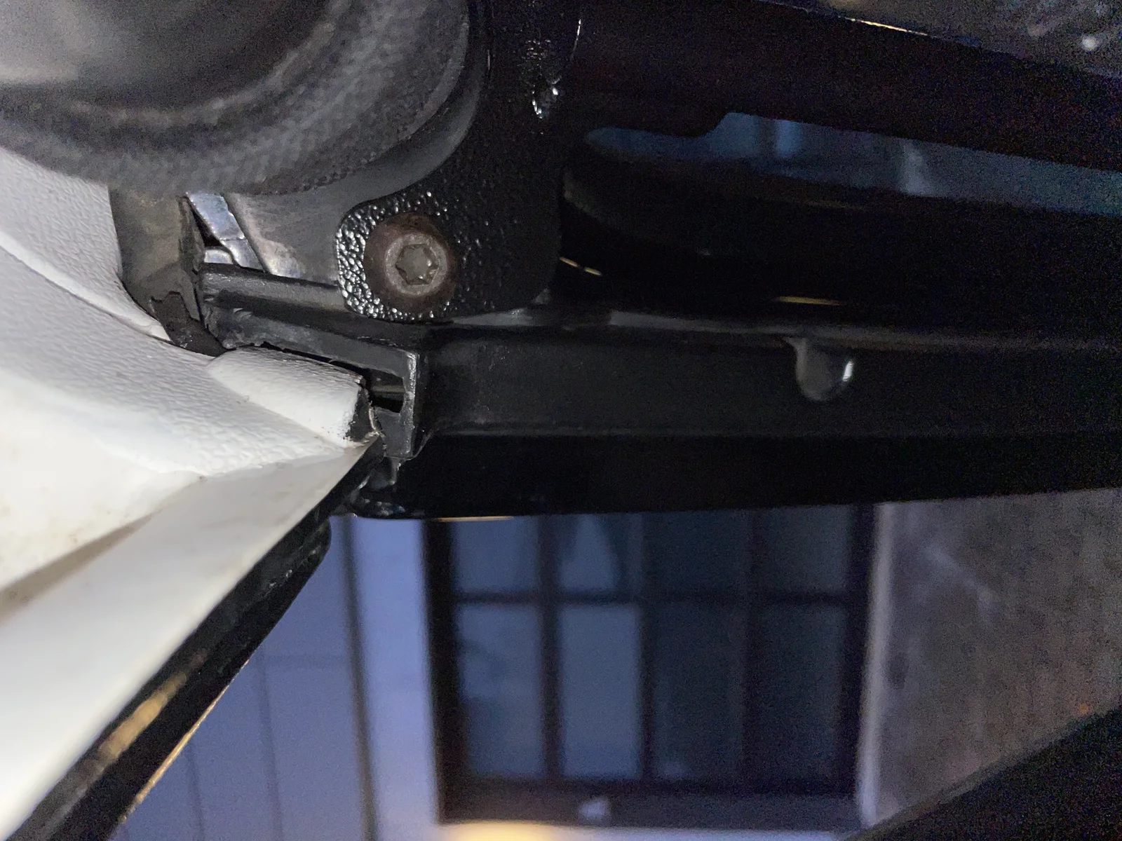

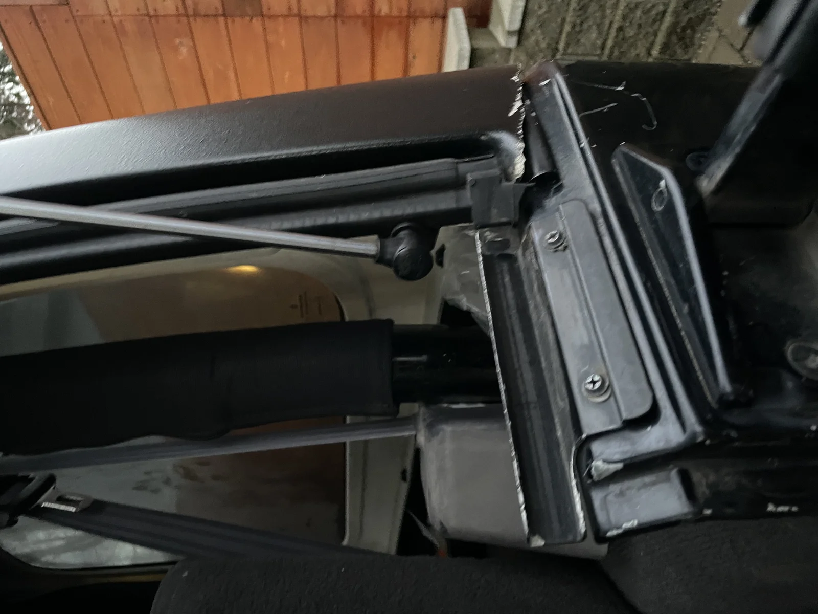

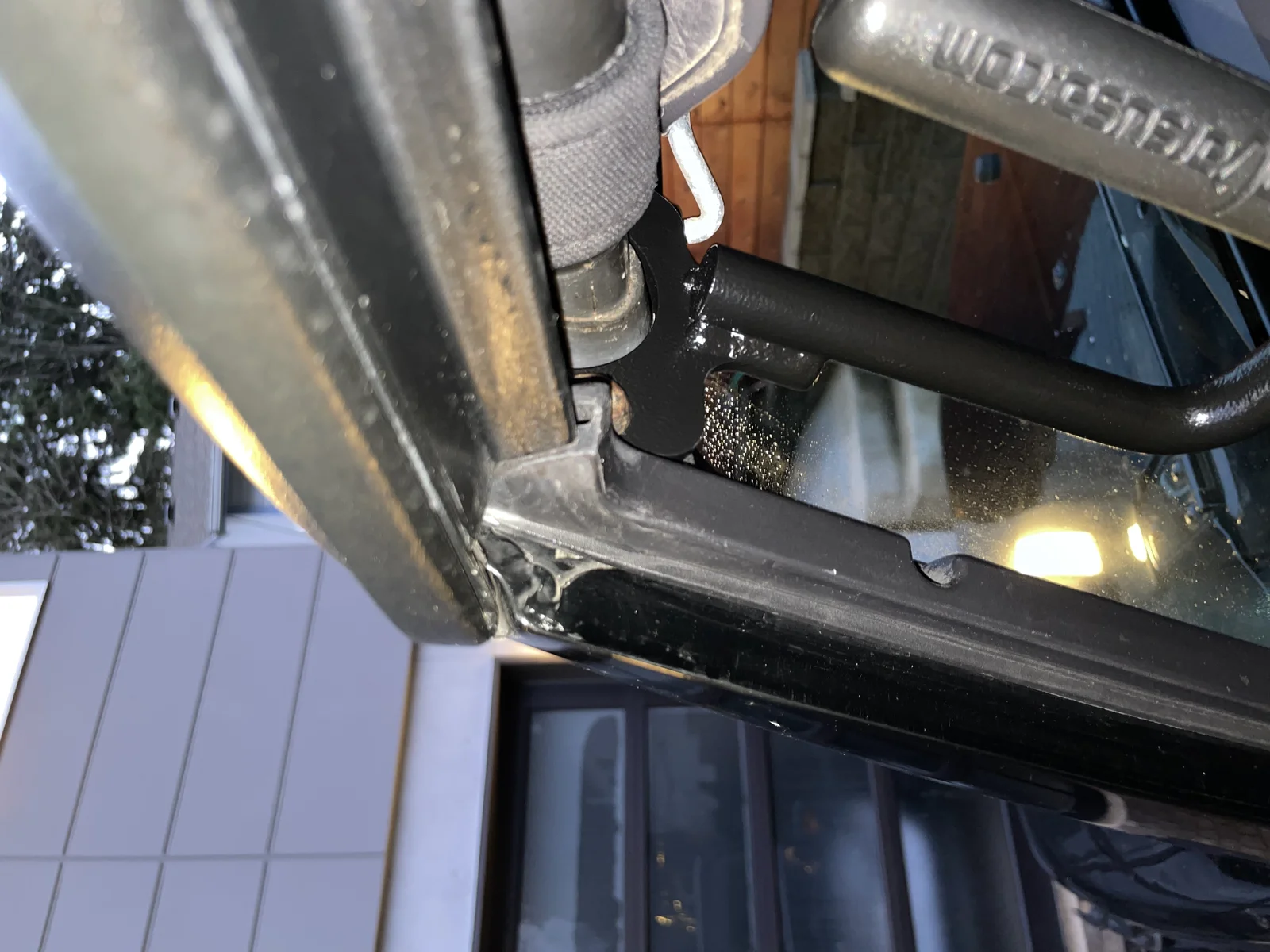

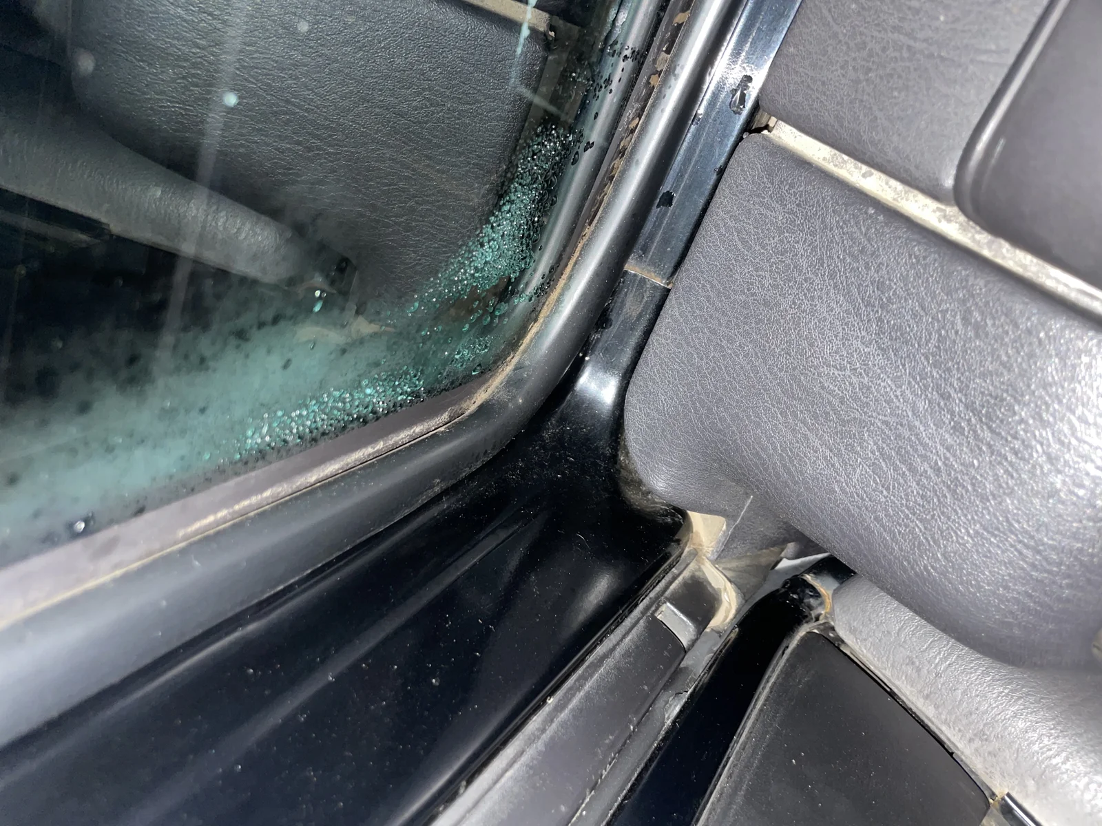

I have yet to find the best way to detect leaks, but today i blasted the heater inside and walked around the outside running my hand along every seal. I felt strong air coming out in these locations:

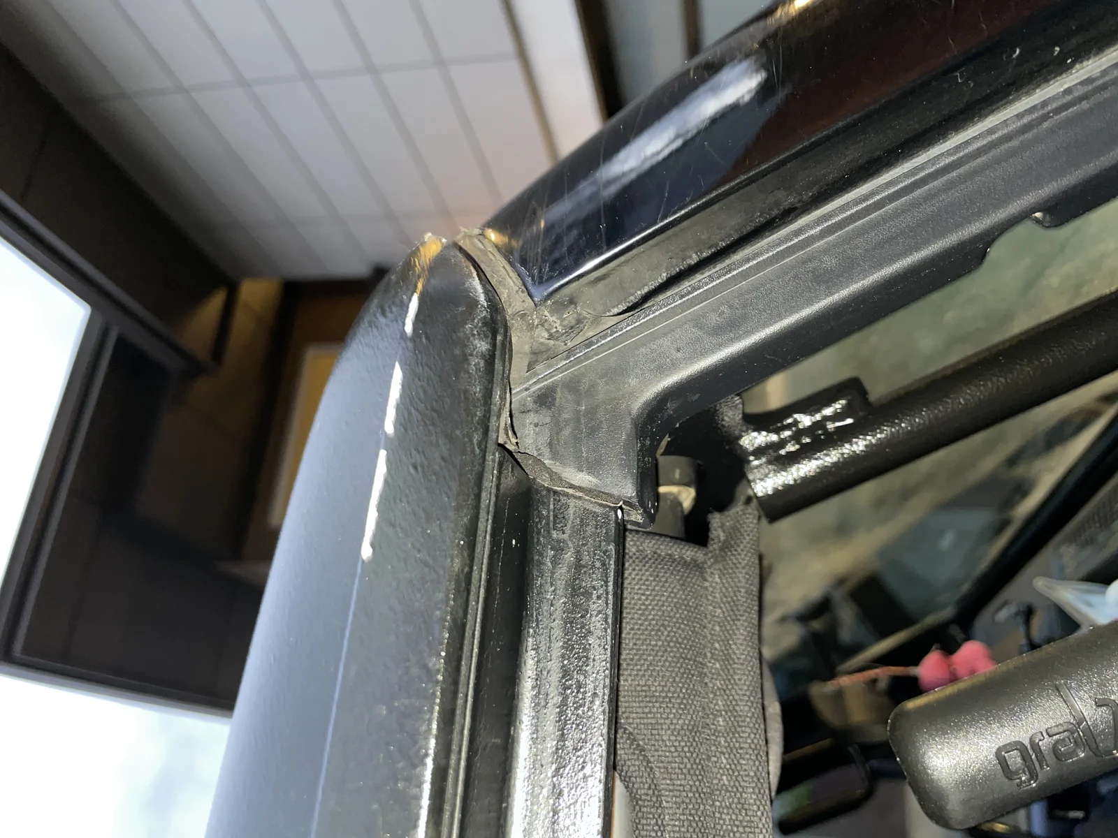

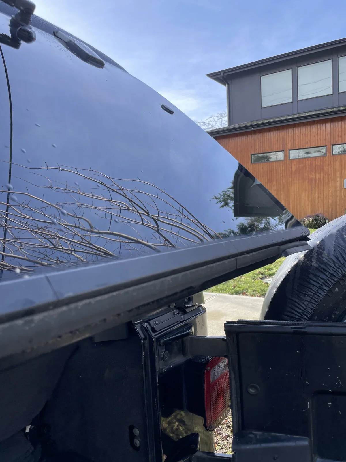

Both corners of the hardtop/tail gate, where the seal ends

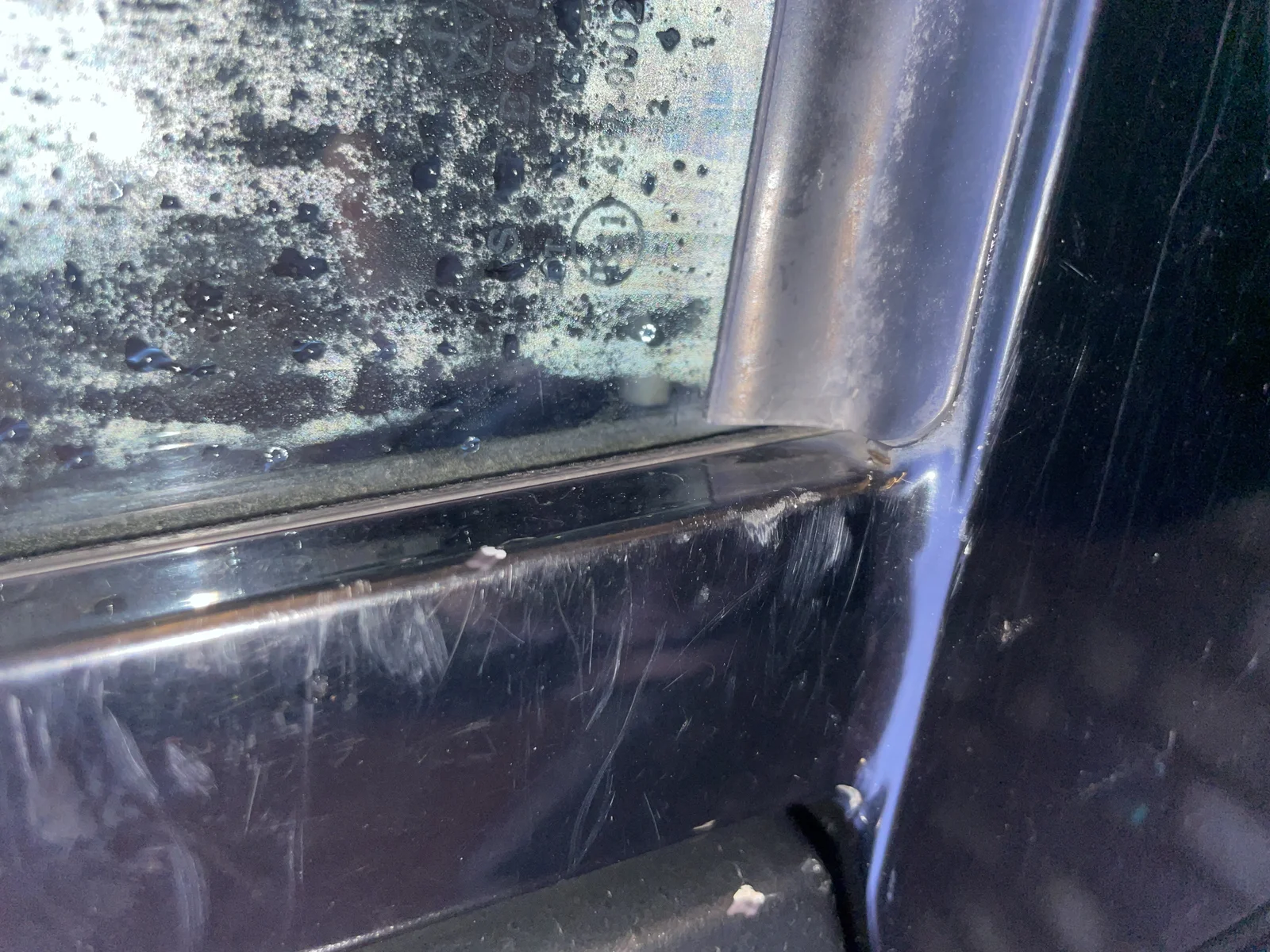

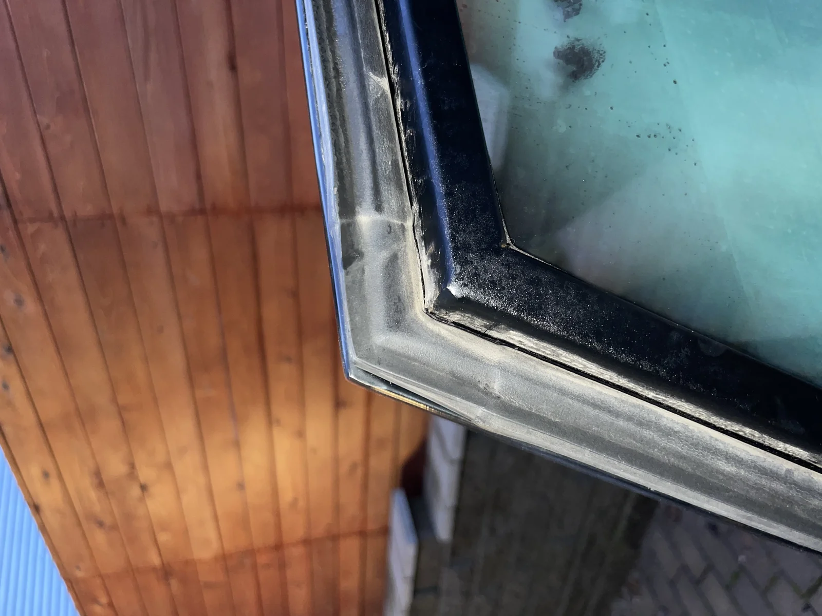

All along the driver side hardtop window, but not along the passenger side

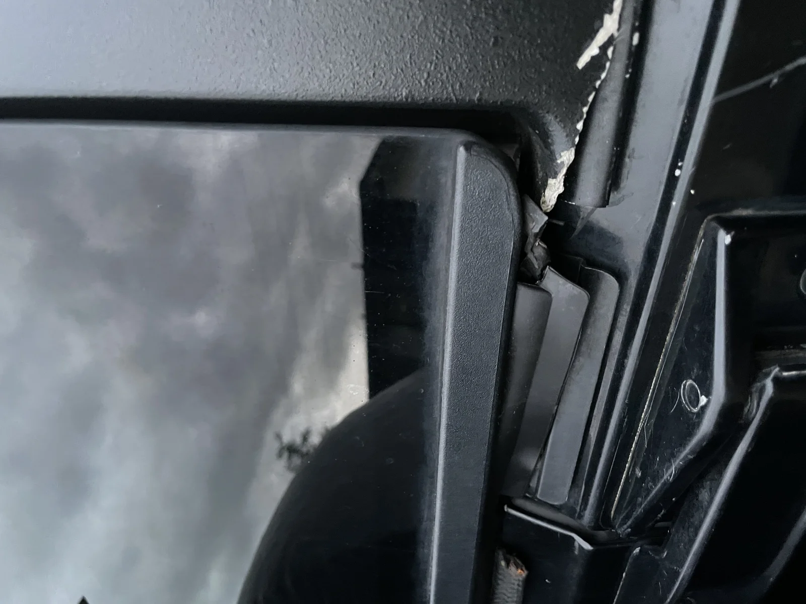

On both sides at the top of the door, where the windshield frame, hardtop, and door meet

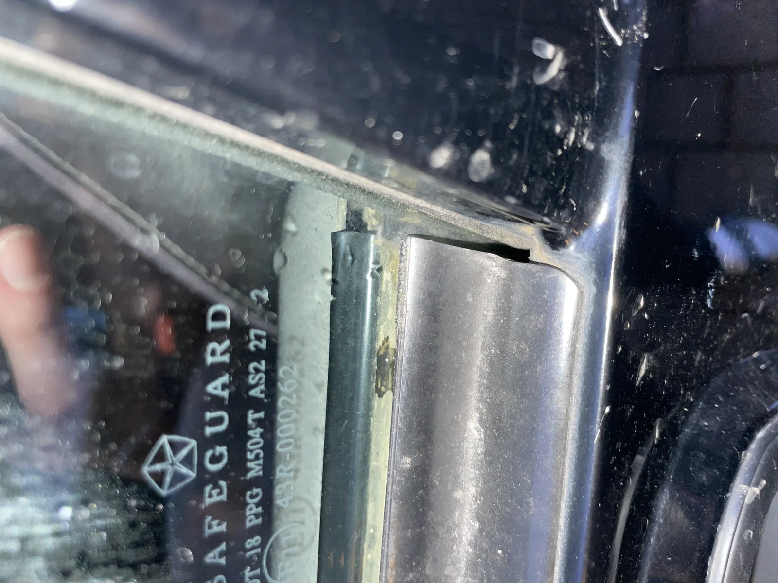

And lastly at the bottom of the window on the drivers side only
I can feel it strongly out of this, and the crack on the drivers side is much larger than the passenger side which doesn't leak air
Drivers side:
Passenger side:

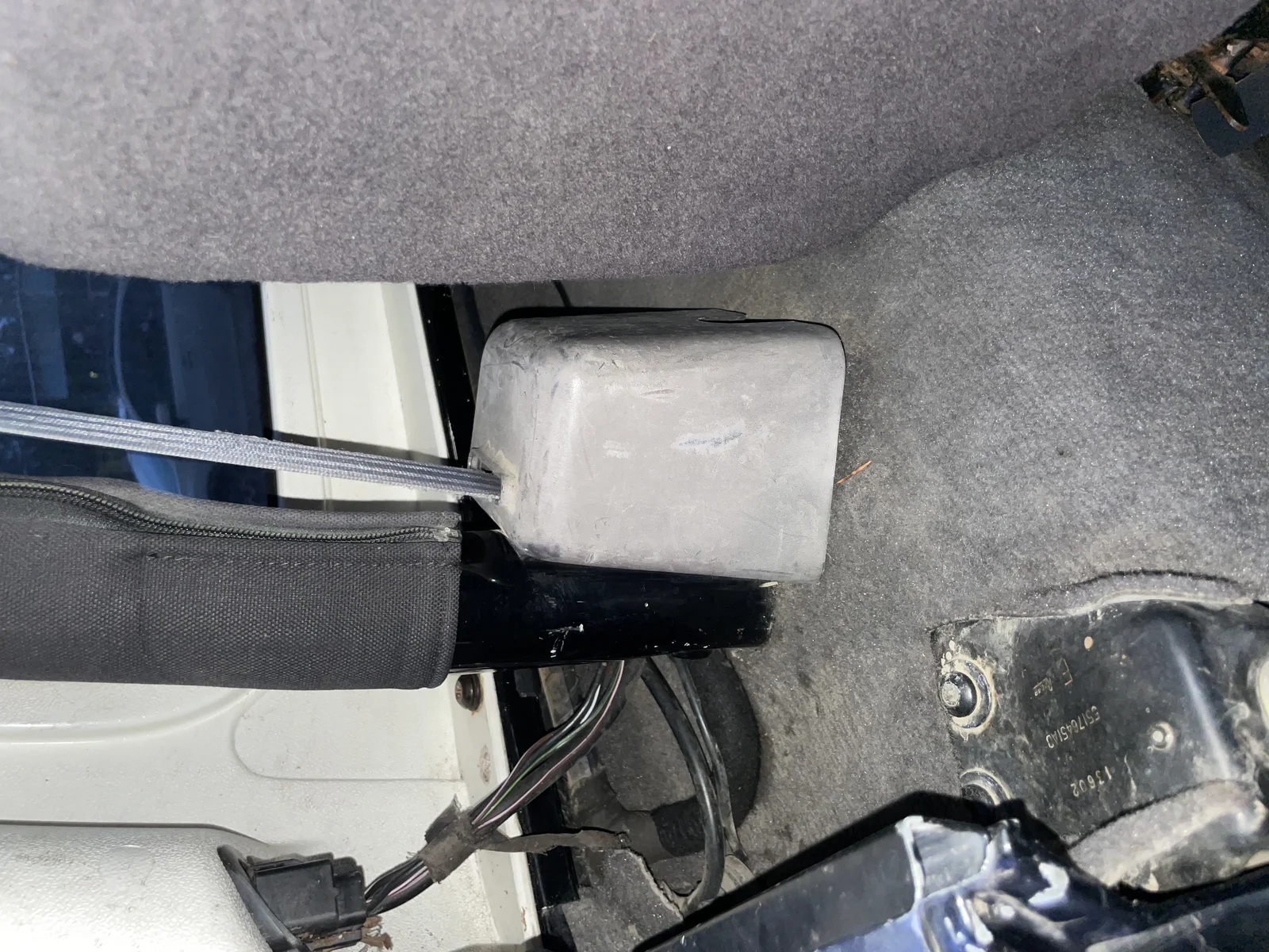

You might not have as many leaks as you think. The carpet can catch water in one place and wick it to another place.
You may have to remove the soft top brackets to get the rear window (liftgate) to close and seal better.
It also looks like there's a piece added to the top of the tailgate. That's usually a bandaid for a bad liftgate seal.
The condensation is most likely from all the wet carpet.

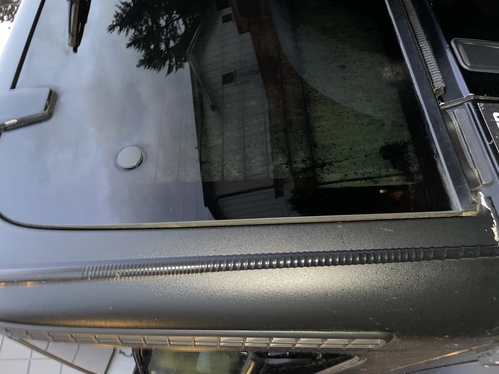

Did you mean this seal on the tailgate? It was on it when i bought the jeep.
I left it on but replaced this seal on the back window…
Since i replaced the window seal can i remove the one from the tailgate?

That type of tailgate seal is put on when people use a cheaper Rampage type soft top/trek top, the tailgate bar doesn't fit correct on the Rampage tops like it does on the OEM so people take the seal off the tailgate bar and put it on top of the tailgate.
Also when you close the door the pressure inside can cause the liftgate to pop out a bit and not seal, you need to push each corner shut after you lock up if rain is expected.

I don’t use a soft top. Just a hard top or no top. Does that mean i can take the seal off the tailgate?
Yes, you shouldn't need it when everything else is working properly.
As far as the soft top brackets, some say they also help hold the rear window down.
Depends on whether your new rear seal snaps into them.
Newer brackets aren't designed the same and have to be removed when a hardtop is installed.

I don't know where the water is coming from but I bet almost all of the condensation on the windshield and top are from the soggy carpet. You should probably pull the carpet and hang it up somewhere to dry and check the metal floors look OK.
I pulled them today, the metal floors are fine. When i first got the jeep i pulled everything and wire wheeled/painted the rusty spots so they were fine.
