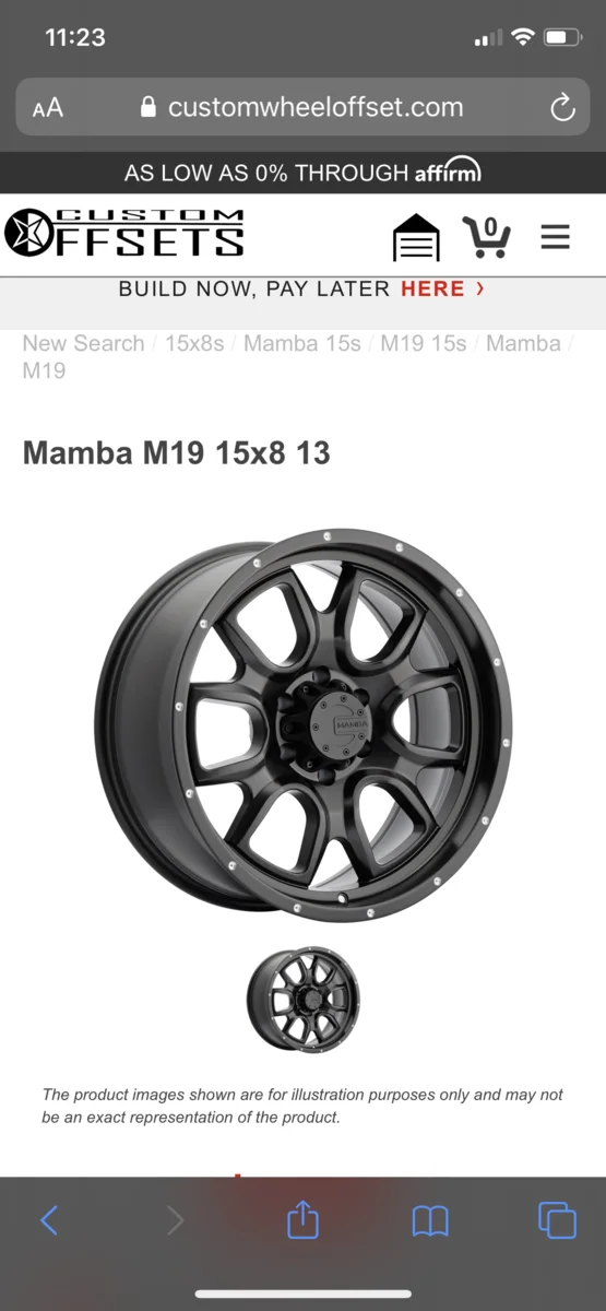

Found out mamba makes more than just the mr1x with lots of backspace. They have this 15x8 wheel with 5” backspace. That would go perfectly with hub kit resulting in 4 1/8” backspace in front and then I could just run a 1” spacer in the rear.
Reactions: bobthetj03
