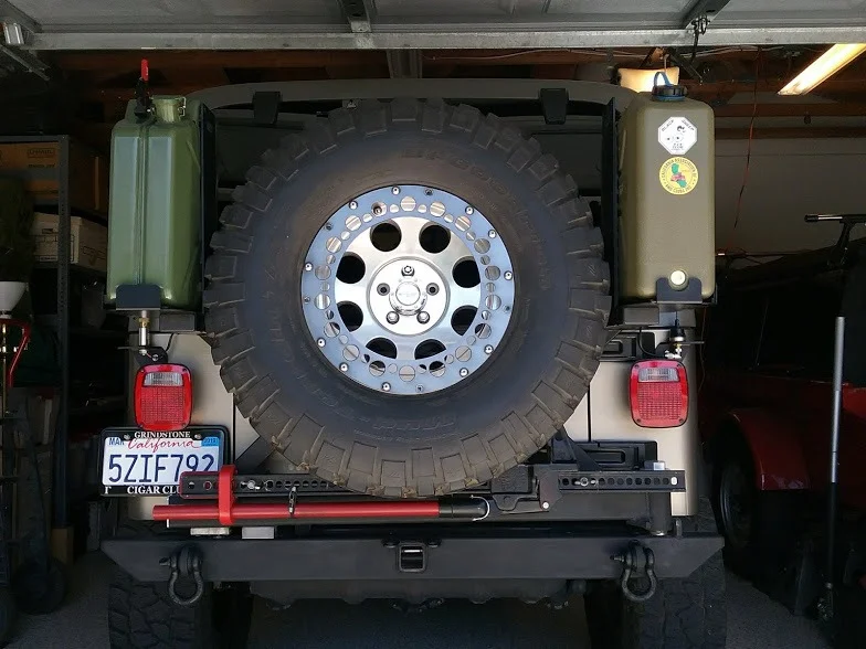

Having a hard time with the new rear bumper finding a place to place my high lift Jack. I've seen to do it from the bumper but take a look, please let me know your thoughts.
Your not likely to find many fans of a high lift jack here. They are dangerous. Carry a block of wood equal to half the height of your tire size increase and use the stock jack under the passengers seat.

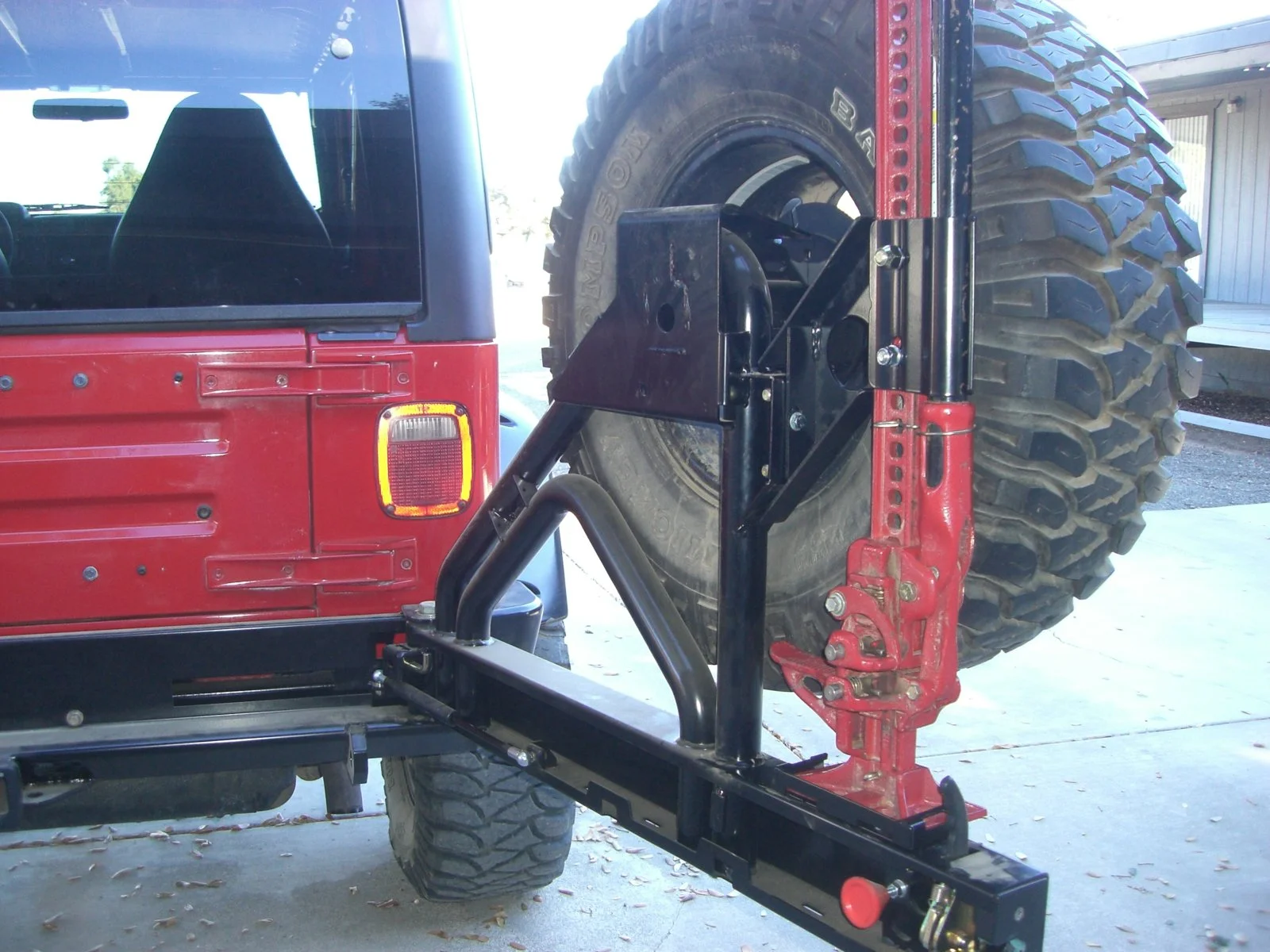

Mounted here.

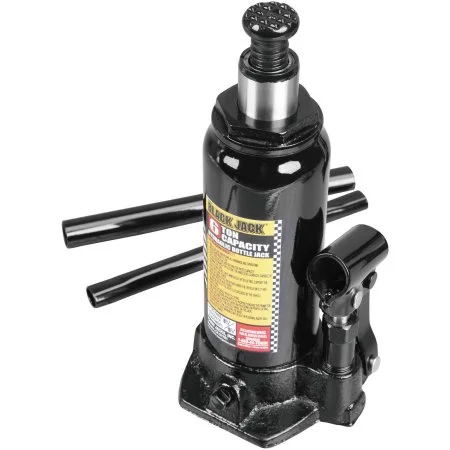

Thanks All! The hydraulic jack I had wouldn't go high enough to raise at the axel, I was doing a tire rotation and needed to get her lifted up to get onto the jack stands. I finally got creative, I used a 2x4 then stacked a ton of folded up cardboard between the jack and axel, worked like a pain in the A$$ but job done! Hope ya'll had a great weekend!

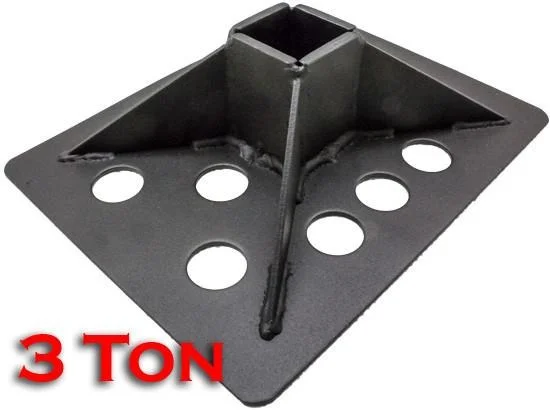

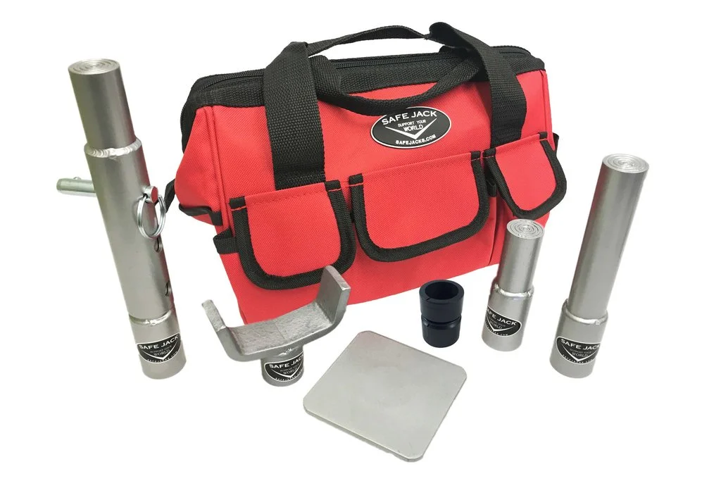

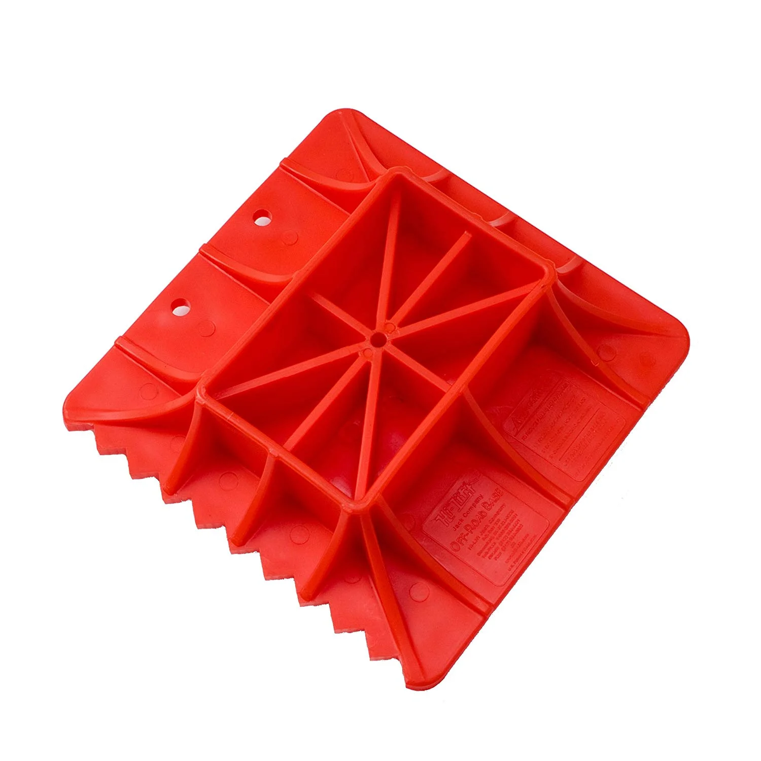

However, whenever possible I like to complete projects using only the tools I carry in the jeep. The theory is that by doing so one will always have what one needs no matter where the need arises. I now carry a 6-ton bottle jack in addition to the factory jack, Hi-Lift jack base, a set of bottle jack extensions and an offroad jack stand from Bogert Manufacturing (safejacks.com), and a few assorted pieces of scrap lumber, I can do almost everything with these compact tools that I can do with the floor jack and traditional jack stands.

Oooo!!! Mommy likey! Ya, I didn't have the extras for the bottle jack I used, got 3 wheels off the ground but then when I got to driver's side, there was not room for the bottle neck and jack stand on the axle on that side, so I had to balance it (on that tiny top, with the 2x4 and the cardboard, made a quick change on that wheel first, just in case. Thank you Mr. Bills.
