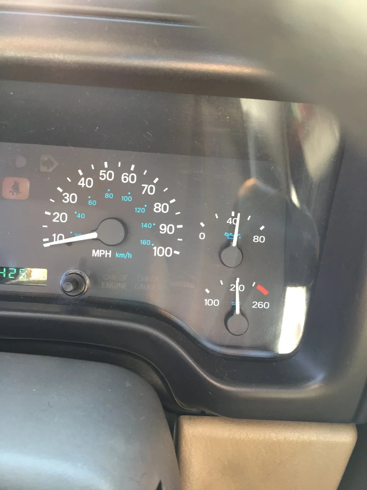

Ok but does your engine run at 210 when warmed up or at a lower temp?
Not sure. How can I tell? Sorry, I'm a newbie and don't really know much about cars. Just learning as I go and from what people tell me. I'm assuming I can tell by the temp gauge in the dash?
When I took the Jeep to the BAR Referee, I was told that one of their functions was to make sure the smog test was performed correctly. The BAR website says that the referees can perform tests that regular smog shops can't. People who dispute the smog test results they got from their local smog shop go to the referee to get the "official" result. My jeep was smogged by the referee and it failed. In fact, on their smog test, my Jeep was rated a Gross Poluter :( I'm assuming the referee knew how to run the smog test correctly, i.e. ran it at the right temp.
Look at the lower right-most temperature gauge on your instrument cluster once the engine is fully warmed up.
Hi Jerry, sorry it took a couple of days to get back to you. The temp my Jeep runs on is at 210. I took a pic of it this afternoon while I was stopped at a red light. The needle is always in the middle when I'm driving. This is my normal temp.
