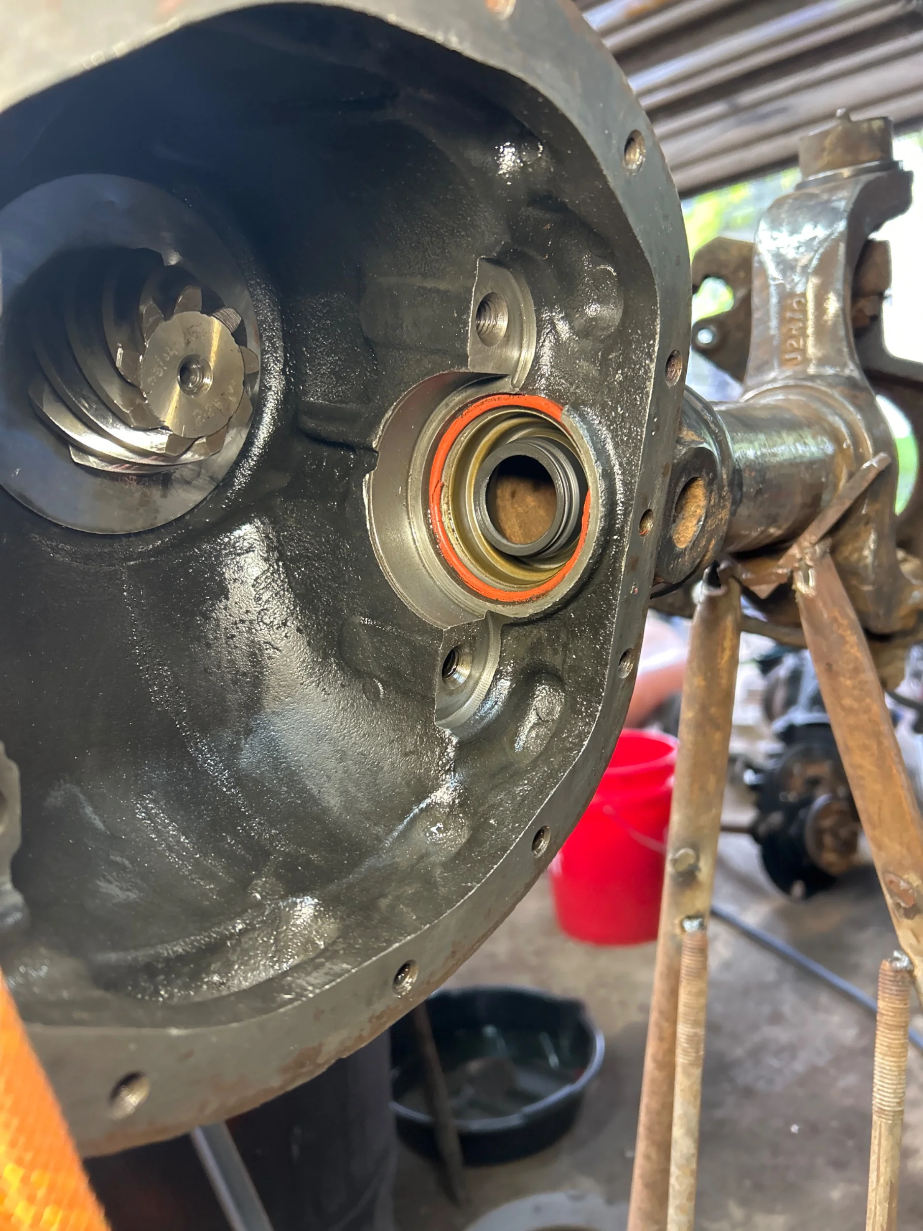

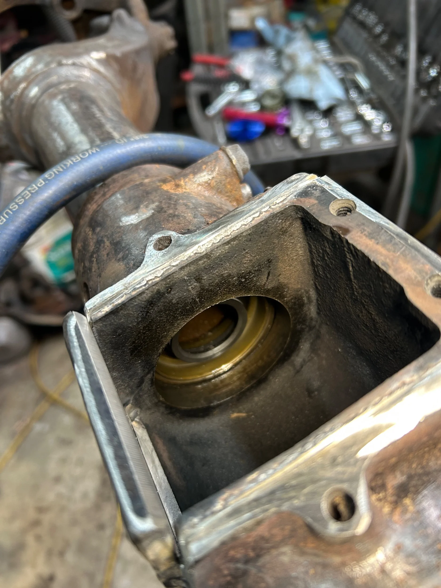

Both side are in. I’m don’t pissing with them. One went in the wheel side of the CAD. The other in the left side of the diff.
Not sure how much oil will move over there towards the CAD unit. I’ll have to keep an eye on the diff level and add to it until it finally stops flowing over there?
I guess it is what it will be for now! I’ll keep an eye on it.
I know the diff had oil in it when I put it on my stand. I know the CAD had some oil in it when I took the cover off. That might have been just from moving it around, IDK. I know the “seal” that was in the wheel side of the CAD(as pictured above) wouldn’t have held a fart in. I know it has got to be better than it was.
I cut it open once I can do it again if need be, even under the Jeep. For now I’m sealing it back up and getting to the truss kit.
Oil didn’t get down to the CAD before because there was a seal installed in the right side of the diff, similar to where the 11800 is supposed to go.
The seal you just installed will essentially not do much of anything because it is going to drag on a part of the shaft that is not meant for a seal. If oil does make it out there, it will leak.
I never tampered with the right side diff seal. It’s still in there, untouched. While I fully understand what you are stating about the outer CAD seal not sealing, I must disagree with the “not much of anything”.
I’m sure it’ll likely melt away a little bit. But dang, it’s got to be at least a small fraction better than the gaping loose seal I removed. Thanks again for your time and patience in explaining it all.

It will keep stuff from the exterior from going up the tube, at least. When I said it won’t do much, I meant because if fluid got to it, it would probably leak right past it. However, since you still have the added diff seal, so fluid should ever make it that far anyways. Should be good.
