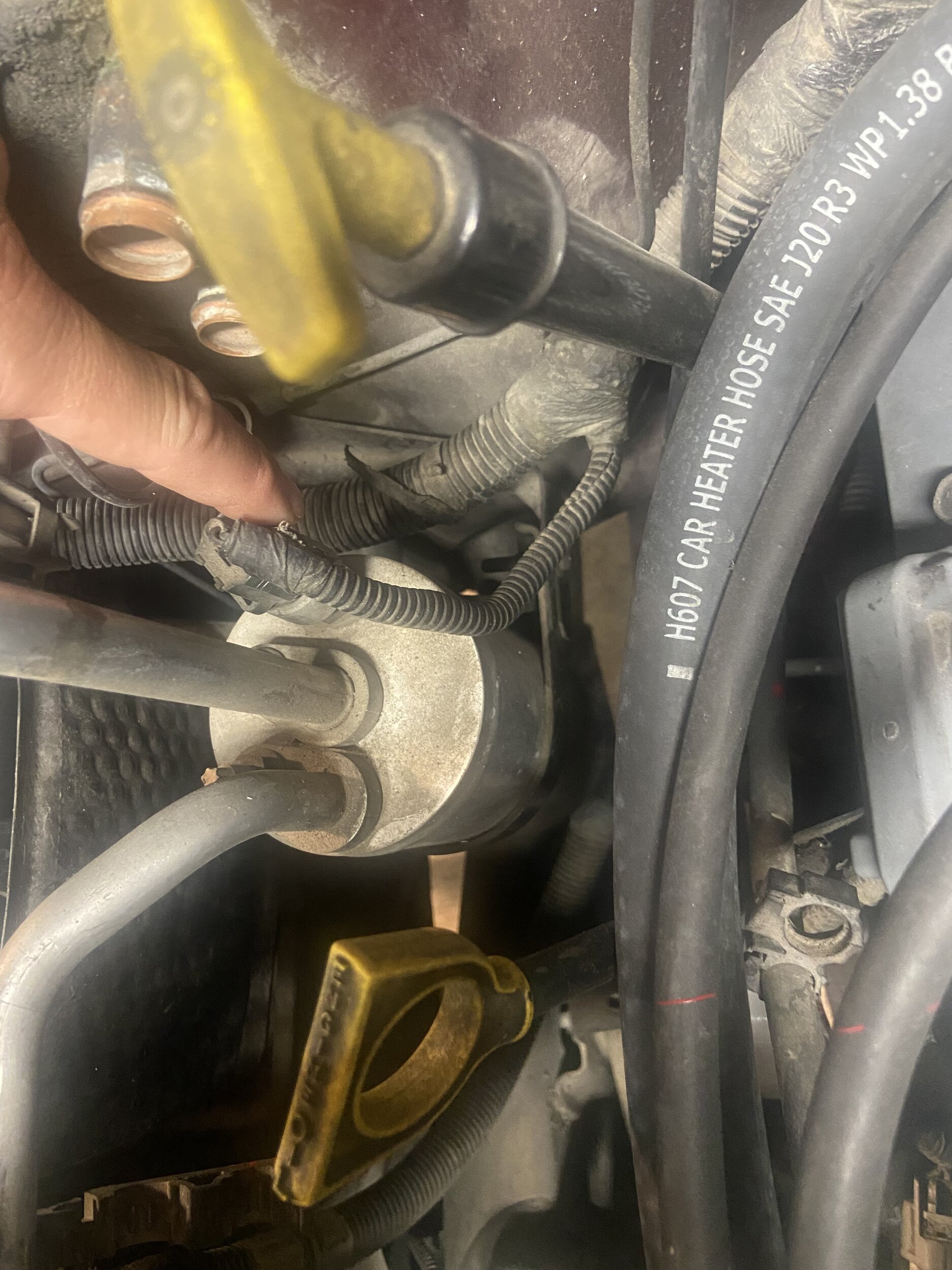

Is this the location of the high pressure switch in the pic located on the dryer?
FYI My symptoms are as follows compressor keeps turning on /off constantly blowing intermittently warm and a little cold. The gauge I used showing high pressure in system. Compressor and orfice tube replace about 5 years ago. I’m starting with the high pressure switch then go from there.
Define hi pressure, and which side did you measure? Low side should be 25-40 and high could be 150-300 depending on temperature, humidity, airflow, etc.
