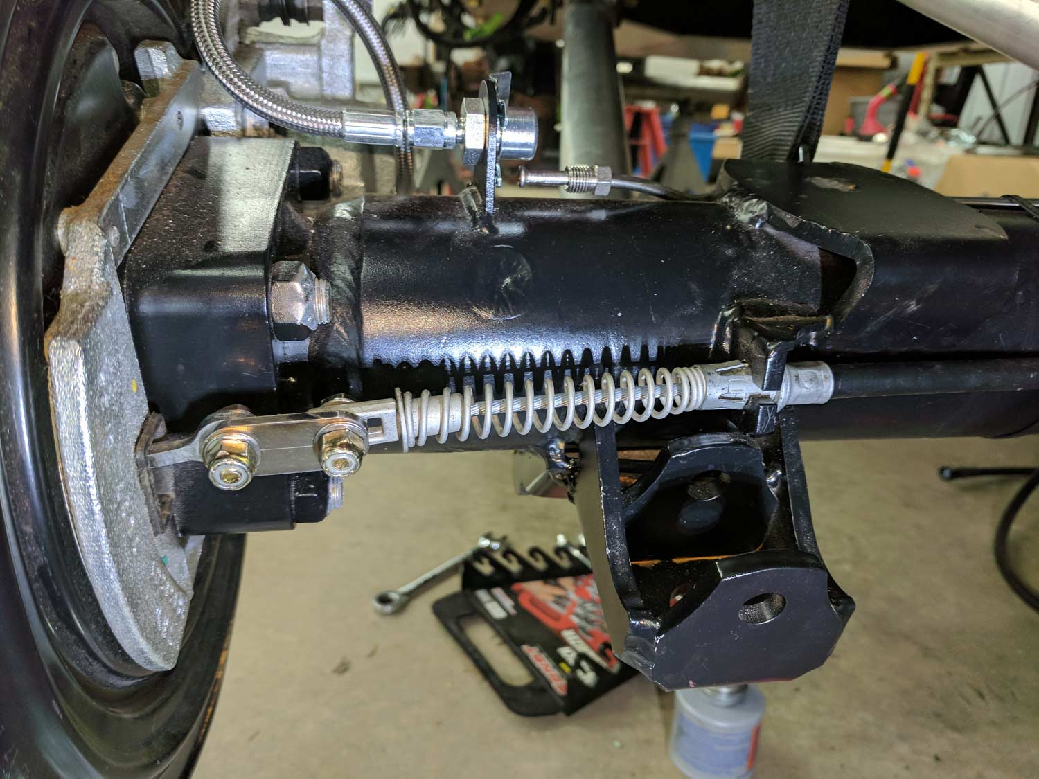

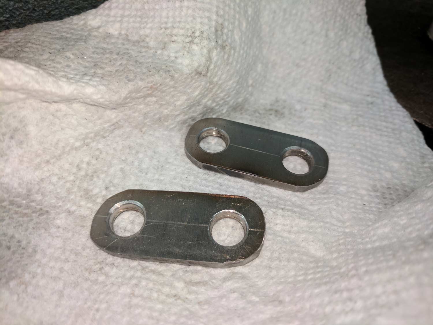

First on the agenda is connecting up the parking brake. When I started this build, this part we thought was going to be a challenge. It ended up being super easy and only a few brackets were needed.

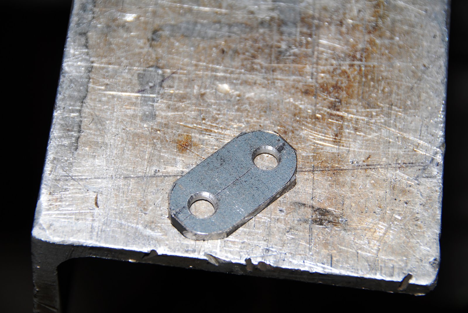

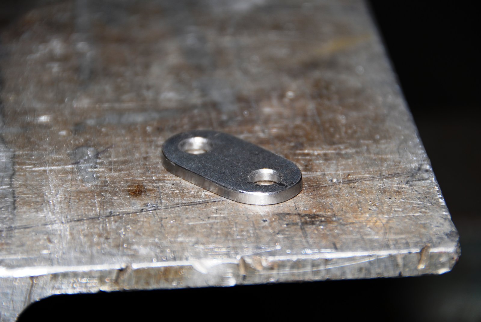

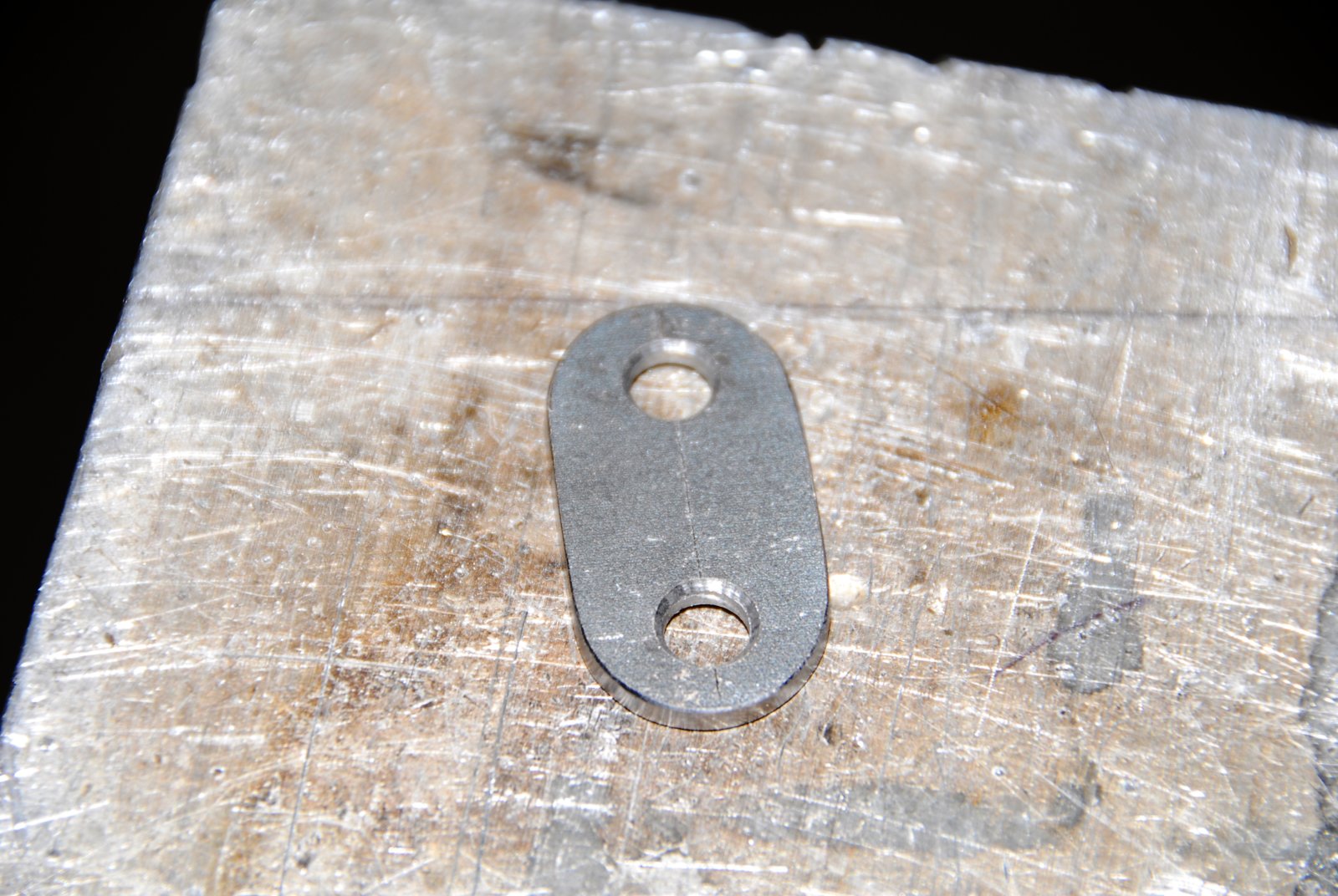

I started with a 304 stainless steel remnant. It feels great to be making chips again!
These cable adapter links were made with 1" of separation between the holes:
I previously mentioned that I made and welded on parking brake retainers. What I did was I cut and drilled a small tab of 1/4" steel and used a 3-1/2" hole saw at the bottom of them to match the curve of the axle tube and then welded a short support leg onto that. Here's a picture from back when I made them:
And here's a good look at the parking brake assembled:

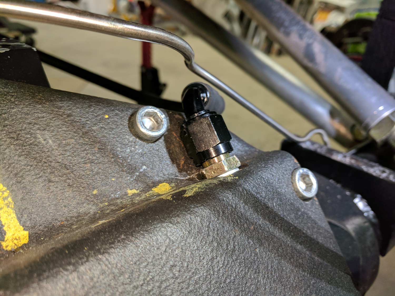

Once I got the parking brake off the list, UPS delivered the 10mmx1.0 to -6AN fitting I was waiting on. I removed the diff cover and quickly chased the threads and got the new fitting in. I topped it with a PTFE lined stainless steel hose with a 90* fitting on the near end. This solution is going to clear the bridge perfectly and at the other end of the hose I can go back to a barbed fitting to finish bringing the breather up to the firewall.

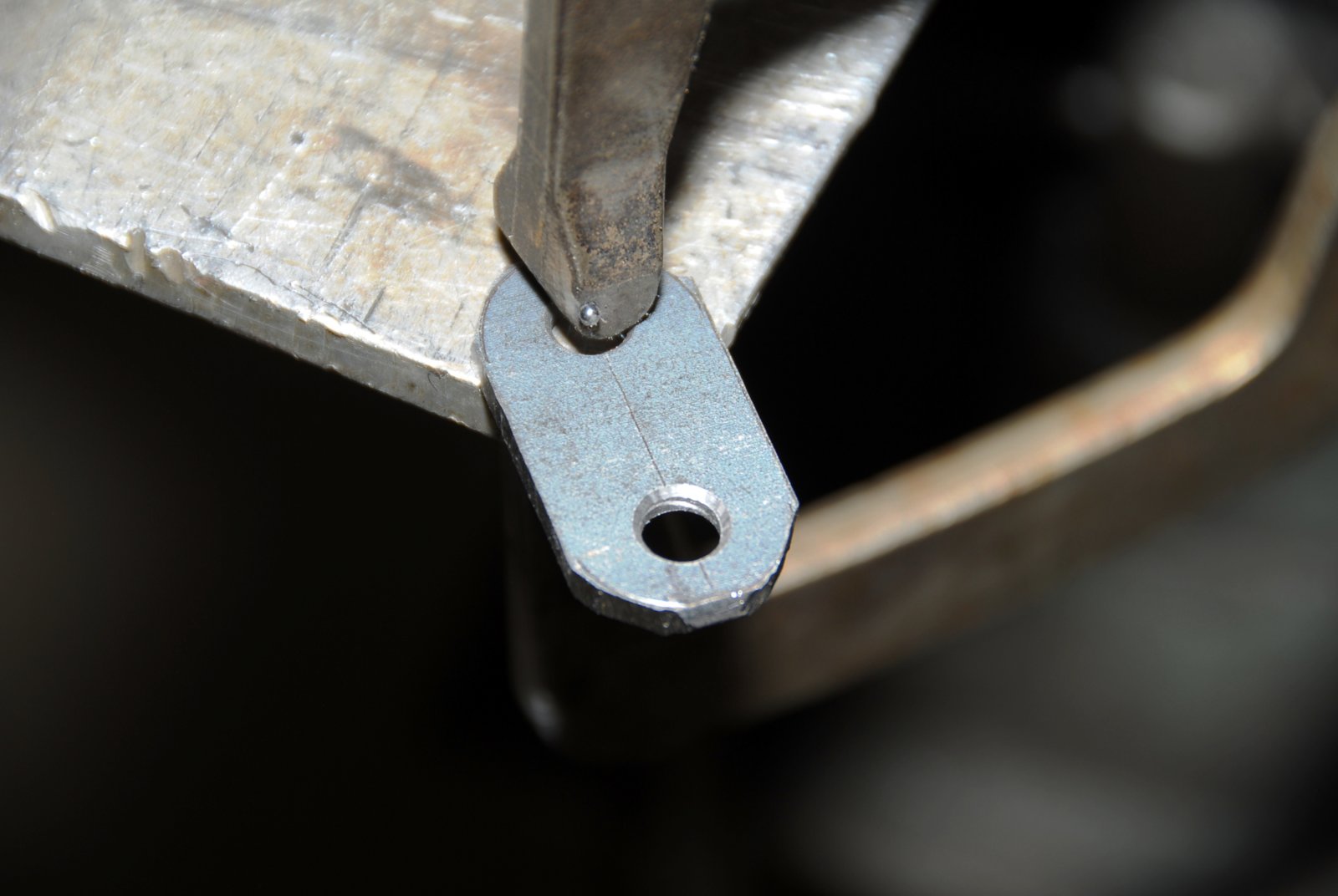

Here you go as promised with a slight delay for which I apologize.

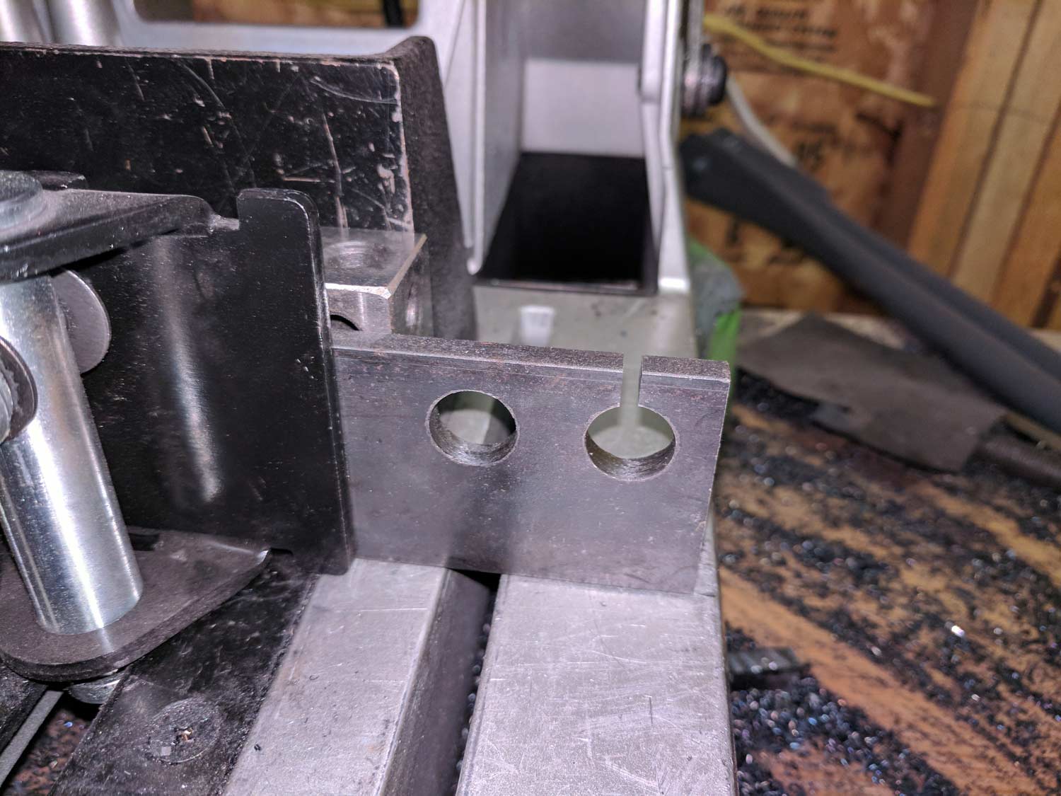

Your connecting link made with nothing but hand tools. Cut with a cut-off disc in a hand held grinder, drilled and deburred with a hand drill, finished with a flap disc in a hand held grinder.
