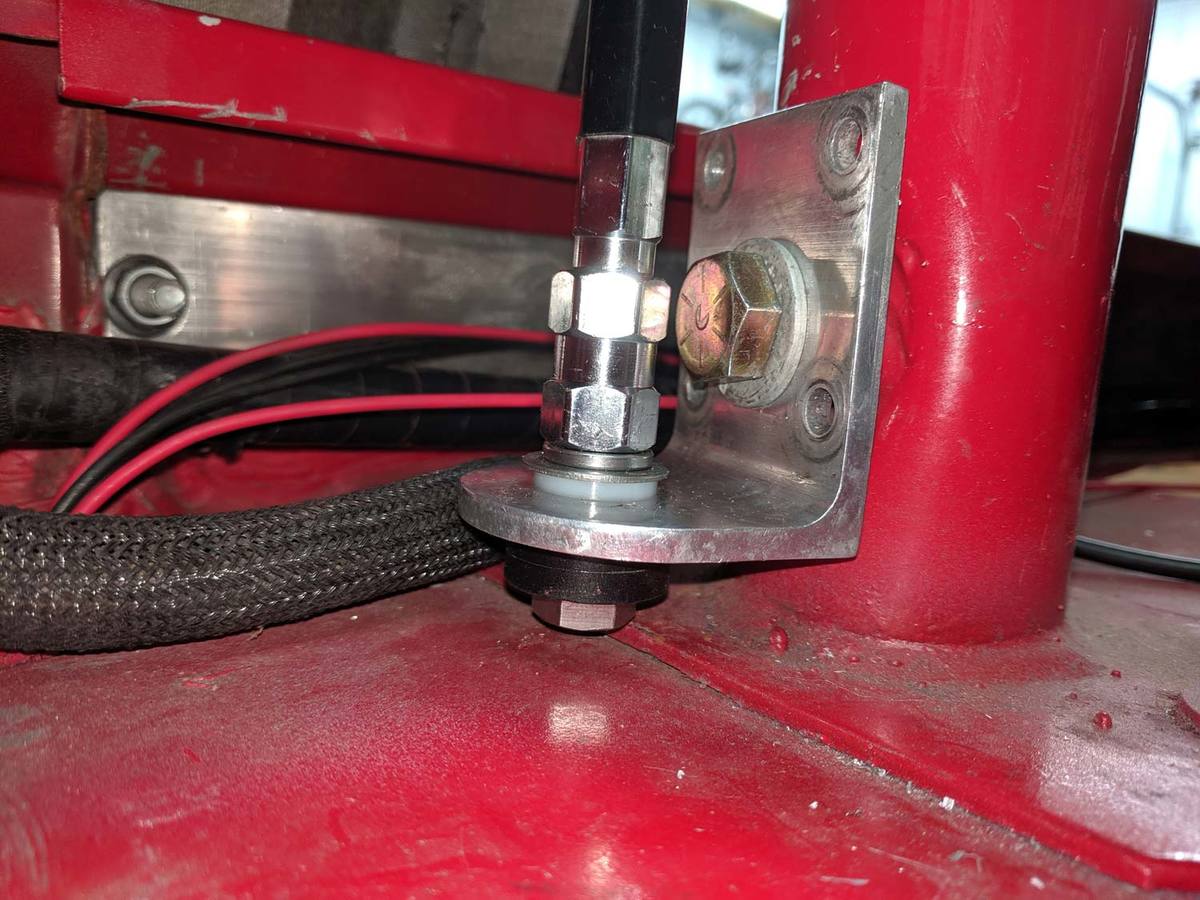

For the antenna I decided to mount it inside the Jeep off the C pillar of the roll cage. I had previously threaded the bung to 1/2"-13 for a hilift jack that I only used once, hated, and then bought a winch the next day. I was able to get the mount lower to fit the 2ft FireStik antenna under the soft top by switching the cable out for a FireRing style connector (K4-8R18). I also was able to cut the cable to length and soldered the PL-259 connector on.
Even though it'd be nice for long trips (since I plan to drive to trails and not tow my Jeep) I don't plan to at this time. My concern is that water will get under it and not escape until it rusts through and makes its own drain hole. I also don't want the additional 80lbs of it. I could live with that weight if it makes driving more enjoyable — I'd figure out a way to lay down mats instead of using adhesive to the floor so they could be easily removed for cleaning. I will be replacing the carpeting which has the thicker LJ padding.

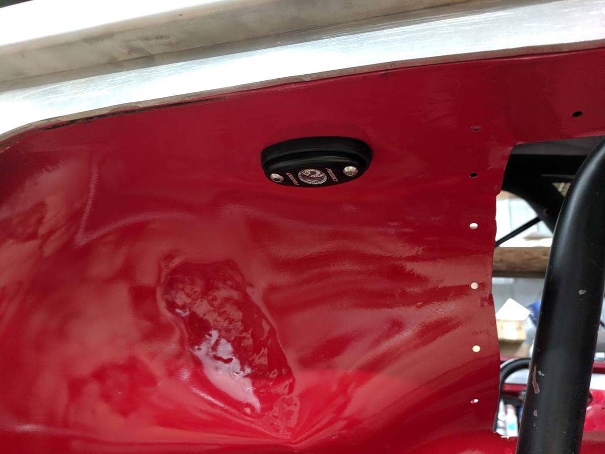

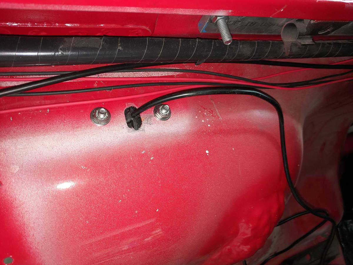

I used nutserts to attach the light to this rear location:
I mounted the tire to make sure it won't take out this light:

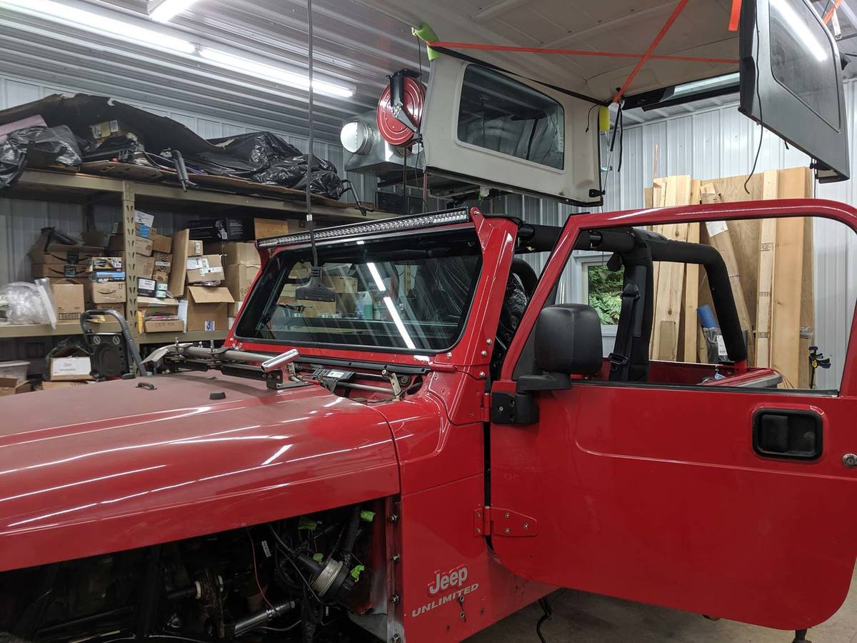

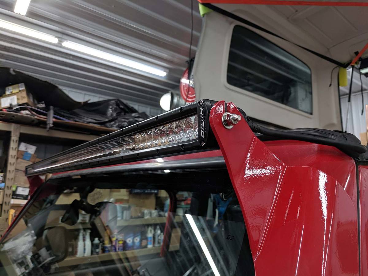

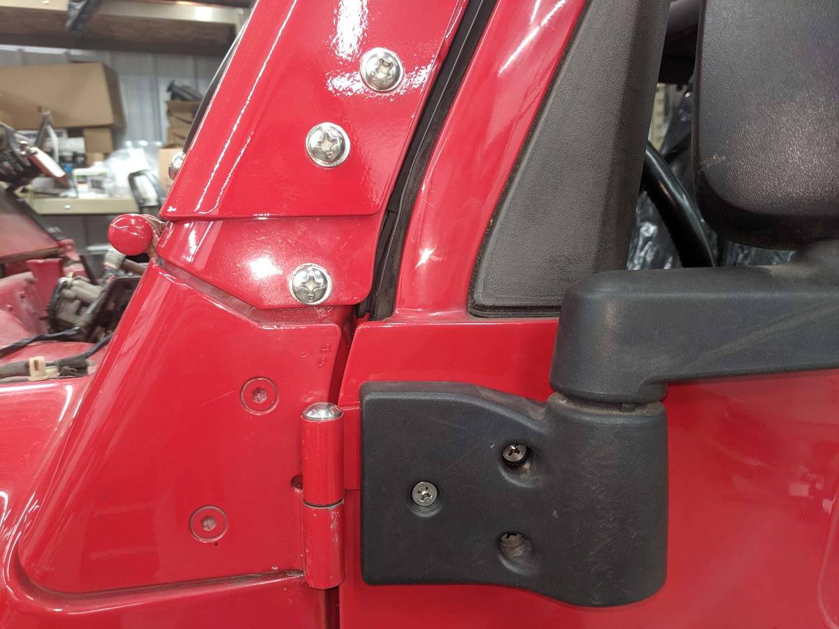

To mount the light bar I used the windshield mount from Rigid. I'm pretty sure the mount is manufactured by Poison Spyder for Rigid but they changed the material to stainless steel for Rigid. I painted them color matched red to my Jeep. The mount is honestly not a great design, but nobody makes a better design that I've seen and making something better myself isn't feasible without investing in special tooling. My ideal mount would be one that sits tight against the windshield frame the entire way up. I did leave off the pointless backer gasket that comes with the kit since this will only cause uneven pressure as the bolts tighten down.
I used 316 stainless steel button head phillips bolts with washers to attach the bracket. While I was at it, I replaced the stainless steel hex head bolts I previously had used on the doors with phillips head. Phillips allows more torque to be applied to the fastener before stripping out compared to the hex.
The power cable is routed at the top corner of the door frame. It's possible that I'll need to notch the plastic windshield trim slightly once the top goes on. From there the wire is hidden down the inside of the windshield trim to behind the dash.

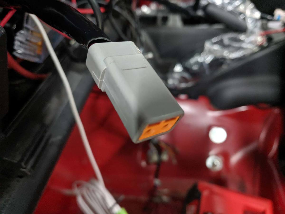

I added a plug between the wiring harness and the light bar so it can be replaced without cutting the wires in the future if necessary.
There is a good writeup about different style plugs and when to use each over on Pirate: https://www.pirate4x4.com/forum/ele...-plugs-when-wiring-up-truck.html#post25535218

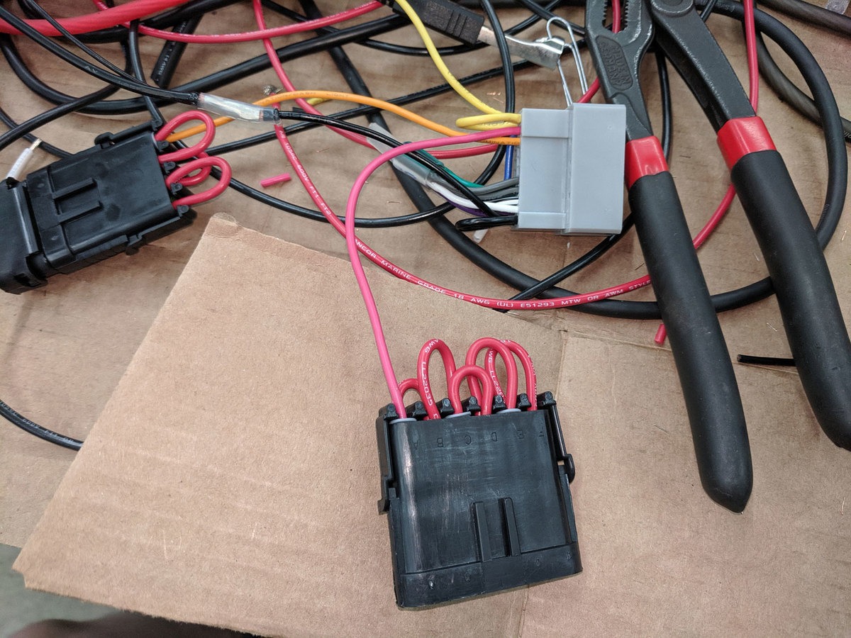

I have been using WeatherPack connectors on the interior of the Jeep since they are relatively cheap and offer good weather resistance in case things get a little wet. However they are limited to 20amps and my light bar is 25amps so I went with a Deutsch DTP connector with gold solid contacts for the light bar. This connector is rated to 25amps. By going with the gold contacts vs stamped I hope I'm able to fully reach the connectors rating and not cause any resistance in the connector especially as things age.
Outside of the Jeep I plan to use Deutsch connectors instead of WeatherPack since they offer better weather protection and I think they look cleaner.
Crimped:
Connector:
Light bar plugged in:

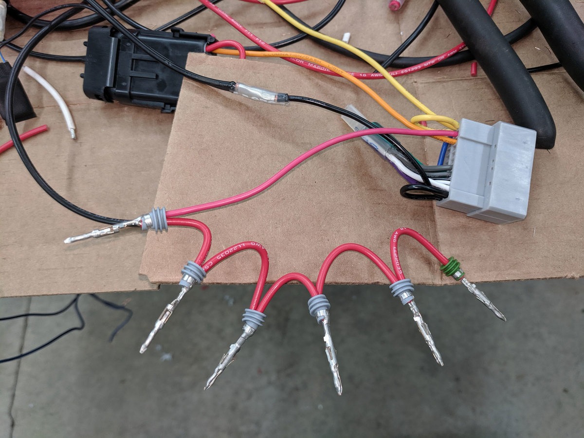

For the ACC power I made my own weatherpack connector buss on the radio harness. Everything that needs to be tapped into this area only requires a crimped pin which makes disassembly easy with no cutting. I did the same for my dash lights (although that's only used for the ARB compressor switches).

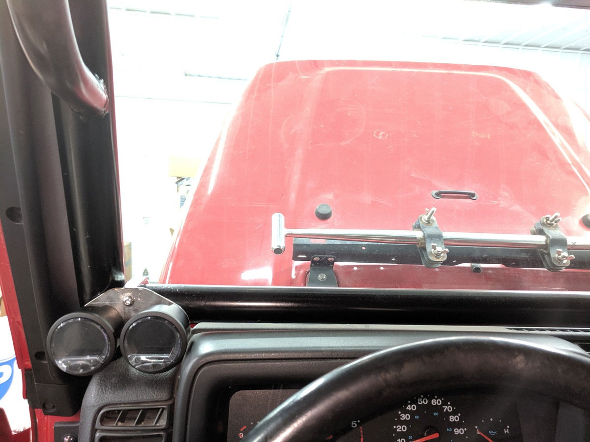

The boost and AFR gauges fit between the door and raised dash area via custom made aluminum bracket:

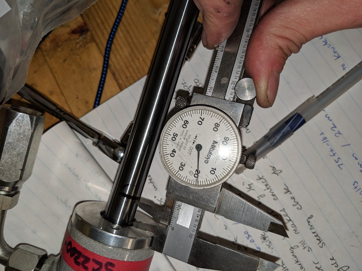

Question on setting ram internal stop. I did the method PSC recommended by scribing line on tie rod with square at left and right full turns and yielded 6.050" stroke. Then I installed my ram collapsed at full left turn and turned full right then put a sharpie mark on the ram rod. I then uninstalled the ram and extended rod showing .520 from the preset 6.5" that PSC stopped to. Which equates to 5.980" stroke. I was going to have PSC make me a shim. So you think the sharpie and measure method is accurate enough?

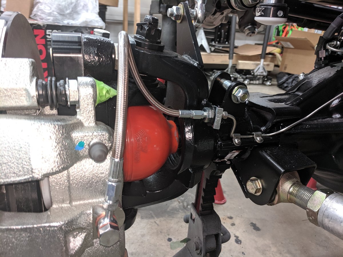

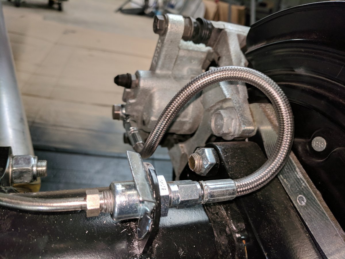

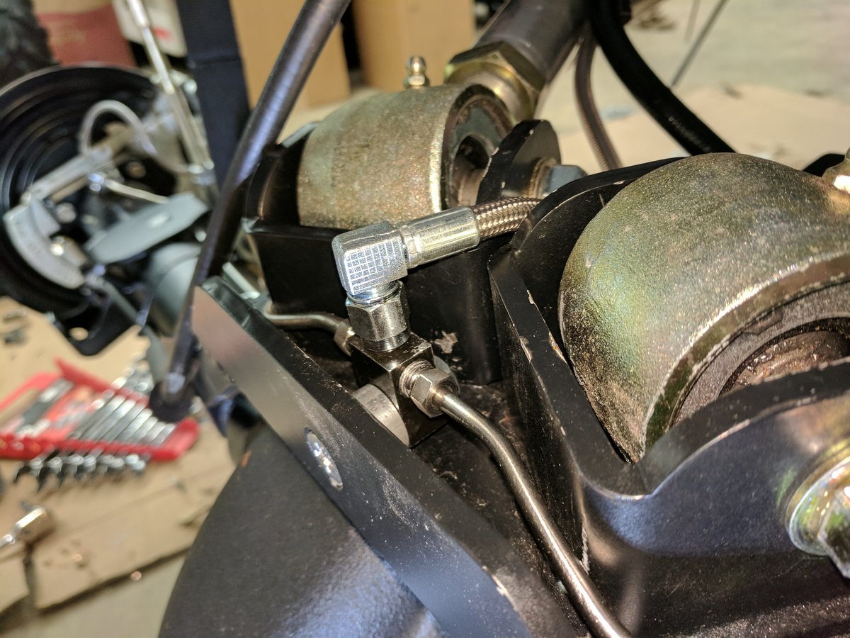

I'm going to copy your brake line upgrade for the front. Can you explain why your blocked off a port and how to check what exact line to order? I'll search more for your follow up posts on what flex lines you used.
For the brake lines I decided to run the front lines down to the axle along the UCA (much like how the rear stock lines run). This is cleaner, less to snag on branches and trees on the trail, and with 14" of travel doing a drop is a lot of line hanging. I removed all of the stock lines on the frame.
There are a few different models of the brake distribution block with different fitting sizes if you find this post from searching I suggest you check your own block before ordering parts. On my distribution block there is a ORB union on the rear most port that goes to the front passengers brakes. I won't be needing it and I plugged it with a stainless steel 1/2"-20 ORB from Brennan Industries (6408-05-O-SS). I then bent up new 3/16" annealed stainless steel brake lines with stainless steel inverted flare tube nuts. Eastwood's brake flaring tool is a huge asset when doing the inverted double flare on each end.
At the other end down on the frame for the front and rear I used a 3/8"-24 inverted flare tube nut to terminate the hard line and a inverted flare to -3 AN adapter fitting (Aeroquip FBM2936) so I can run AN flex line down to the axle (more on that later once I get to it). The adapters are held in place on the tabs I welded to the frame earlier.
The port gets blocked off because the T is moved to the axle housing to split the lines to both sides. The port that is blocked off is one leg of an internal T in the combination block. Both frame mounted front brake lines get removed except for a short section that is bent over to the firewall to end just outboard of and slightly even with the pivot on the upper control arm. That is so a flex line can be connected to it to run down the upper arm to the relocated T to run a line to each caliper.

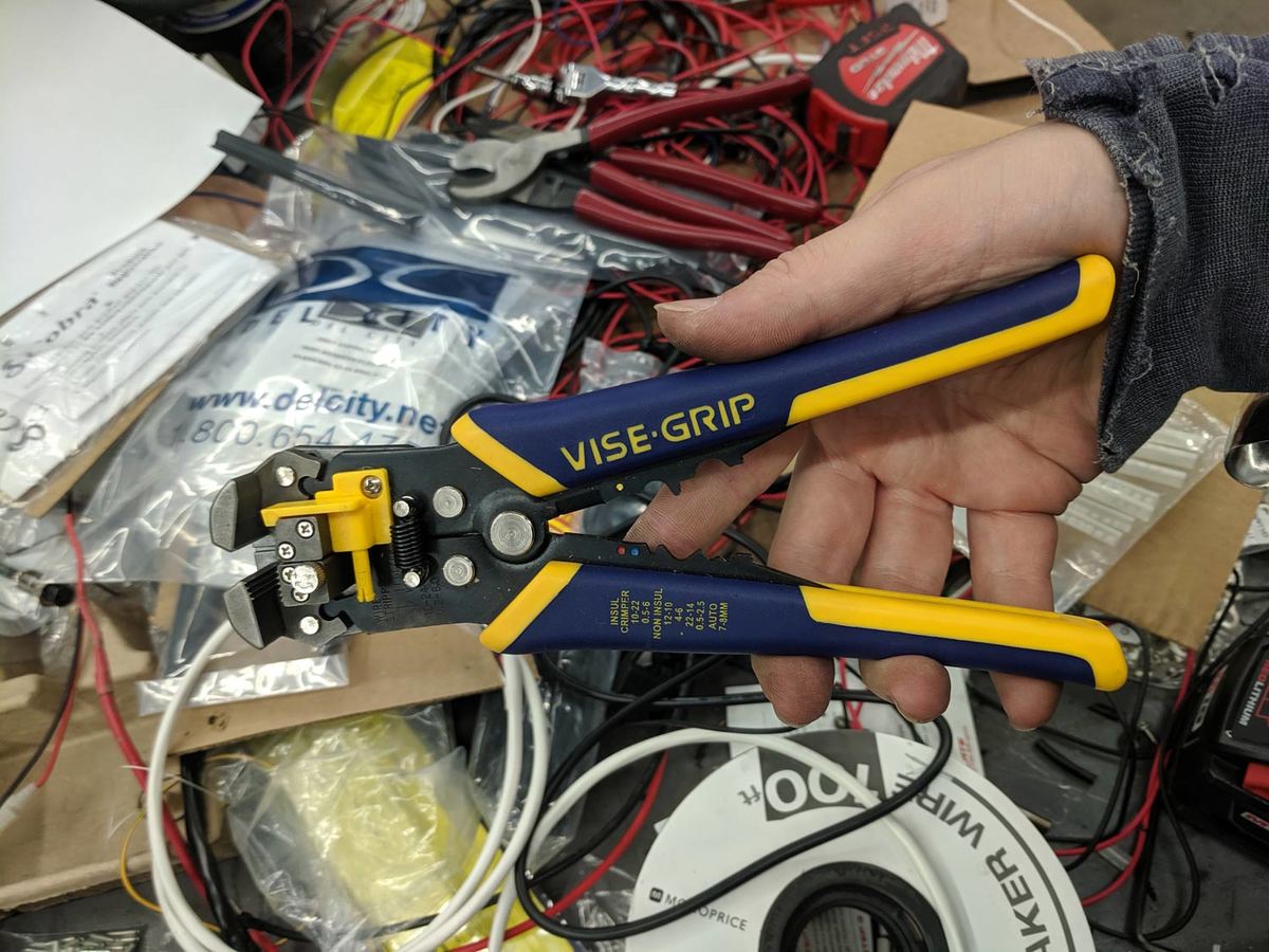

5) Having an automatic stripper saved a lot of time. https://www.amazon.com/dp/B000OQ21CA/?tag=wranglerorg-20
I verified my shim by turning to the knuckle stops and fully extending/compressing the cylinder and bolting it into the bracket. For me the sharpie mark was dead on perfect.

My sharpie mark wasn't perfect but very close. Just enough if I wiggle the bolt it aligned the rod and clevis.
You got a pic of your front axle softline to Hardline connection?
https://wranglertjforum.com/threads...e-adventure-lj-story.9956/page-10#post-212418
https://wranglertjforum.com/threads...e-adventure-lj-story.9956/page-13#post-259023
https://www.eastwood.com/eastwood-pro-brake-tubing-flaring-tool-with-45-and-37-degree-die-set.html
https://www.eastwood.com/3-16-stainless-steel-brakeline-tubing-20ft.html (Copper nickle or similar is way easier to work with than SS)
Note Blaine's comment about flaring for AN instead as that's an improvement.
All of my flex lines are from Fragola since I have a thing for their coated lines. (Almost) all of my fittings are from Aeroquip. Cheaper and house brands may not be formed correctly and brakes are not a place where I'd want to loose performance.
