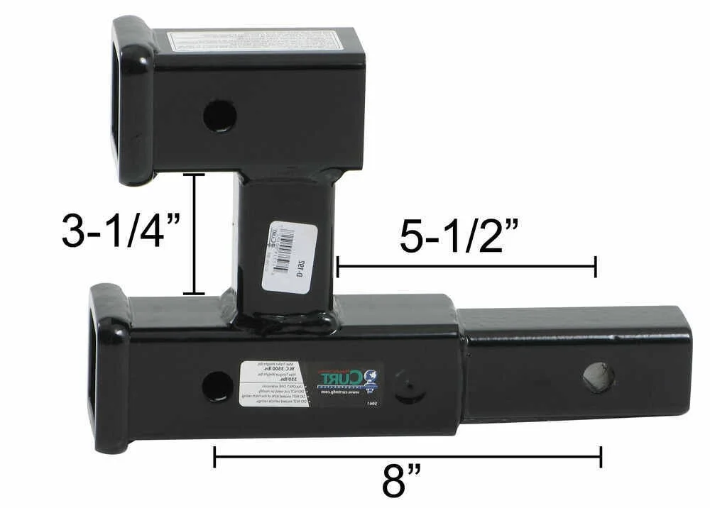

If they're lighter accessories, like a small cargo carrier or bike carrier, you can use a receiver splitter, like this:
Just don't put too much weight on it and especially don't tow with it.

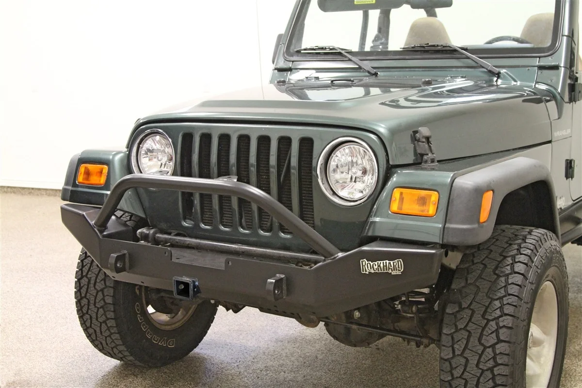

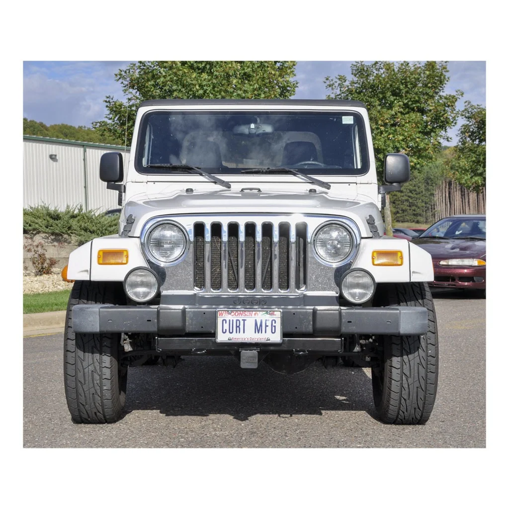

A front hitch receiver that either integrates into the front bumper or mounts just underneath may be better suited to your needs. You can run a lower profile accessory such as a cargo carrier or fishing pole carrier on the front, and a bike carrier or large cargo carrier on the rear.
Running front and rear accessories will help with weight distribution and high speed stability, especially when towing.
Integral hitch:
Under bumper:
