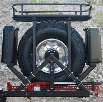

You might also consider one of the over-the-tire racks.
Here's an example (tank mounts are separate):
I like the one in this photo because it's decently sturdy and adjustable height
(Rock Hard 4x4 "Rock Rack").
There are some other good ones out there too.
