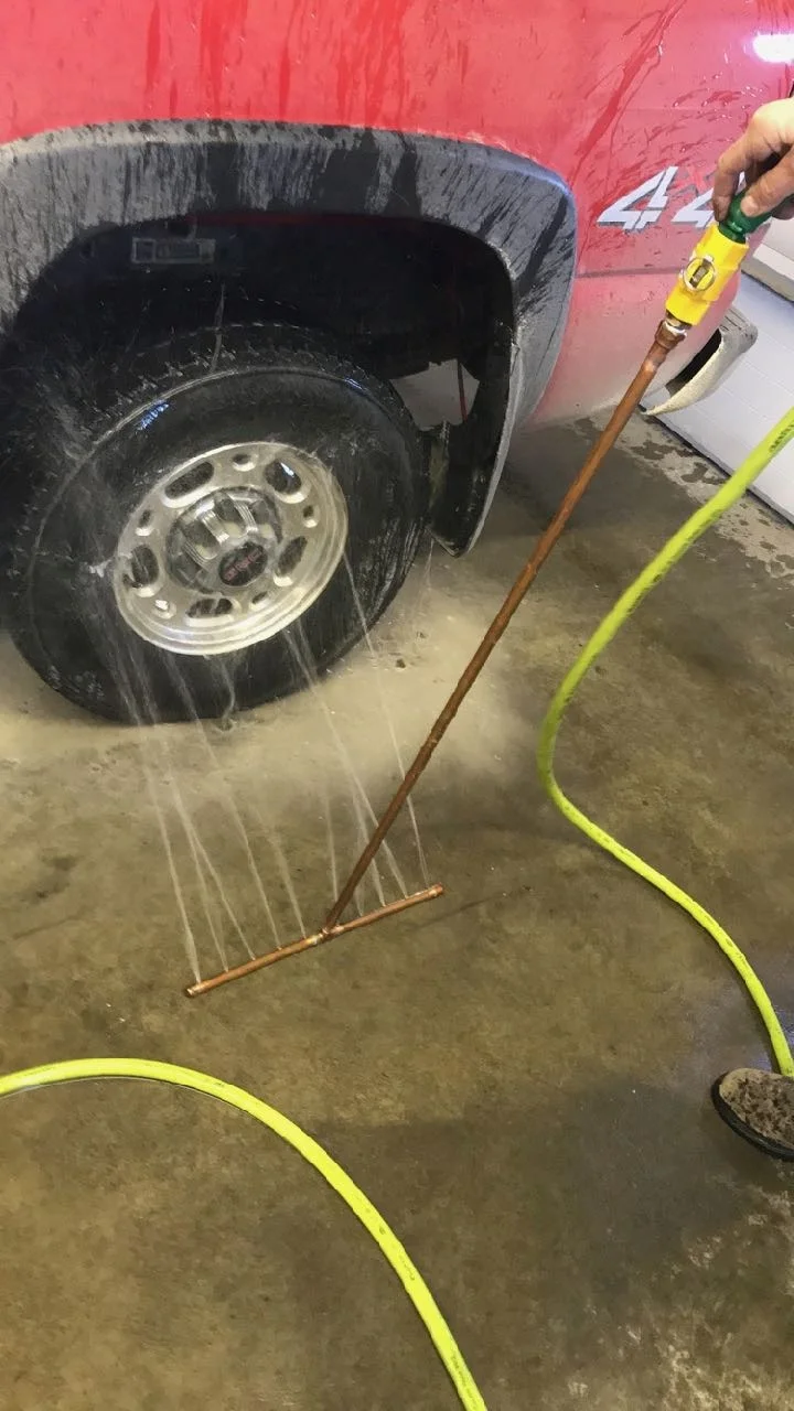

    Seems like they are salt happy anymore. Cant have any slick surfaces....even if it's getting up to 50º degrees. Bridge might frost....spray it with chloride. They didn't stop spreading salt here until mid April.
    I have a sacrificial truck (anode) for the winter pictured otherwise I keep the nice stuff in the garage.
    We did make a "wand" out of copper to rinse the underside. It shoots up about 8'
    Bought this truck new in 2003. The rockers are gone. the cab corners are gone. And the body behind the plastic wheel well is shot.
