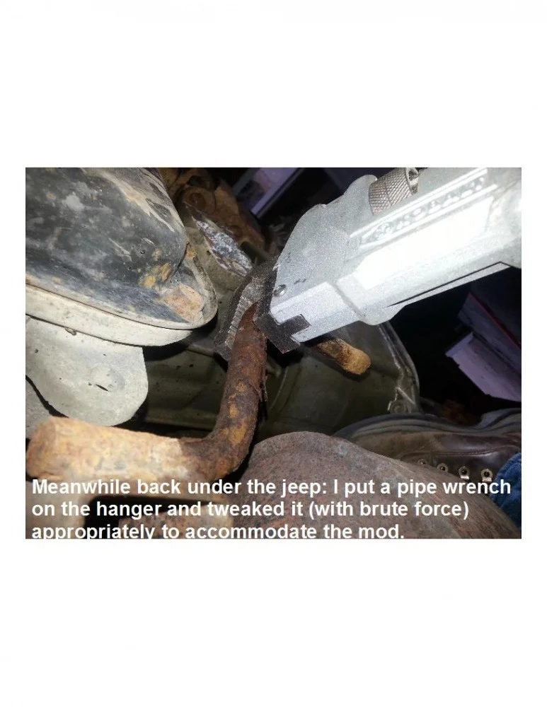

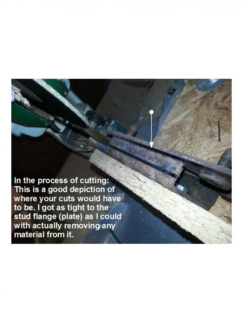

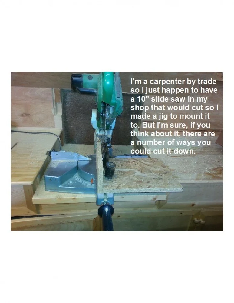

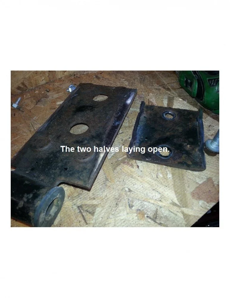

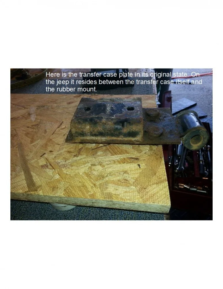

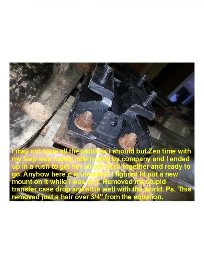

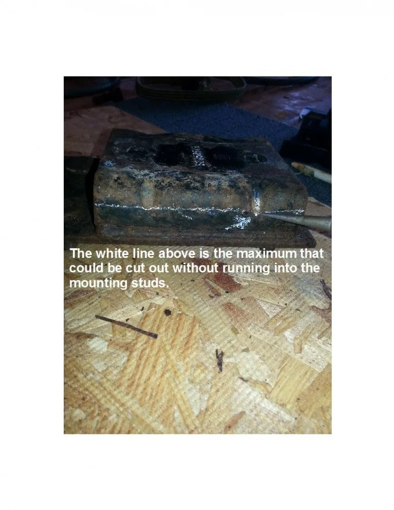

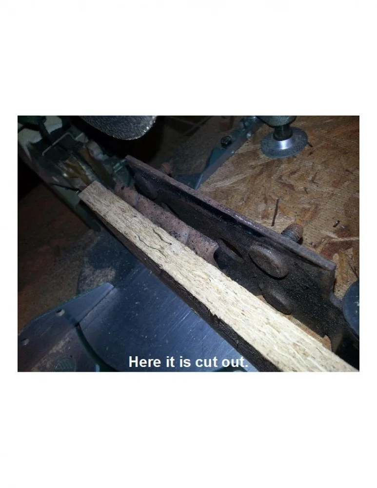

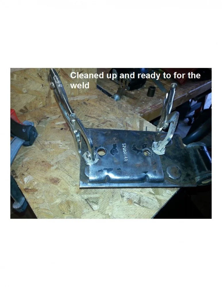

Here is said mod (wish they had used better photos):
Jeep Mod Pic 1.jpg Jeep Mod Pic 2.jpg Jeep Mod Pic 3.jpg Jeep Mod Pic 4.jpg Jeep Mod Pic 5.jpg Jeep Mod Pic 6.jpg Jeep Mod Pic 7.jpg Jeep Mod Pic 8.jpg Jeep Mod Pic 9.jpg
Reactions: derekmac
If you are installing a low profile skid plate, you usually need a body lift so the transfer case won't hit the tub. A low profile trans mount lowers the transmission/transfer case, so you don't need a BL.
Another reason would be if you installed a lift and are getting driveline vibs. Instead of dropping the skid plate with spacers, the mount will lower it enough to get rid of the vibs.
