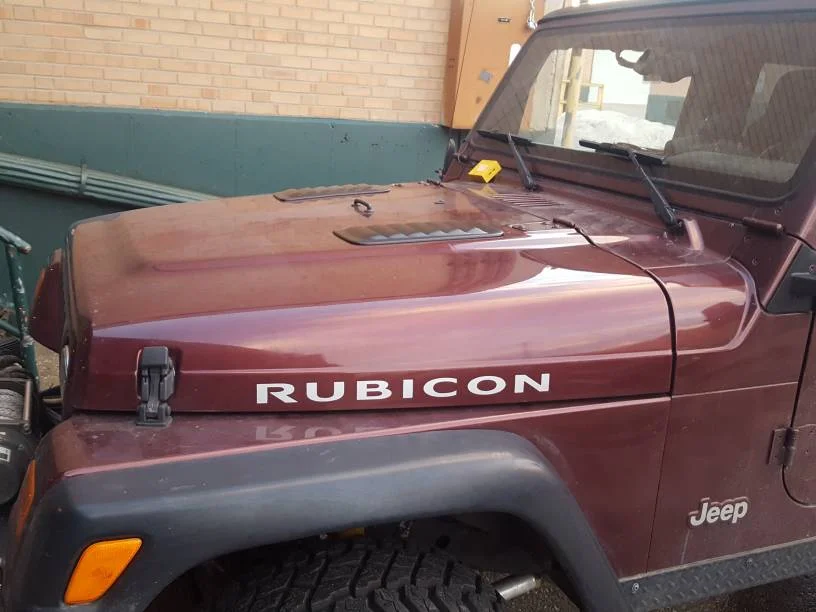

Today when I got home from work I went to check my air filter and noticed it was HOT under the hood.
Does anyone make fender vents or hood vents to help cool the engine compartment down?
There are all kinds of vents/louvers available. Here's one from Poison Spyder:
Not really my thing. I think I would use something off another vehicle, like a hood or fender vent from a GM product (Grand Prix, for example). Looks more "factory" when installed properly, and cheap from a wrecking yard (if you can find one). And there's always the old school way of doing it. Have a shop that customizes cars punch the louvers directly into the hood. It'll be expensive, because you'll also need to repaint the hood, but it'll look bitchin'!!! :cool:
... And there's always the old school way of doing it. Have a shop that customizes cars punch the louvers directly into the hood. It'll be expensive, because you'll also need to repaint the hood, but it'll look bitchin'!!! :cool:
Hot rod louvers would look the best. I've only seen it once on a TJ.
You're trying to solve a problem that doesn't exist.
It's supposed to be hot under the hood. Adding hood vents won't improve your performance or anything like that.
If you're doing it for looks, I totally understand. Just don't do it with the impression that you'll gain anything performance wise, because you won't. Cooler engine temperatures don't equate to anything.
Only putting this out there because some people seem to fall for the myth that making your engine run cooler will some sort of performance gain... which it will not.
