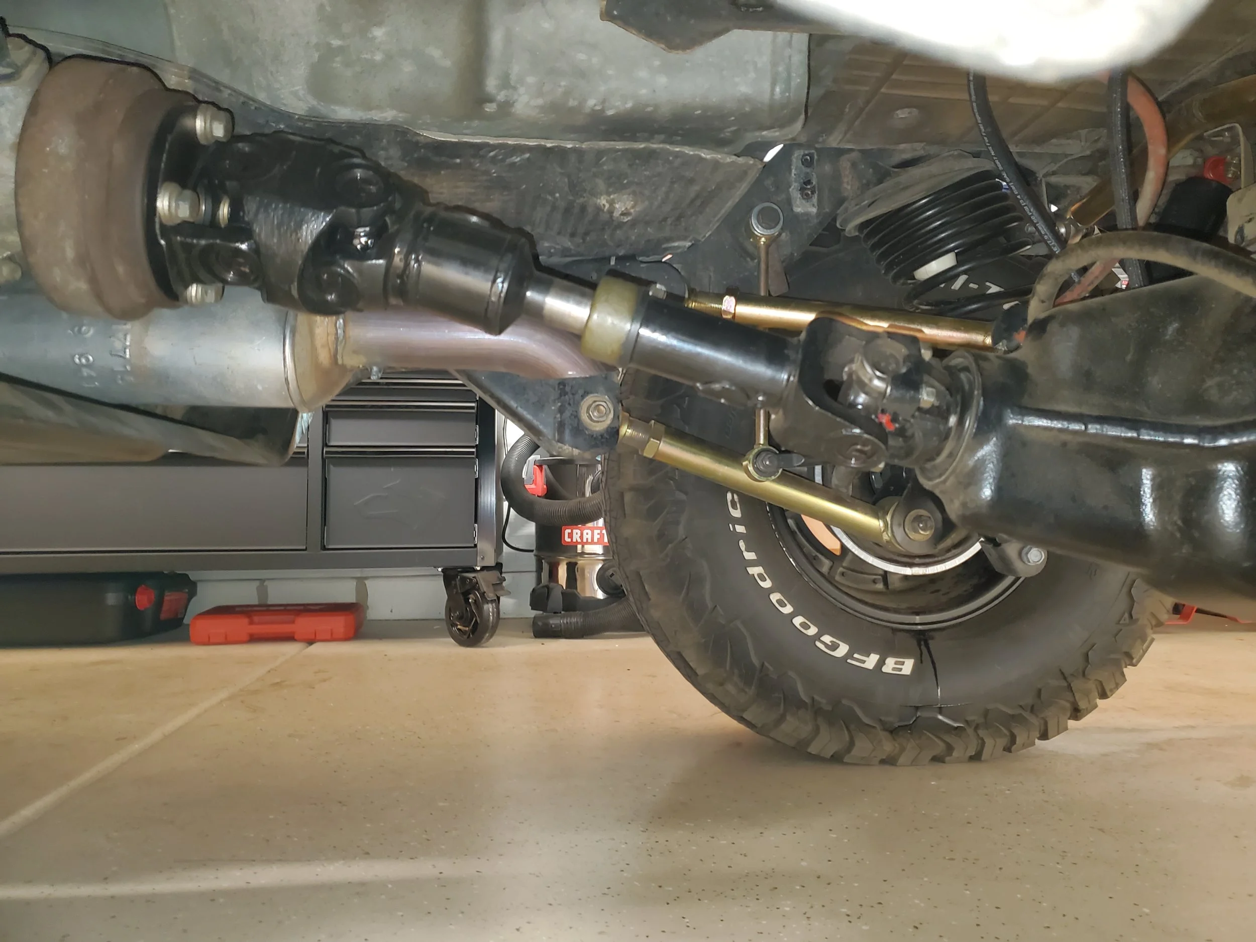

How Bad Are My Rear Pinion Angles?

I adjusted my rear axel 2 weeks ago as far as I could before I'd interfere with my shocks to get close enough to the transfer case angle. I'm pretty much where I can live with the tiniest bit of vibrations. It has however smoothed things out drastically. I also have my belly flush to the frame and have a 241 case with a 4" lift.
Metalcloak sells a nice set of bolt on shock bracket extensions...
