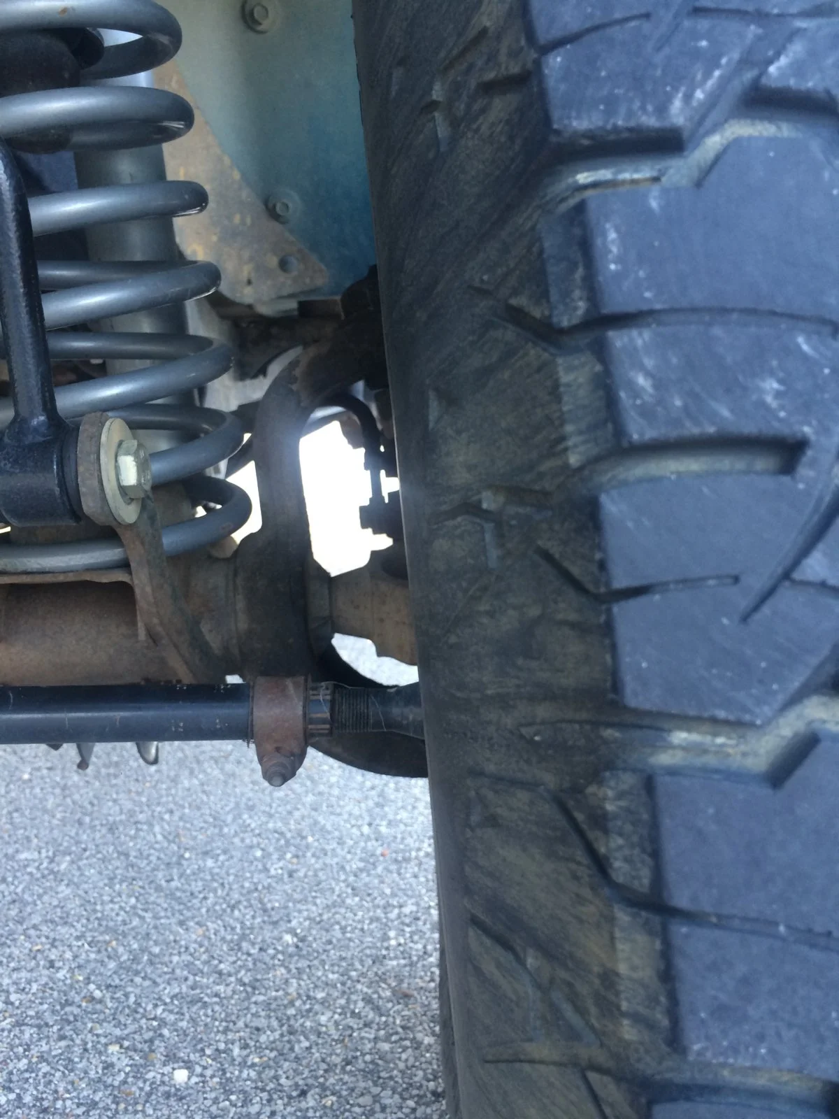

my driver front side C knuckle that's welded on the axle has bent. Does anyone have any suggestions on how to fix it?
Id rather not replace the entire axle. It's still drivable but it's very noticeable
The C is replaceable but it's gonna have to be done by someone who is a good welder who is used to performing axle repair work. If you're in SOCAL I have a recommendation.

Take it to a competent welder and they can weld a new one on for sure.
Some guy said they could just heat it up and bend it back, should I just put a new one on instead?
Probably cheaper to just buy a used housing and swap the whole thing.

Does anyone know where I can buy a replacement C? I haven't been able to find one online anywhere but maybe I'm not looking in the right places.
Also, if I do buy a new C and get it welded onto my axle, are there specs on where/how it is to be welded?
