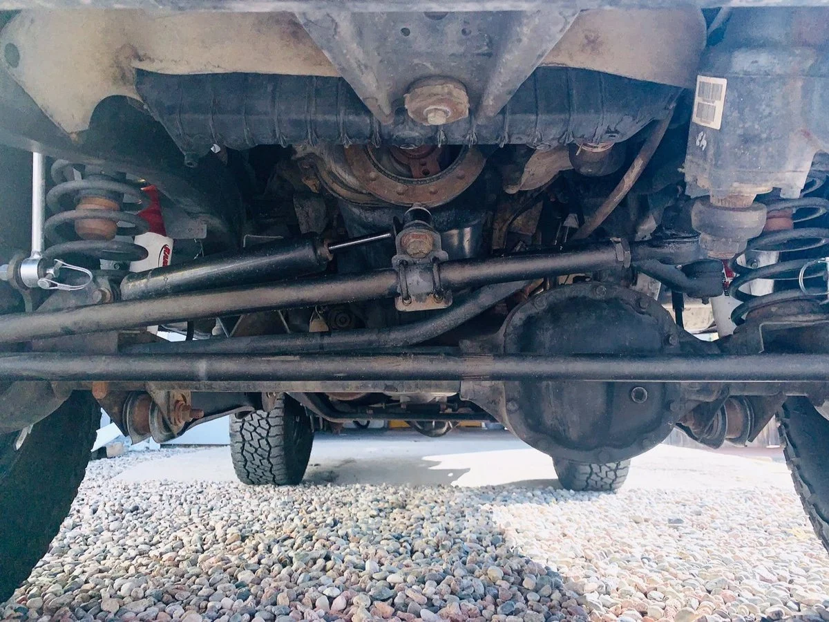

Based on pics that I’ve seen from some TJ’s for sale on this sight I’m thinking it’s stock. When I bought the Jeep 6 years ago it was stock TJ with some upgraded options. I took a bunch of pictures for if and when I post it for sale. Here’s a pic of my front end:

It's any number of crossover type steering that is different than the stock geometry.
