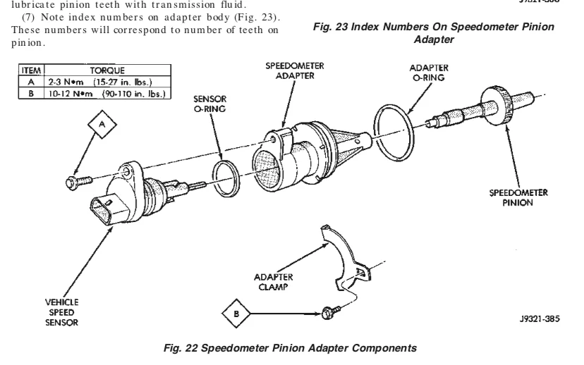

The speedo sensor is actually 2 pieces, and there's another o-ring on the inner piece...which you don't even realize is a separate part until you do the work. I had a leak in the same spot and it was resolved when I replaced it. This is from a 97 from it's similar on other years.
