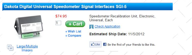

They do still have it, I was looking at getting it because I liked the Bluetooth for calibration with my phone, no need to press buttons or turn screws on the device itself.
https://www.dakotadigital.com/index...id=1192/category_id=287/mode=prod/prd1192.htm
My apologies, this is the one I've used previous. I've not been able to find it and the replacement is untenable.

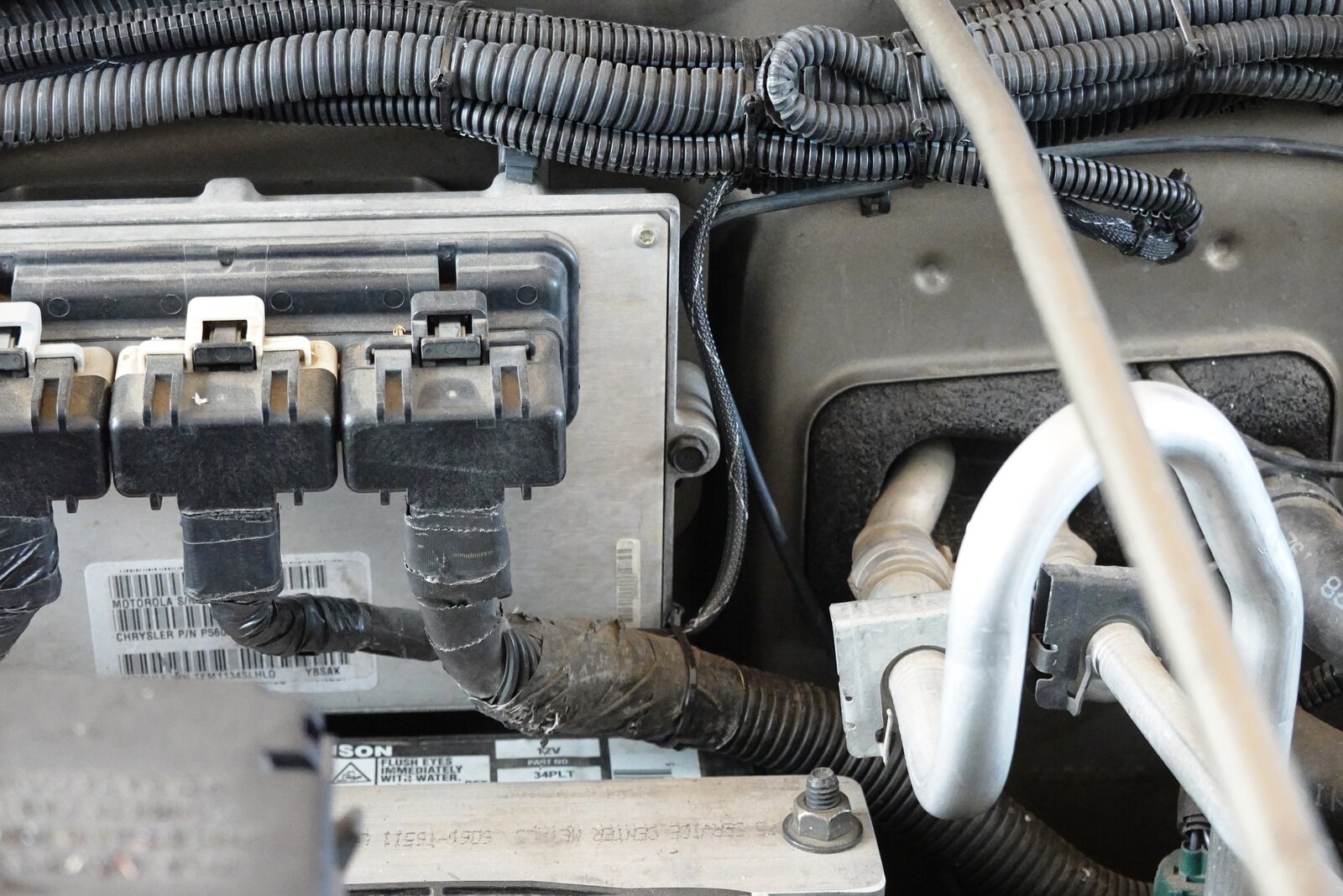

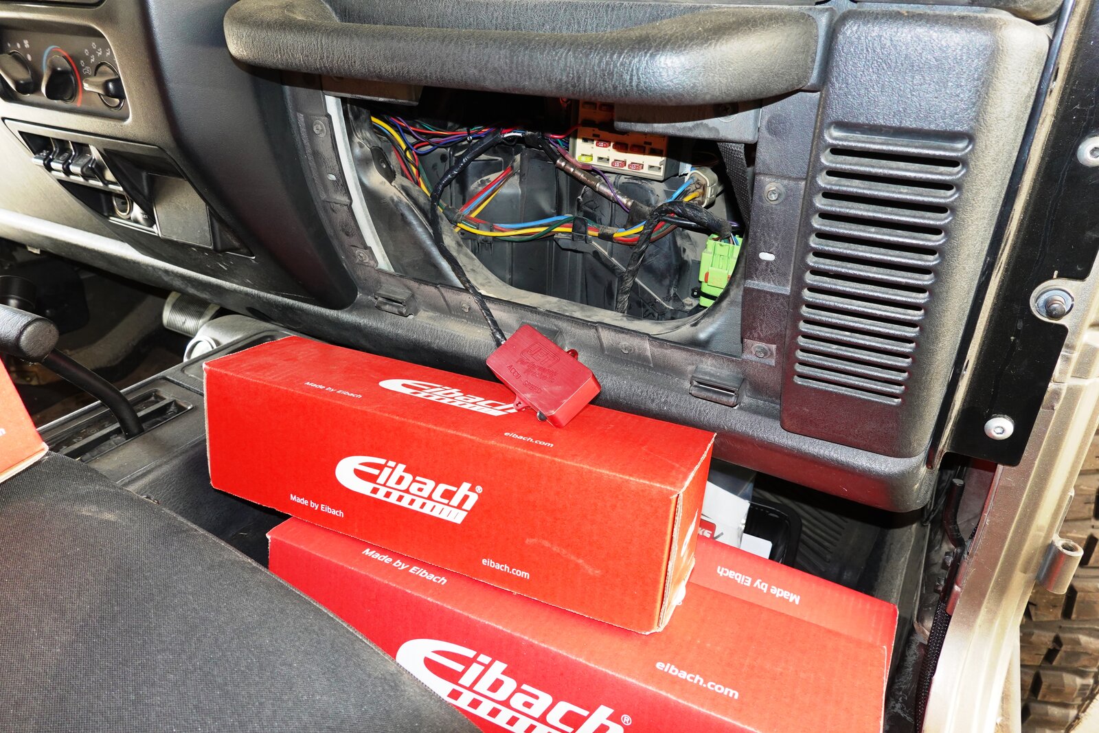

Since the elegant part seems to be underappreciated, here is what it looks like when done the way we do it. At the firewall, small braided loom is the tap into the PCM harness. The folded back loom is the connector for the old hood light.
Length of loom we run out for adjustment by the passenger while driving.
Fuse tap and a the spot where we tuck the box after we're done. We wrap it in foam sheet so it doesn't rattle.
