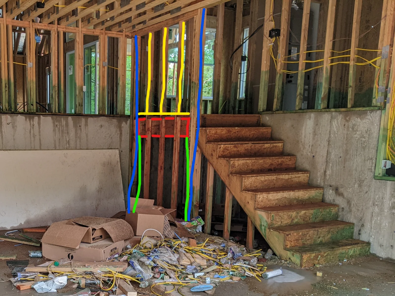

Jack it up and cut in a double LVL header that essentially is even with that platform and remove the studs underneath - except the jacks for the header obviously
that's the plan. I just wish they would have done that to start with. They could have put that joist (red) inside the wall instead of backing it, and saved both material and my trouble.
