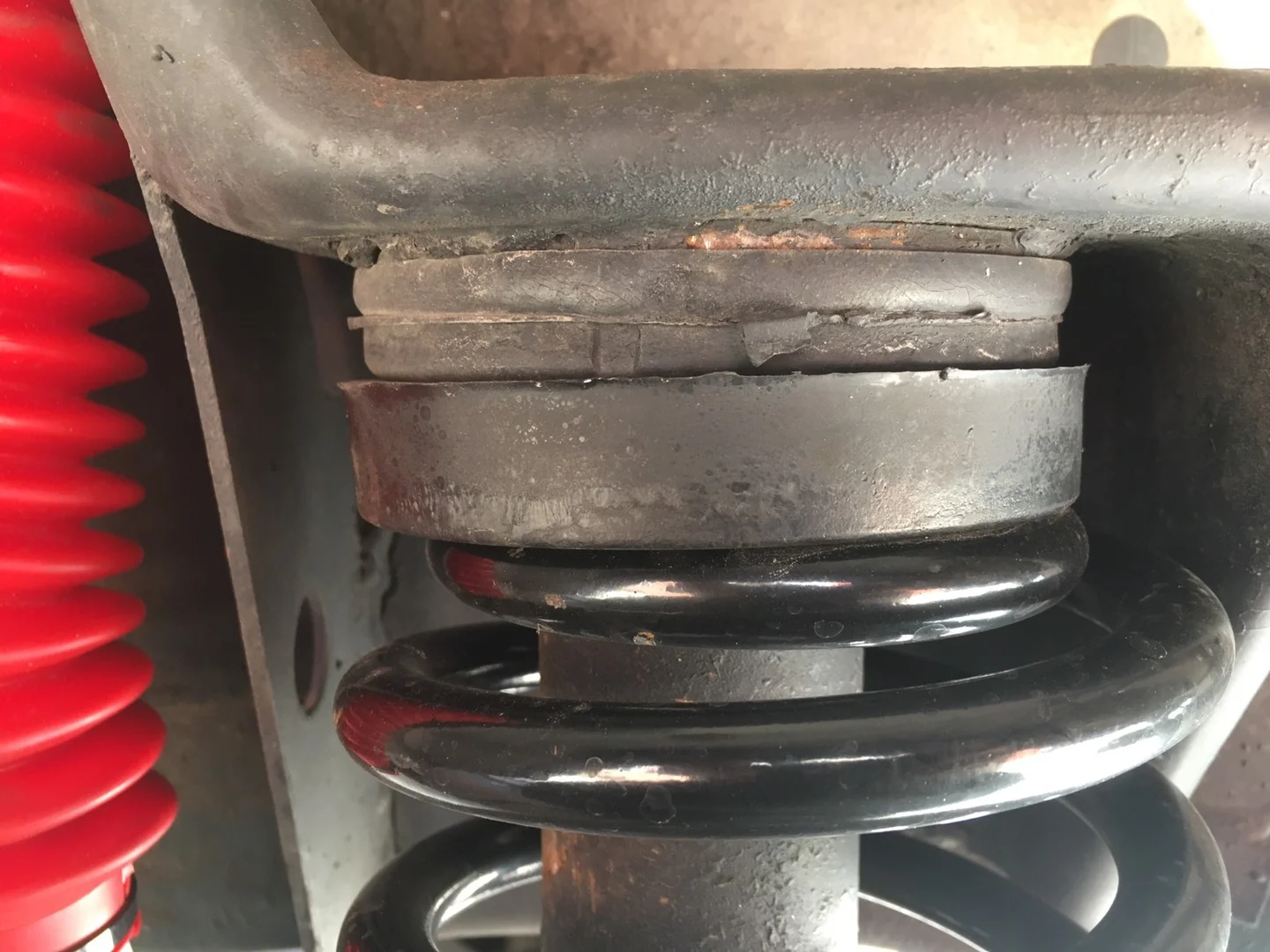

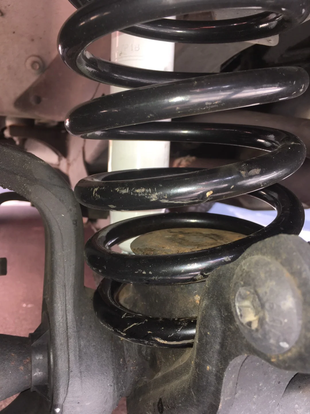

Sorry, just to make sure I'm measuring correctly (see pics below), should I be measuring from the top of the poly spacer in the first pic, to the metal plate in the second pic? Or should I be measuring to the bottom of the spring itself?

Sorry, just to make sure I'm measuring correctly (see pics below), should I be measuring from the top of the poly spacer in the first pic, to the metal plate in the second pic? Or should I be measuring to the bottom of the spring itself?View attachment 184751View attachment 184752
Top of the poly spacer to the bottom of the spring itself. The metal inside the coil is your bumpstop. If you take a pic of the whole spring and spacer, I can draw a couple lines for you, if needed.
