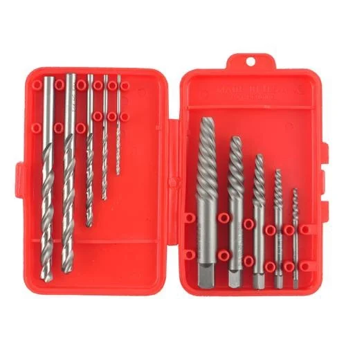

Has anyone tried EZ Outs/Extractors once stripped? They are basically bits that have reverse threading so as you unscrew them they bite into the screw/bolt. On the right below:
Since the bolt head is boogered, get some heat into the bolt (soldering iron, hot screwdriver,...) Then use a left hand drill bit. The stripped bolt will come right out.
Seriously, heat is the answer for these bolts. Chrysler put thread lock on them, like it or not.
