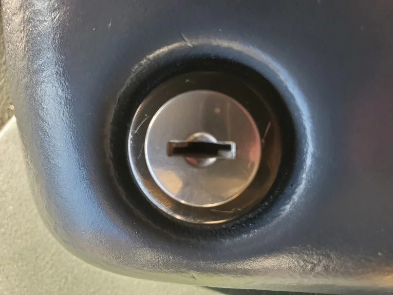

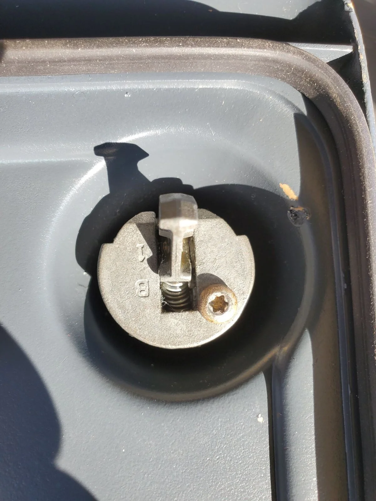

Can someone tell me how to remove my console lock.
I bought a used 1998 TJ console but didn't get a key for it.
The lock is unlocked and works, it has a small allen key screw at the bottom and is metal.
I am looking to get a new lock and key, but its very hard to find one.
See 2 photos

Actually the console lock only uses one tumbler so if you need to re key it wouldn't be too difficult
The rear console half I bought from a forum member worked with my key so I didn't have to change anything
You can also swap out the entire console lid (3 screws?) so you don't have to remove and replace the lock? This would only work if you have an existing console of course (not sure if you do).
