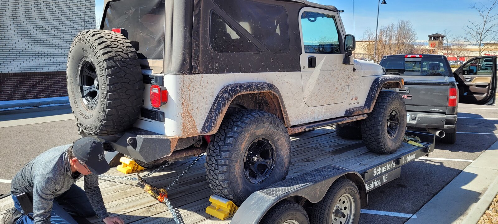

We hooked a chain around the rear pumpkin. Then used a rachet strap around the front pumpkin to pull it forward and tight. Since we were driving 12 hours, we screwed plastic wheel chocks to the trailer infront and behind the wheels. You can skip that step for shorter trips in town or on flat straight roads.
The Denali pickup we used had 550+ hp and over 900 ft-lbs of torque. With towing mode for engine breaking. We blew through the CO rockies at 70-80 mph and didn't notice the Jeep back there.

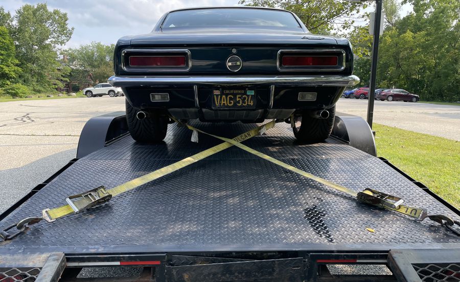

That was not sarcasm...deadly serious. Who put it in your head that cross strapping was bad?
years of truck driving/towing experience + physics + many prior threads on this forum + the internet.
Question, you lose one of those two straps, what now keeps the vehicle from moving forward? not the other strap... if anything the other strap will just pull the vehicle sideways as the vehicle moves forward, not a good idea.
Hell even bleeping jeep knows better...
