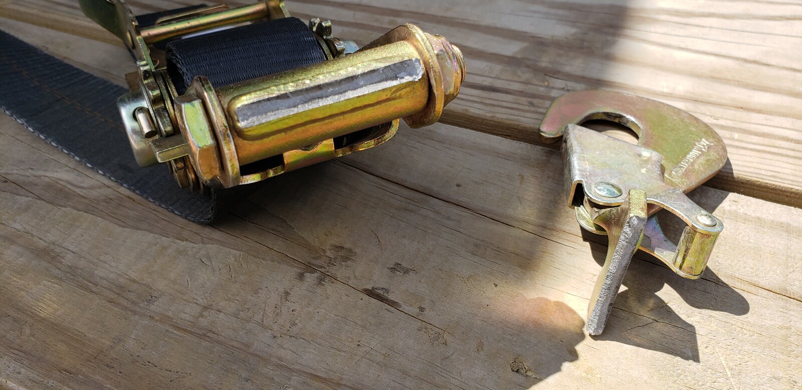

Seems like that would qualify as a "broken strap", no?
These are funny discussions due to the lack of basic thought that gets applied in a critical manner. If I told everyone that was going to tie down their rig to a trailer that all it takes to hold it in place is 4 pieces of steel about 3/16" thick by about 5/8" wide, they would in general tell me I was full of crap. Yet, most would not hesitate to use a twisted hook strap at all four corners to do what I just said would work.
I've never seen one of those break in that spot but it sure gives one pause to wonder just how much is really needed to keep a rig in place.

doesn't look like it was the steels fault to me. that 1 was born to fail.
those welds are not equal the left edge of that clasp end was broken off and it appears to have been welded well, the break is equal end to end. the right side is poo.....it had very little penetration on both ends it can be seen on the right side of the clasp end and the upper weld on the ratchet. it had just a bit of good weld in the center when that bit gave way it's not hard to bust that second weld over.
if thats american made i'd contact them, thats not a thing they want happening.

3rd use straight pull
Post in thread 'Trailer Tie Down Review, Mac’s Super Pack'
https://wranglertjforum.com/threads/trailer-tie-down-review-mac’s-super-pack.50576/post-877726
That makes no sense whatsoever. I believe the user but still, something bizarre is going on. The edge of the hook show it was basically ripped fully across the weld in the HAZ on both sides. For a straight pull to do that, something is whacked. Fortunately, we don't see that often, in fact, this is the only time I've ever seen anyone post up failed hardware. Just very strange.
Look a bit closer. I think the shadow is throwing you off a bit.
