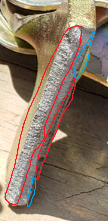

That makes no sense whatsoever. I believe the user but still, something bizarre is going on. The edge of the hook show it was basically ripped fully across the weld in the HAZ on both sides. For a straight pull to do that, something is whacked. Fortunately, we don't see that often, in fact, this is the only time I've ever seen anyone post up failed hardware. Just very strange.

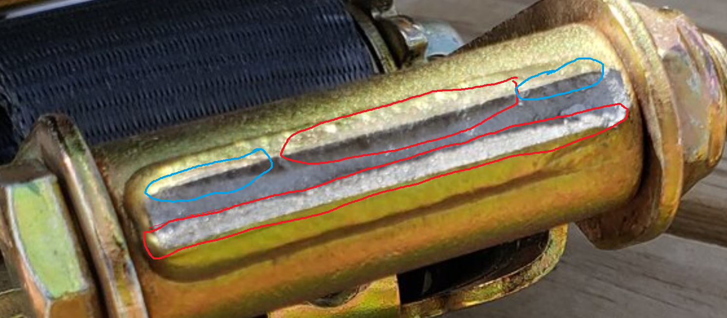

Look a bit closer. I think the shadow is throwing you off a bit.
this is my read.
blue areas had no bite no bridge material, little red gave way and big red had to hold the load and it was broken over by the line of force either binding around a corner like you described or the construction was not really inline and it broke at weakest point in the offset.
looks like a machine weld to me . they started well in front at the left edge but ended premature and without a filler pause.

this is my read.
Looks like the pieces weren’t butted together when welded.

this is my read.
That's a hell of a lot of weld to just break in a straight pull, got to be more to it. I have been using this type of ratchet for a very long time with a chain hook attached to a short chain with a D-ring to attach the ratchet.

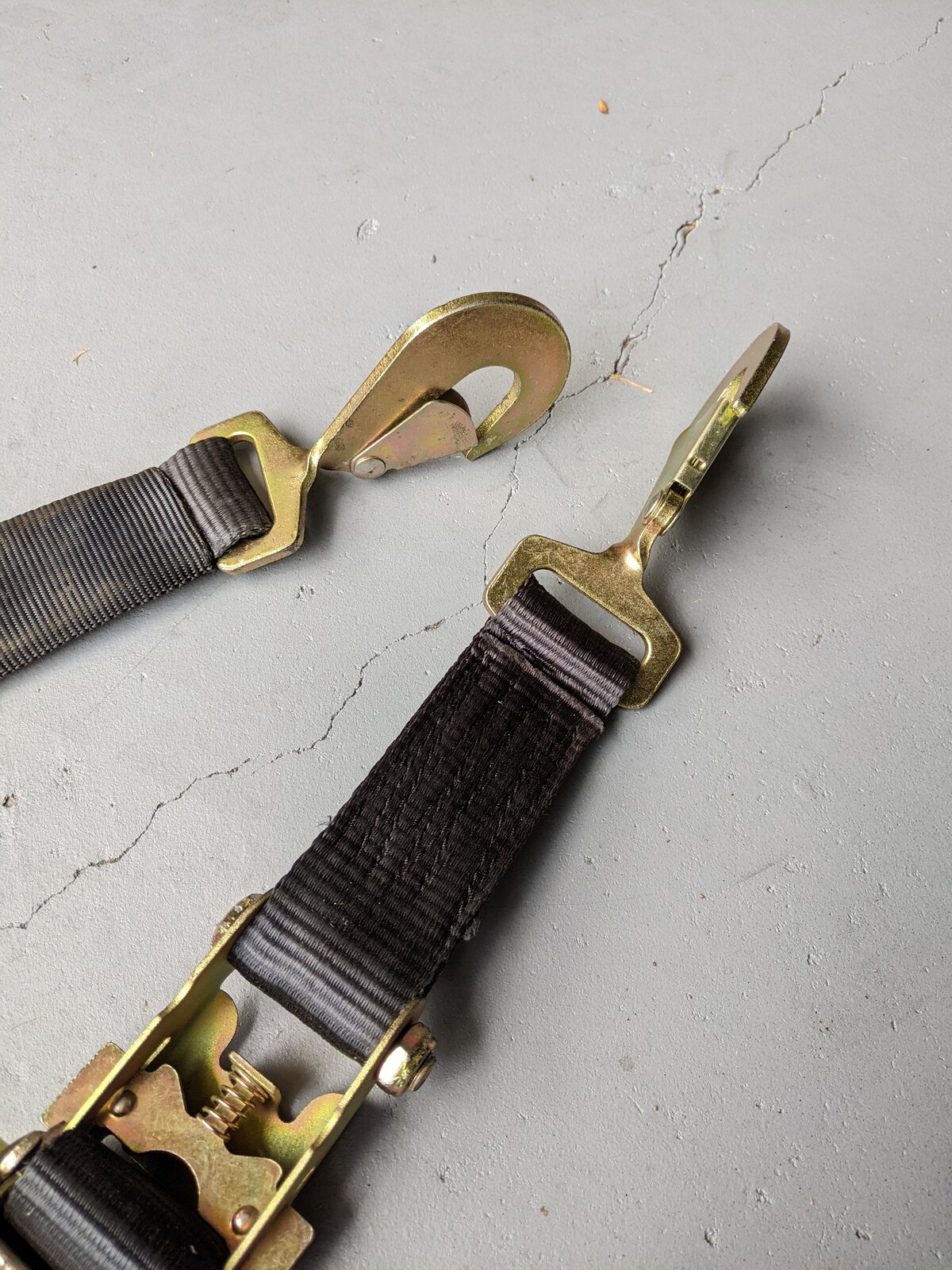

I’ve switched to this style of fixed end with the flat hook.

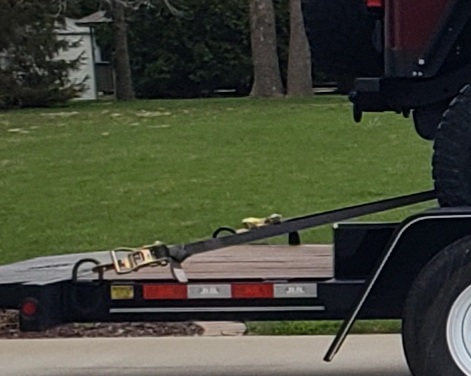

Here is a pic of how the strap was used. This is a more recent pic, but the set up is the same.
I always check the straps at every fuel stop. I had driven from Illinois to Utah with no problems. I stopped around Dewey Bridge and everything was fine, but when I got to Moab (about 40 min drive) it was broken.
I have been hauling vehicles for 20+ years, and have never seen anything like this happen before. This was a basically new Mac strap, but must have had some sort of defect.
That should have never failed in that configuration, I would have contacted Macs and got his take on it or at least made him aware of it. It is my understanding that he is a standup guy.
