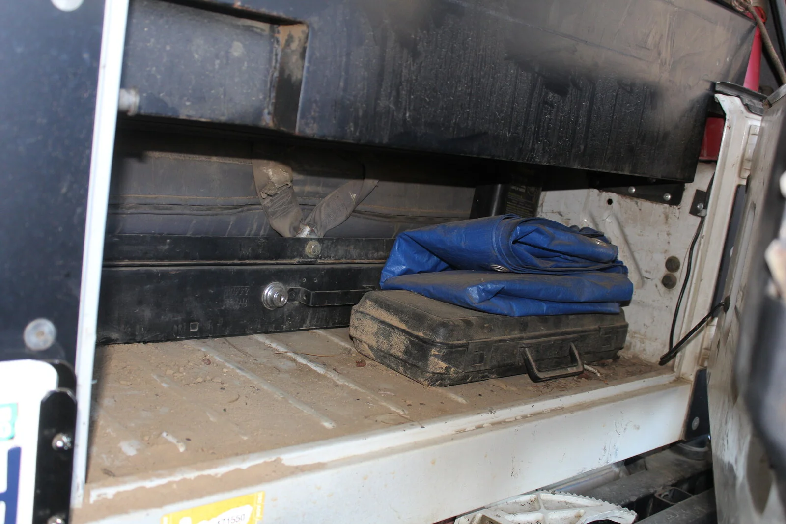

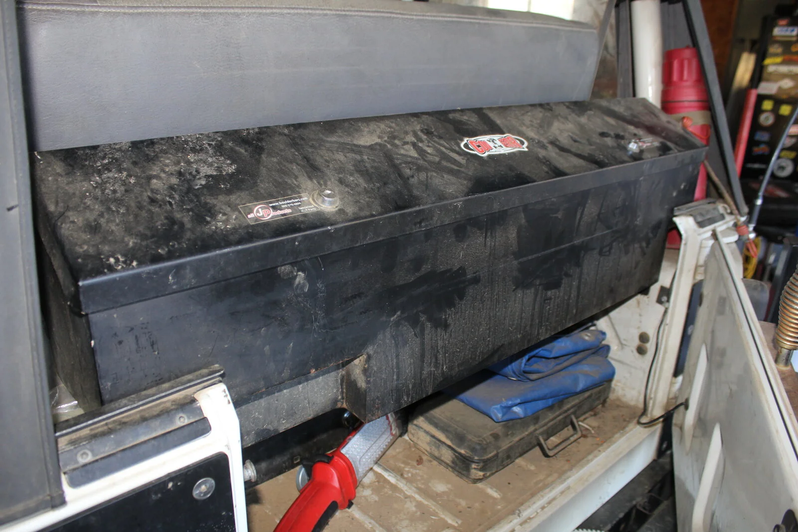

I've got a storage box in the rear for that sort of stuff. And then for stuff that doesn't fit in it I use straps to tie stuff down.
They don't make these anymore unfortunately.
With the box there and the seat up it contains stuff under it but I still strap stuff down.

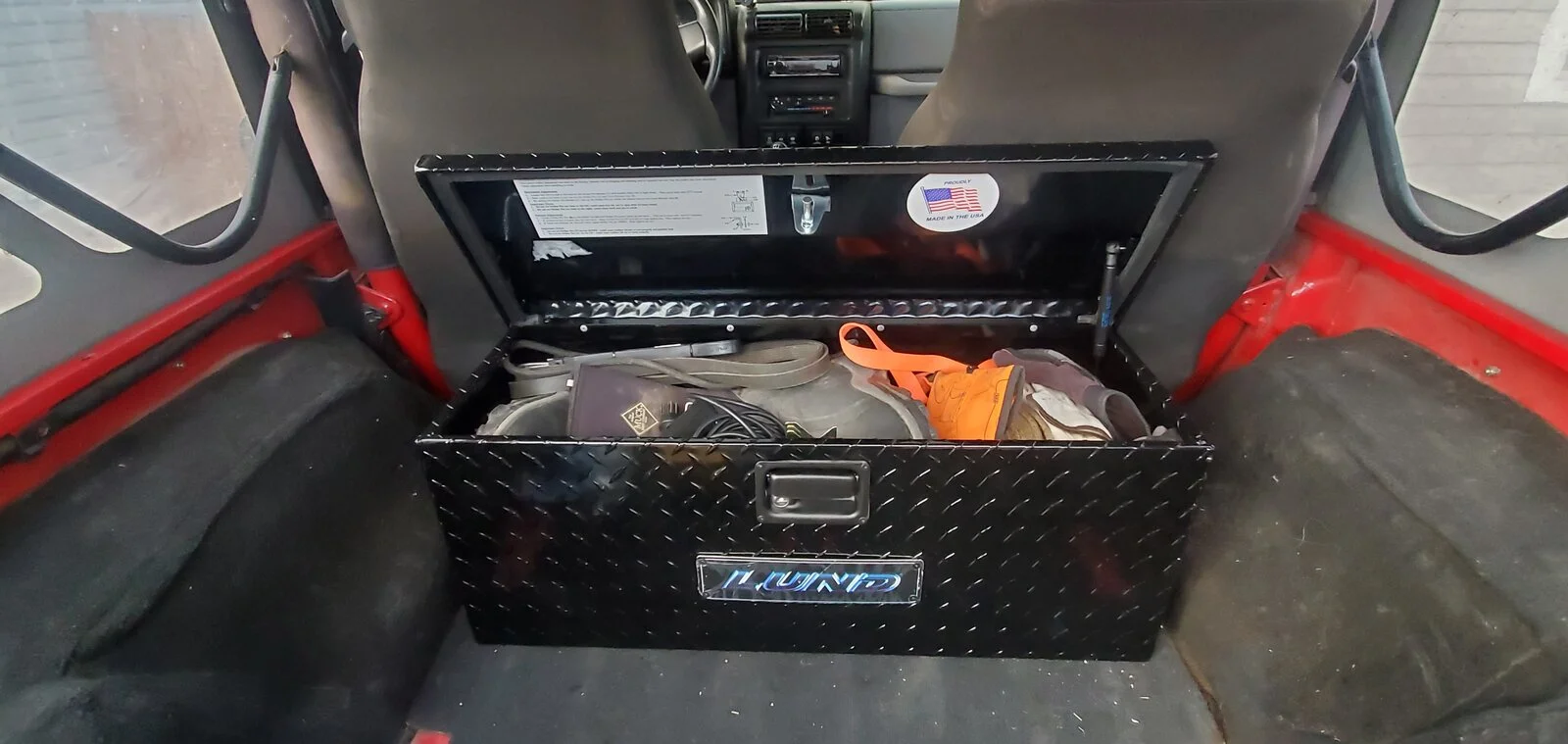

I am using an ATV box mounted to the floor with nutserts. I believe it was @MountaineerTom who had come up with the original idea. I havent had a rear seat in years, so the nutserts and rigid mounting made it easy for me. It contains all my recovery gear in the wheeling season. Winter gear and some other things in the winter.

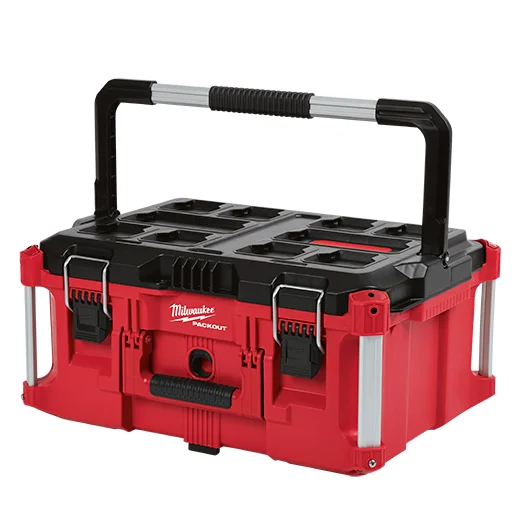

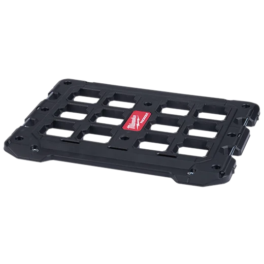

I copied @strumble8 and added nutserts to mount a Milwaukee Packout base and use their large tool box (and the packout socket set). The nice part is if the tailgate is locked you can't get the tool box off the base - so it adds a nice security.
View attachment 243733View attachment 243734
I think that would work for me, plus it's in the right color. Very nice solution. I like that it's nutserted down and not coming out if teh tailgate is locked because I don't like moving my tools in and out of the Jeep.
I'd love something like that if they still built them!

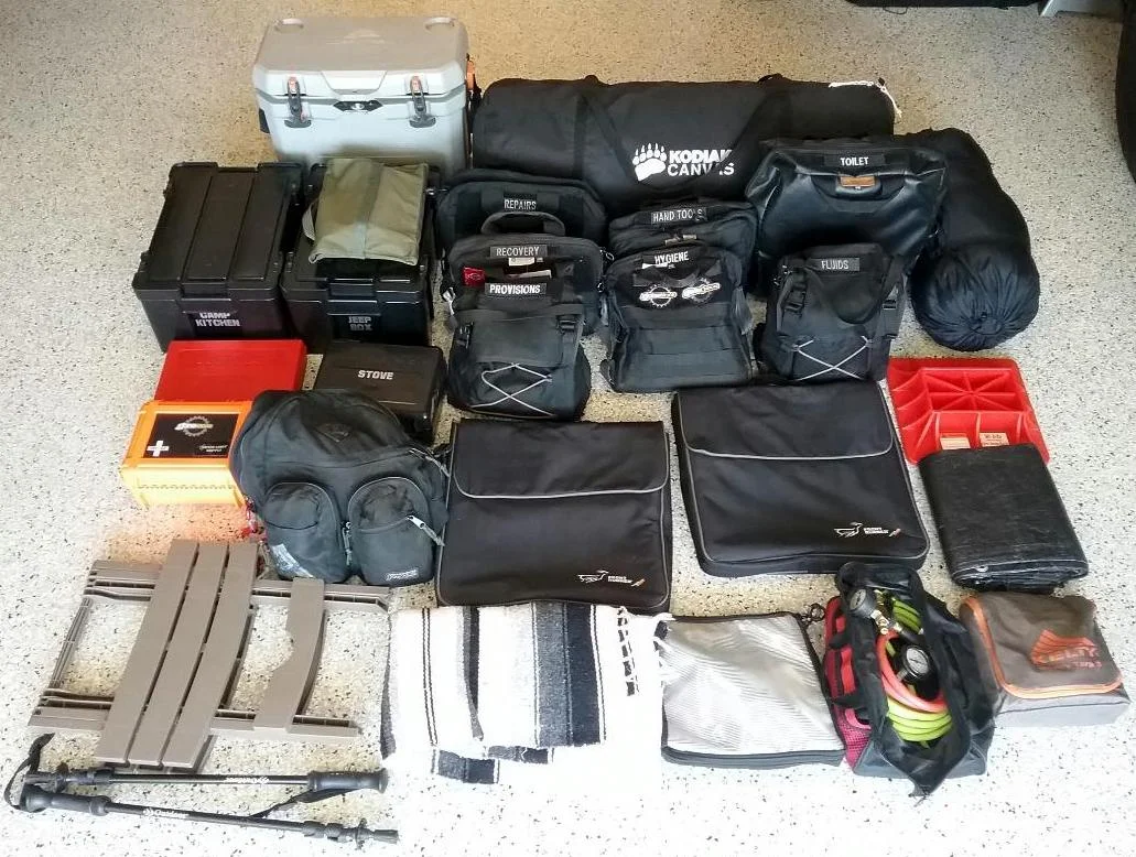

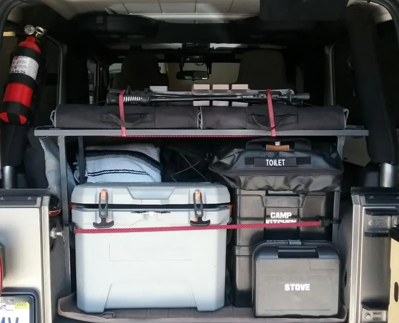

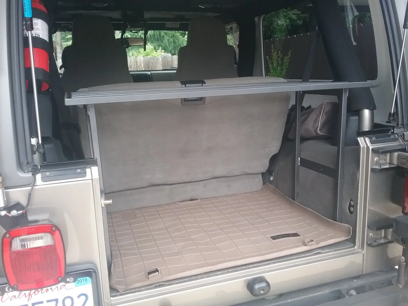

I use a behind-the-rear-seat interior cargo rack. Anything underneath that shifts won't go far, anything above is strapped down.
Organized as always, and well done, especially like that "TOILET" is labeled so prominently. When ya gotta go, ya gotta go, keep that on top for easy access. 😉
I gotta have my backseat for all my companions, though with the TJ fleet we're building, I may be able to ditch my seat and throw them another set of keys. Good ideas for the future. Thanks. Your rack works good for holding straps and such.
Clean and the ATV box fits just about perfect between the wheel wells. Nice. For now I have to have my rear seat, but maybe something like this in the future.

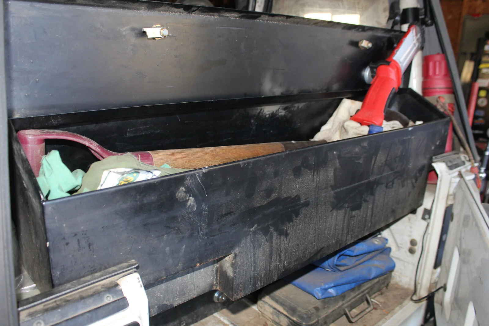

It was actually a box that Con-Fer made for the YJ and when they went out of business All J bought them all up and modified them to fit in a TJ. I got it as a Christmas present back in 2004. Was loads of fun trying to open the box when I was on no weight bearing on my right leg.
There are a lot of things I'd REALLY like to see some one start making some of the stuff no longer available for the TJ/LJ.
