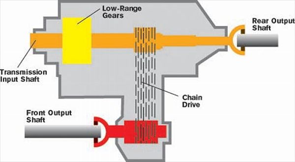

No matter how simple or complex your transfer case is, this is what it does: It splits the engine torque coming from the transmission and delivers it to output shafts that connect to driveshafts leading to the front and rear axles. Most transfer cases designed for off-road use are able to mechanically lock the front and rear driveshafts together, so each end of the vehicle gets an equal amount of engine torque.
Depending on the age and design of your transfer case, torque is delivered to the front output shaft either through a set of gears or via a chain. Most present-day T-cases are chain-driven, as the chains have proven to be lighter and quieter than gears. Hard-core ’wheelers tend to prefer the old-school gear-driven cases, however, because they can withstand greater amounts of torque without breaking. And gears will never stretch like a chain might when it’s under extreme stress.
This schematic illustration shows the basics of transfer case operation. Power from the transmission runs into the case and is split to output shafts that are connected to front and rear driveshafts. This particular example is a chain-driven case, which is commonly found on most 4x4s made since the 1980s. It has a planetary gearset that reduces the transmission’s gear ratios when the case is shifted into 4-Lo.
